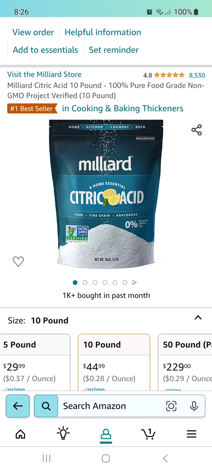

    Just bought this 10lb bag for my neighbor. Showed up same day, food grade or not doesnt matter. I just look for a cheap price. Ive used this stuff w great success many times. Screenshot_20230814_202639_Amazon Shopping.jpg

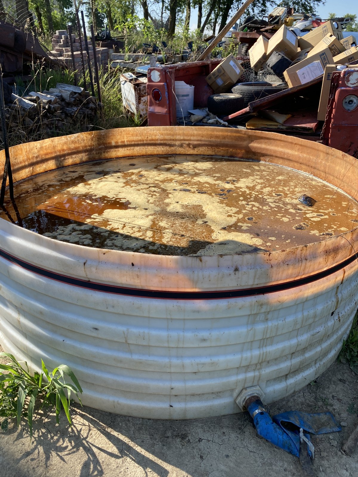

    My brother and I tried citric acid dipping this summer. We tried mol***es dipping last summer and had great results.
    We have a 400 gallon plastic farm tank, about 6 feet round. We used 50 pounds of citric acid, purchased from Amazon. We dunked a bunch of rusty sheetmetal in it, leaving for three weeks. Snagged the parts out, washed off with a pressure washer, and amazingly they were perfectly clean. About what we experienced last year with mol***es, but without the stink and staining.
    So, we dunked another batch of parts in the same tank and left them for another three weeks. Pulled and cleaned them with the same method, and they were just as clean.
    Tried batch of parts number three, leaving for the same three weeks in the hot summer sun, and upon pulling them out, there was hardly any rust removed. We've determined the citric acid has lost it's appe***e after the first two batches. We will buy another 50 pounds and continue with a fresh batch for the rest of the summer.
    Next year might be different though. The mol***es purchase was around $300 and it lasted all summer. We only dumped it in the fall cause we didn't want it to freeze in the winter and crack our tank (we live in Iowa). The citric acid cost about half, but only lasts half as long. Will still need to drain in the fall.

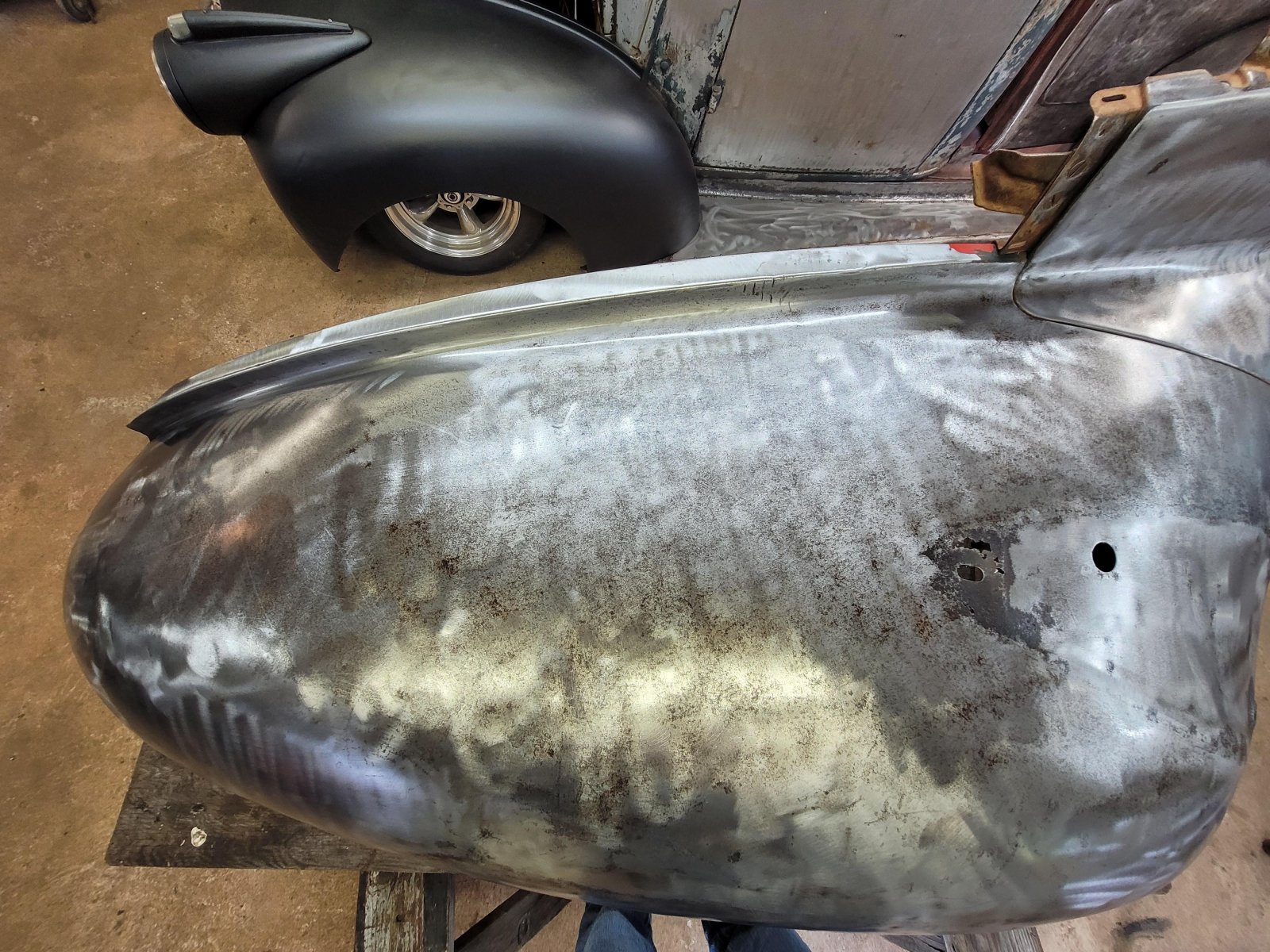

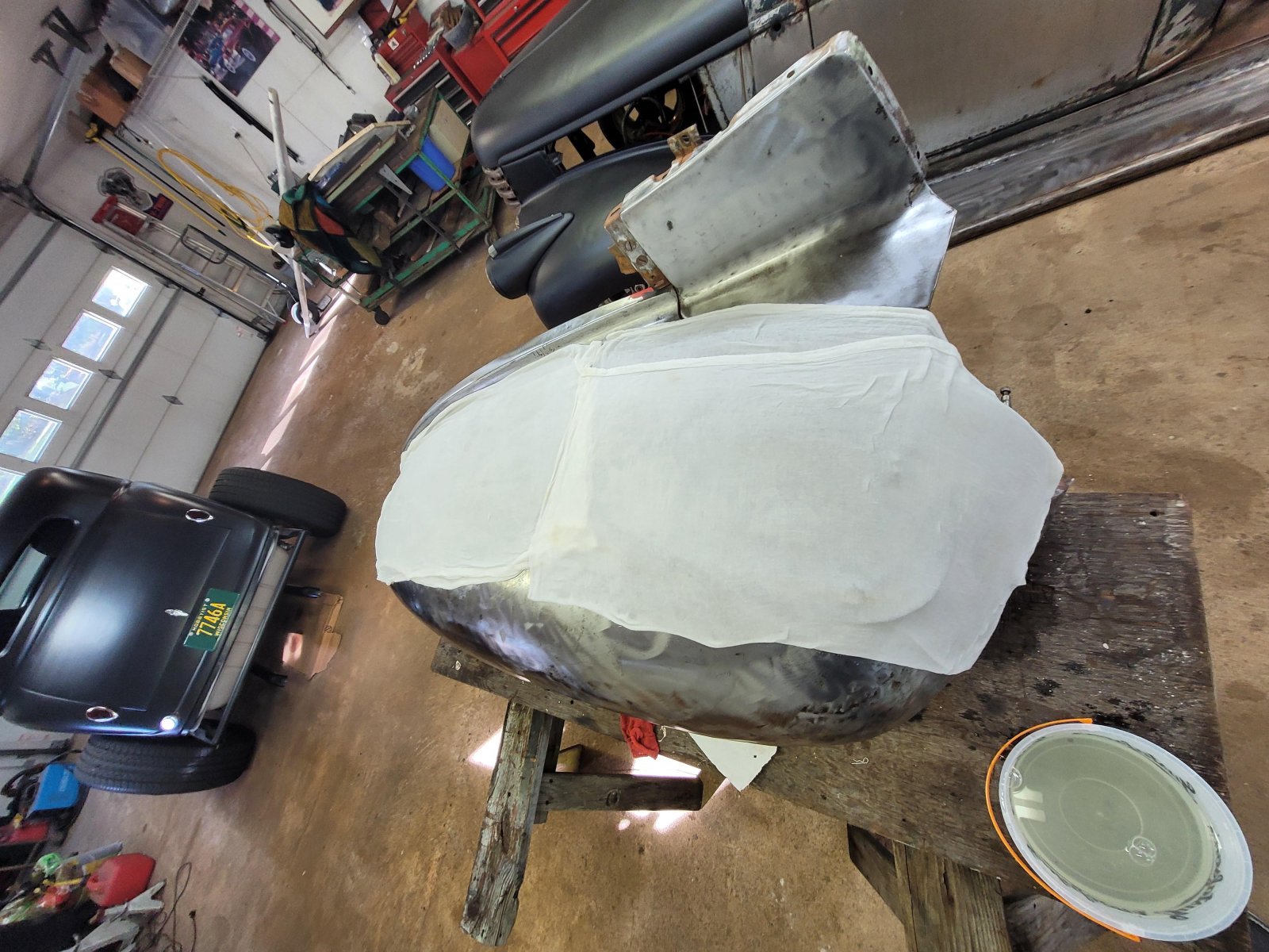

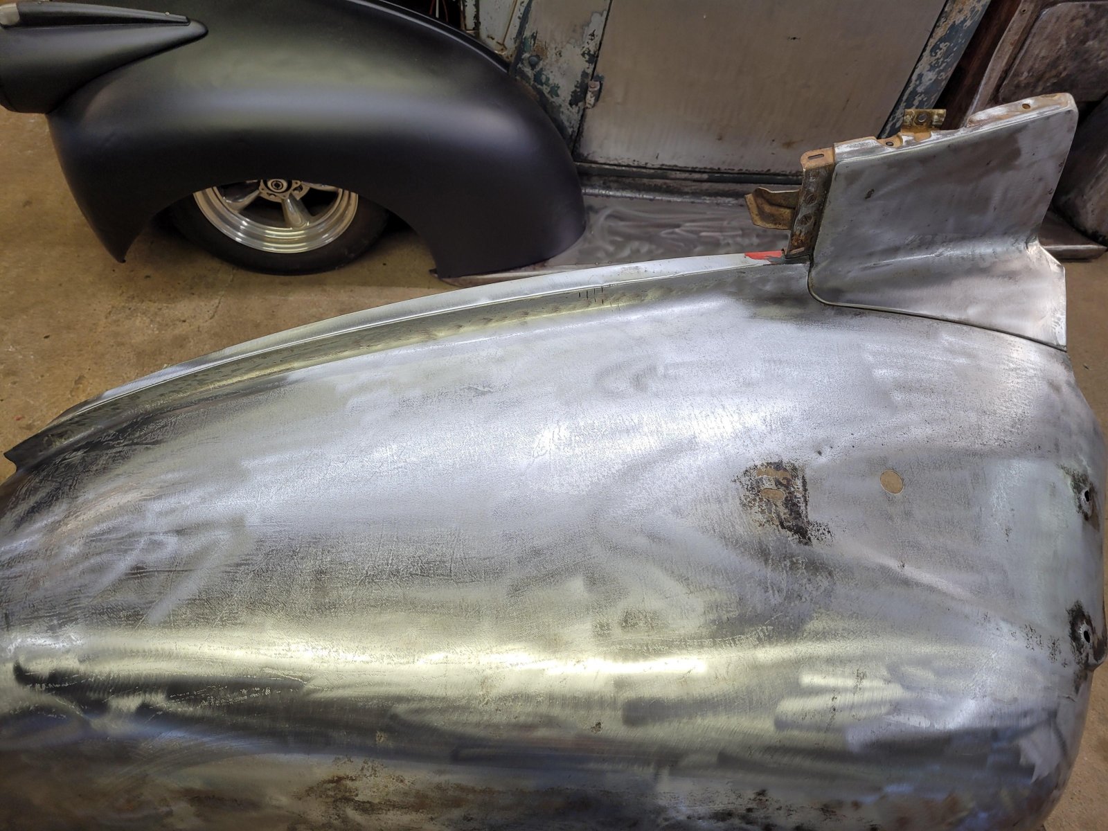

    I have used it on Panels to pull out rust from pockets that a grinder will not get at. I used thin dish towels to avoid the etching and stacked heavier towels on top to hold citric moisture. Keep the towels wet for a few days.
