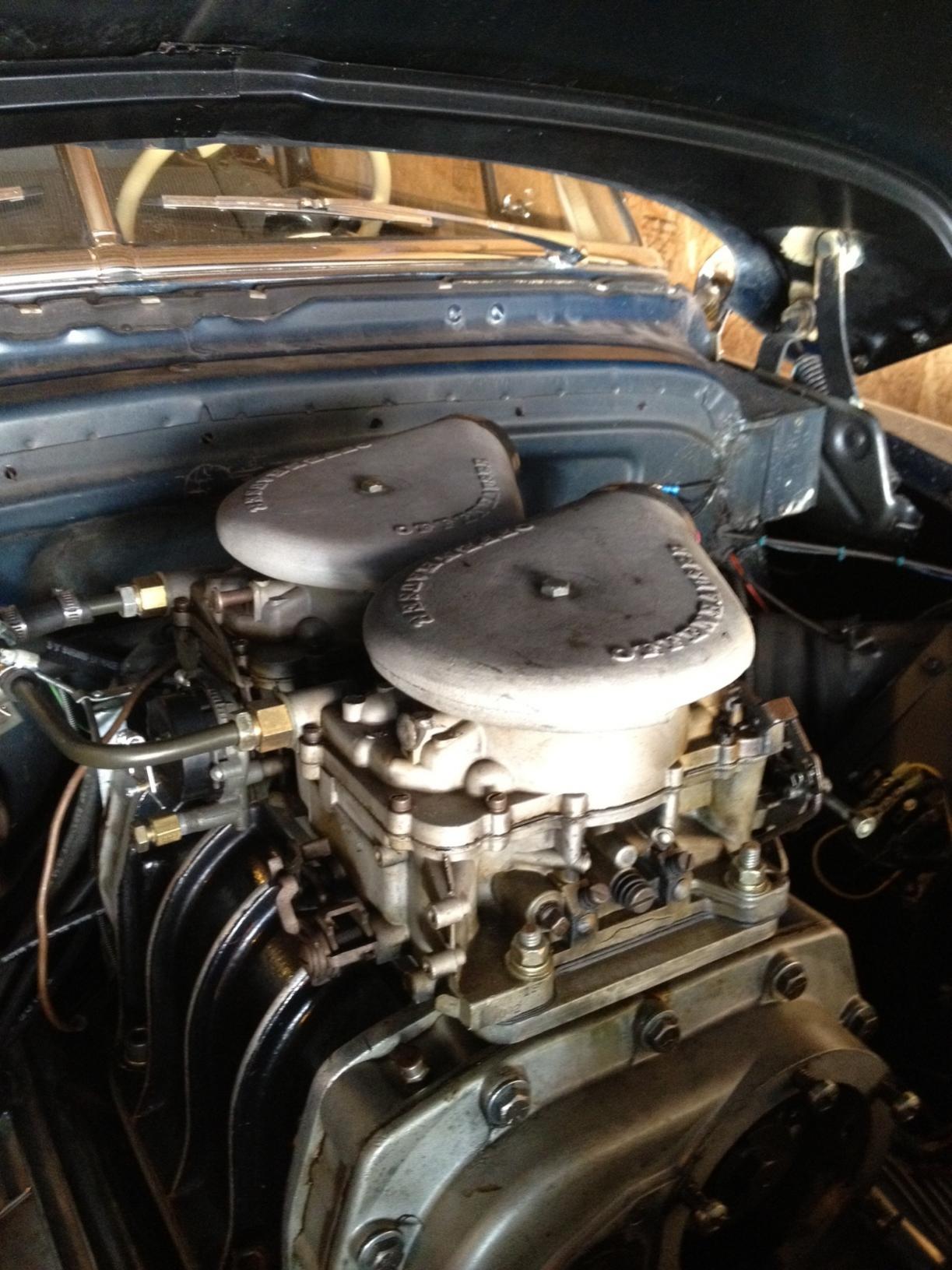

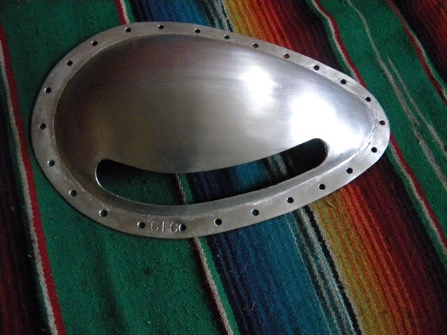

    Would something like this work? Perhaps a combination of these cut-n-stuck together?

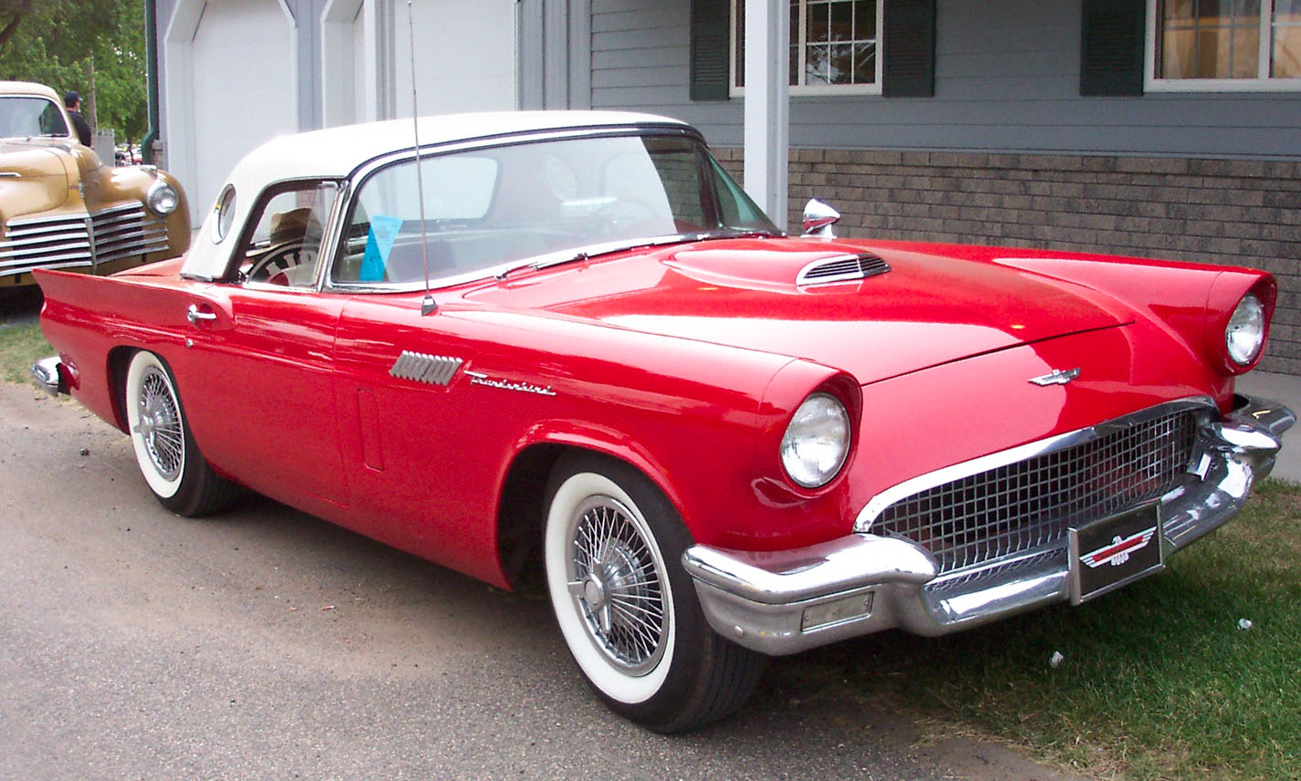

    I could swear I just saw that whole mess yesterday with a chrome firewall behind it. Ya, put me down for the blister, or you could twist my arm, and I'll agree to a backward T-bird scoop.
  4. our 57 bird has this stock scoop extended 5 inches forward never really looked until parked side by side with a stocker ....

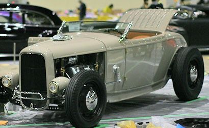

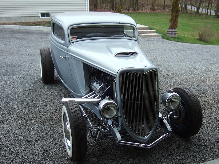

    Ok, so no one found the fibergl*** snorkle scoop idea even remotely funny? Can't win them all. In all seriousness, knowing the shape of a '38 hood, I can't wrap my head around the mid fifties T-Bird scoop looking like it grew there. I like Extreemliners scoop and I think it works because it runs the length of the hood. That might just be key in this deal to avoid looking like wart. I also can't help but keep coming back to the hood scoop on 50Fraud's "T". It kinda mimics the shape of the front of the hood.

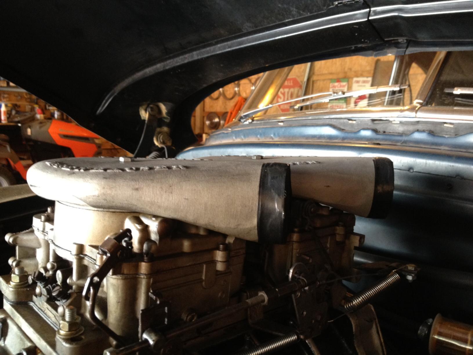

    I think something really awesome could come out of this. I sketched down a few ideas, I will try and refine them later. I like the idea of a "t-bird style" scoop if done right, to help complement the lines, with out being over powering. I also think a simple, subtle blister would work. And then I got to thinking.....
    A quick photo-chop:
    I think I am along the same lines as BOP-Nut, or maybe not...

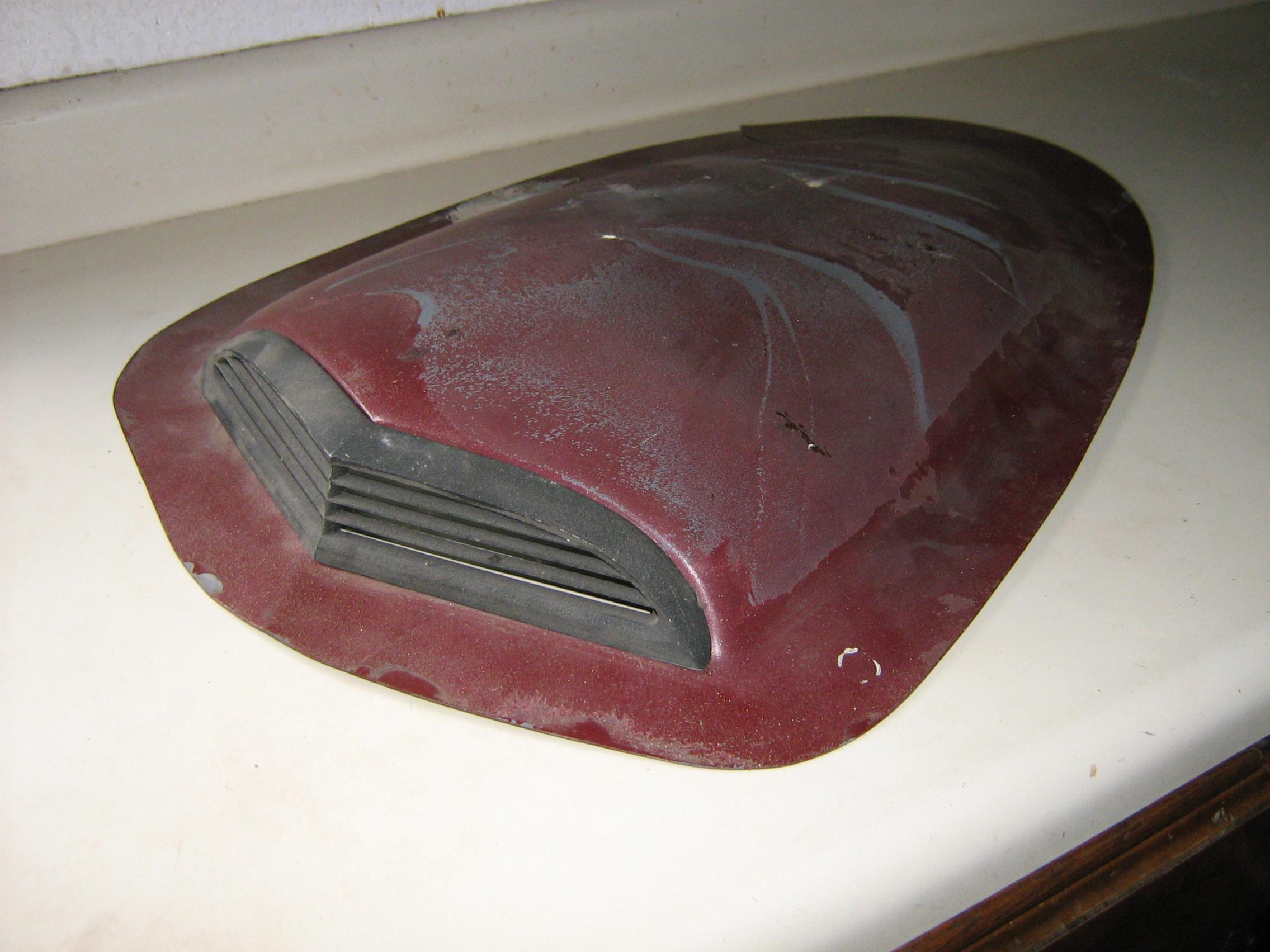

    The T-Bird scoop will be hard to come by. I cut one off a real T-Bird back in the 70's and had it on a daily driver '55 Chevy for about ten years.. Later removed it and made a mold of it to pull impressions. The problem with the the original steel T-Bird scoop is the end at the rear edge of the hood it does not make enough of a radius and you will have to fabricate that area. Check out pix. Another scoop I like is this early 70's Trans Am Shaker Hood scoop...good for tall tunnel rams. Almost mounted it on my '56 DelRay, but changed my mind because it's too hard to find an original '56 hood in perfect condition.

    The scoop/blister will have to mimic the grill/windshield opening like the T-Bird does to a 'T" (!). The other offering's so far fit their theme's: race car/near by sheet metal shapes/ect. Your coupe will be difficult to pull off. Why, because prior attempt's failed over the last 60 years. Without the hood it will scream Hot Rod. A blended blister on a stubby/voluptuous coupe will be tough.

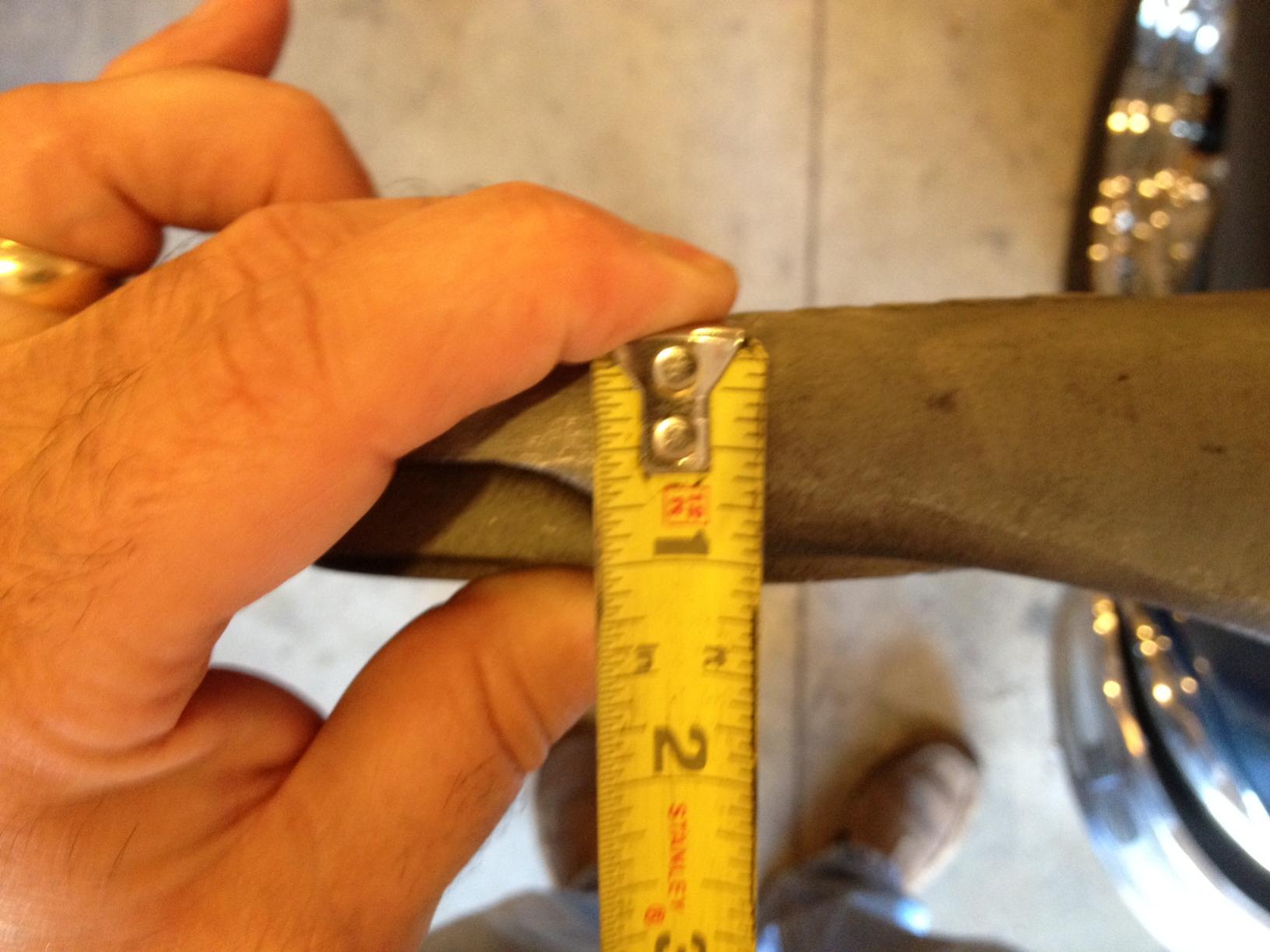

    Actually, I think we need more info here.Why 2" more hood clearence? Is it so the carb/s clear? Is it for air cleaner space? If he needs more air cleaner space a custom plenum box with remote air cleaner might work. Been there. Done it.

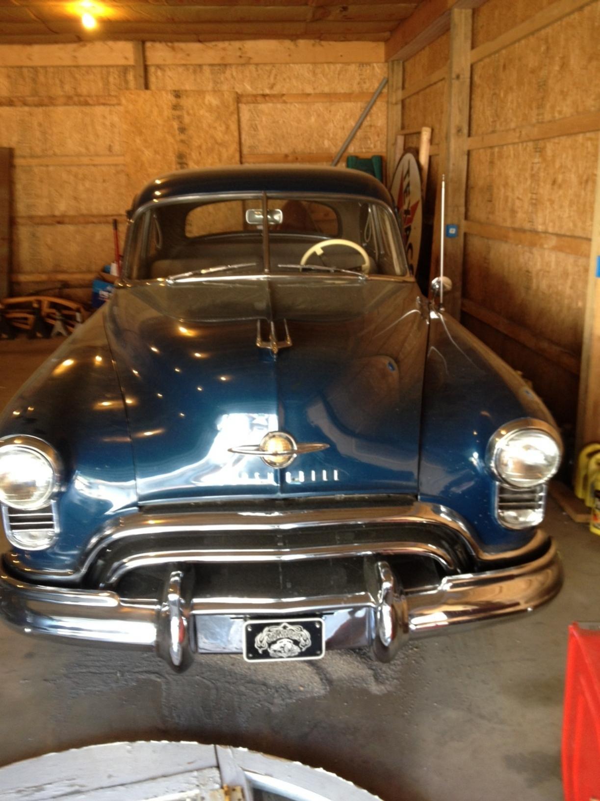

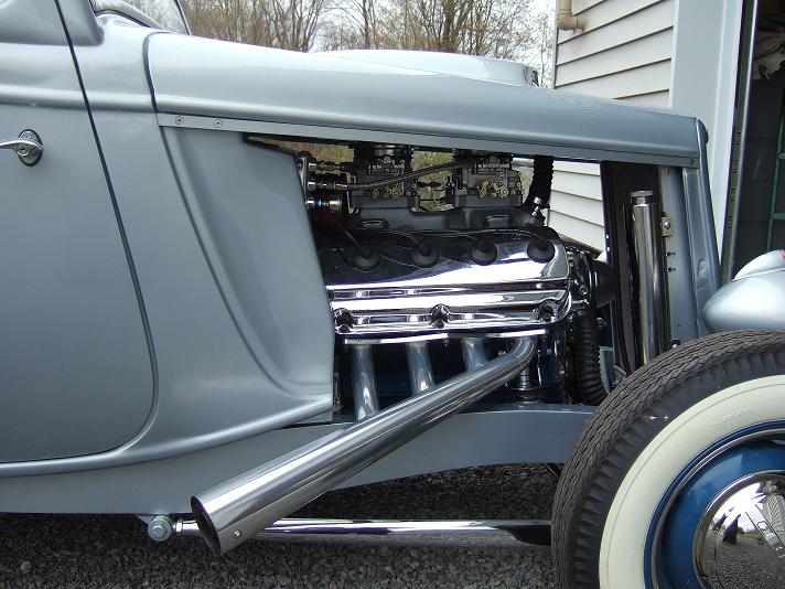

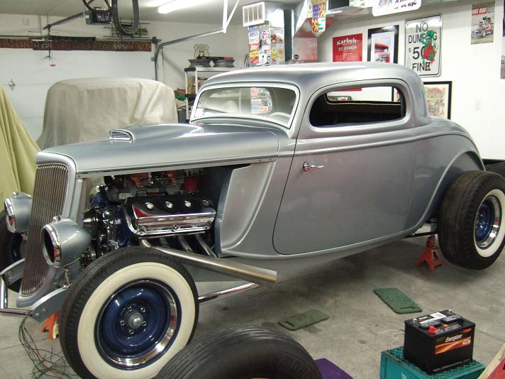

    Different animal.. but Clarence ain't no dope.
