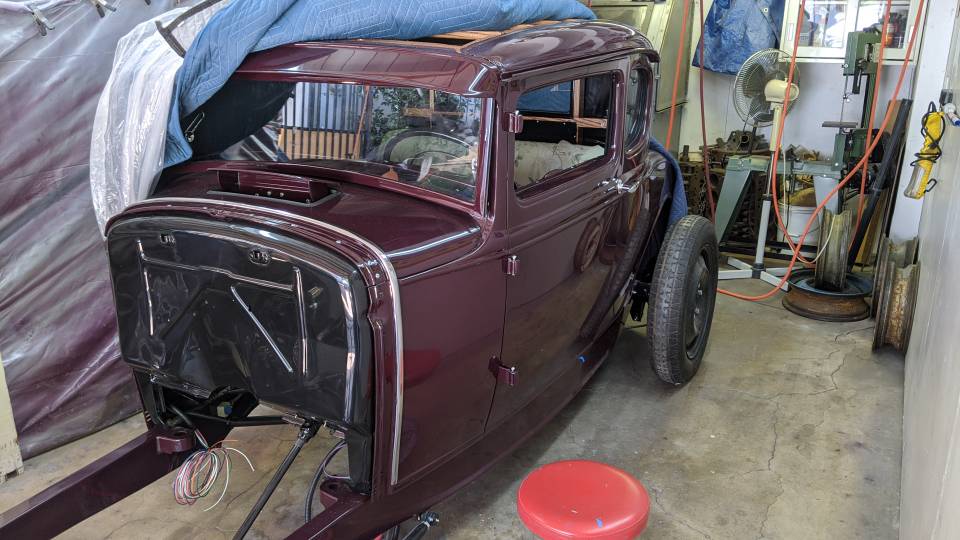

    Seat installed along with roll up rear window and rear quarter gl***.
    Finished restoring the 48 Ford steering wheel and added a modified Olds horn ****on. Got it installed along with the steering column, turn signal switch, and tach.

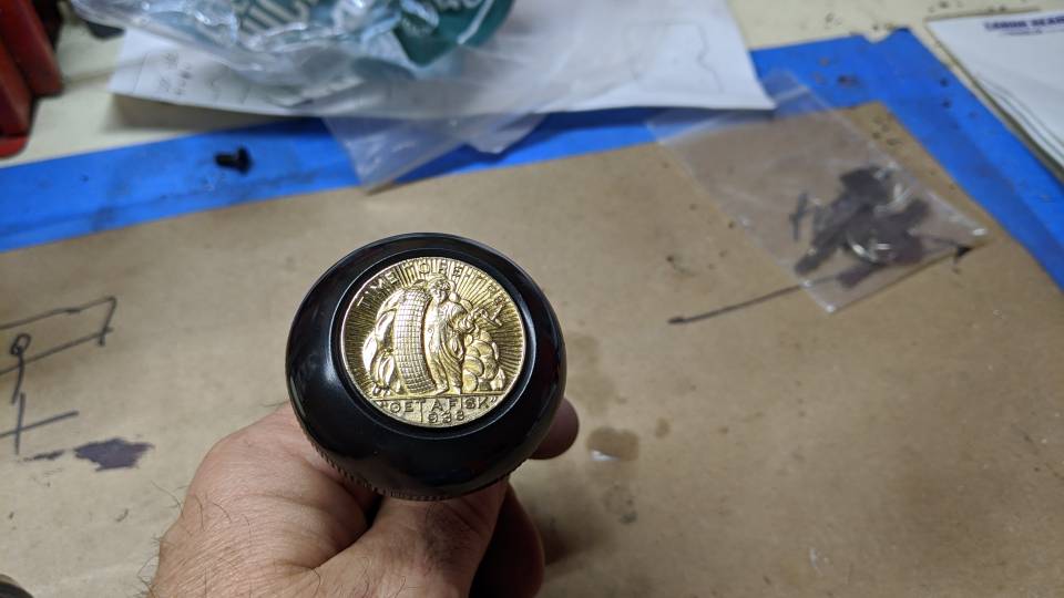

    I wanted a one off shift knob and took a try at making one. Started with a F1 shift knob and turned a recess in the top and glued in a 1938 Fisk Tire token. (I collect Fisk Tire stuff as it's my last name).

    Knob looks "store bought" good work :)

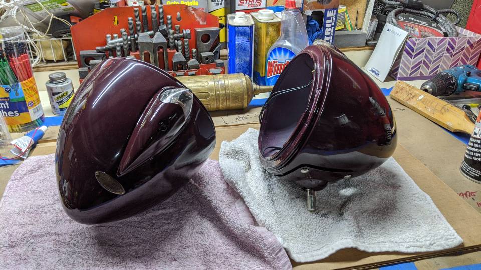

    Got the headlights converted to run 1157 short bulbs and painted.
    The wheels are blasted and freshly painted.

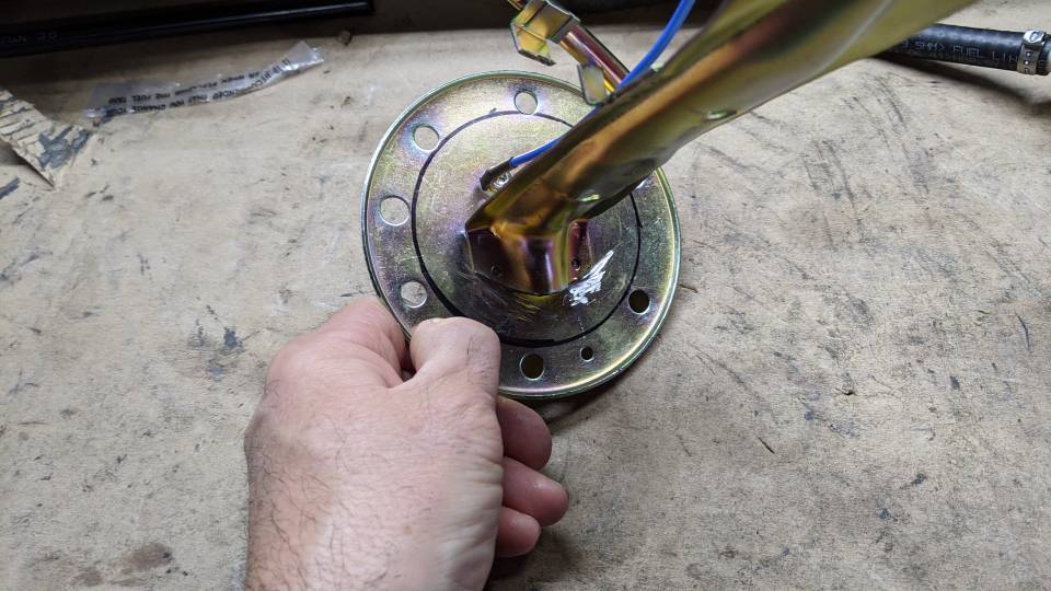

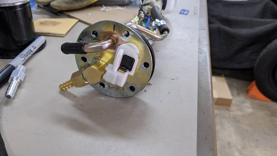

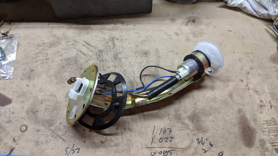

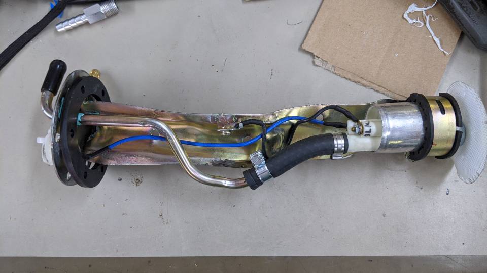

    Just found this build, great work, a lot to take in and use, including that in tank electric fuel pump. I spent ages trying to find something that would work with carbs, but there just didnt seem to be any info out there, so I purchased an external carter, but now, I think I may go this route. Do you need a pressure regulator to run carbs with this setup, and what filter did you use? Thanks
    Stogy and loudbang like this.
  12. etboy97
    Joined: Nov 3, 2007
    Posts: 219
    etboy97
    This is a low pressure fuel pump. Only 4psi Max so no regulator should be needed. I have still not run this setup. 51box has been using this pump with multiple carbs with good results. I have a Wix screw on fuel filter mounted on the inside of the frame rail.

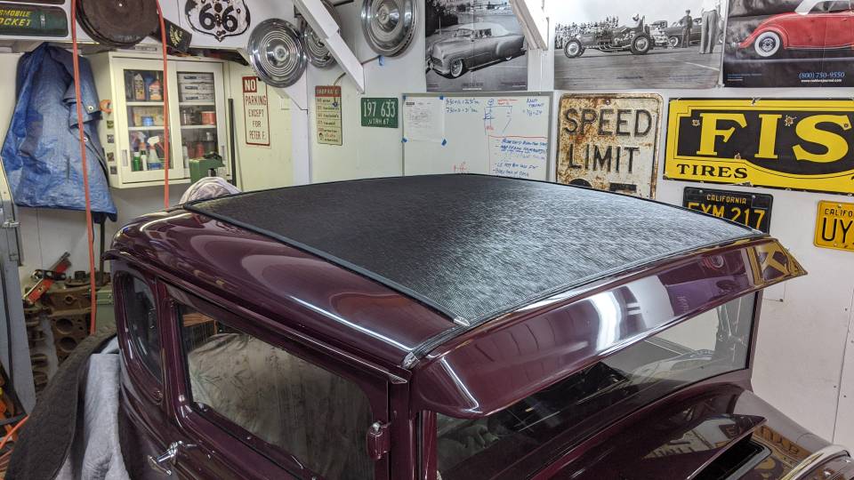

    Nicely done! Top came out beautifully.

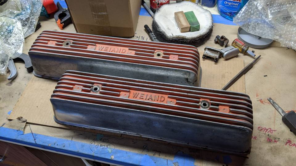

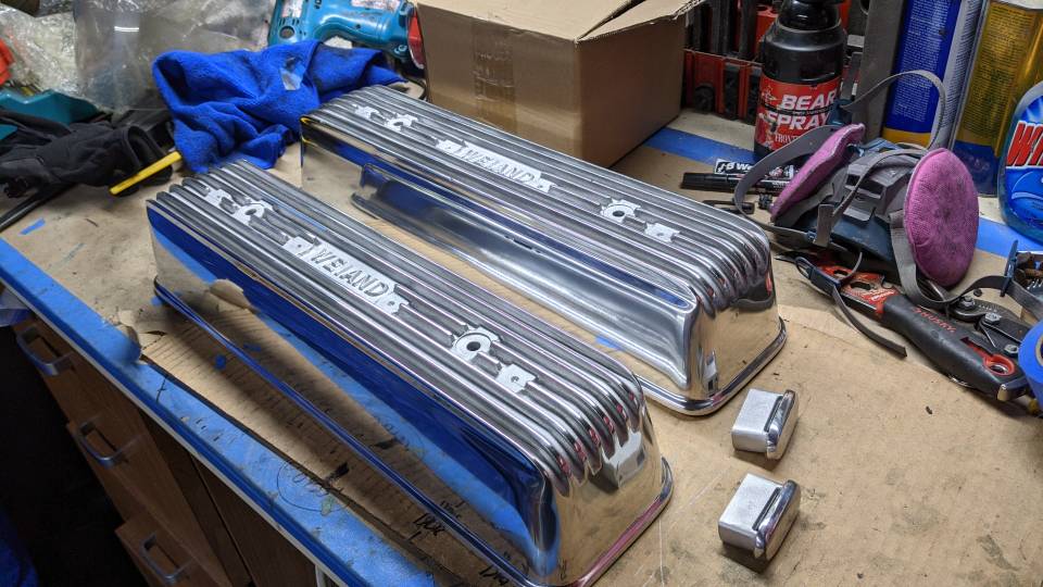

    Took a stab at polishing my vintage Weiand valve covers.
    They had a lot of nicks and scratches. I started with 180 grit and worked my way up to 800 grit them polished them with my converted bench grinder. They are not perfect and some nicks are just too deep to get out but I am happy with the way they turned out.
    I was thinking that I would paint between the fins but am not sure if I want to do it as I like how they look now. The area between the fins is gl*** beaded.

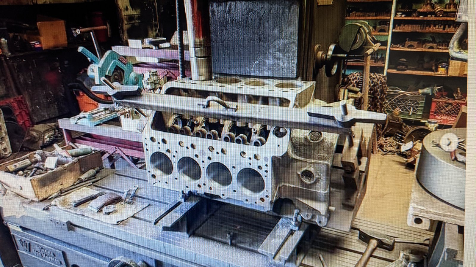

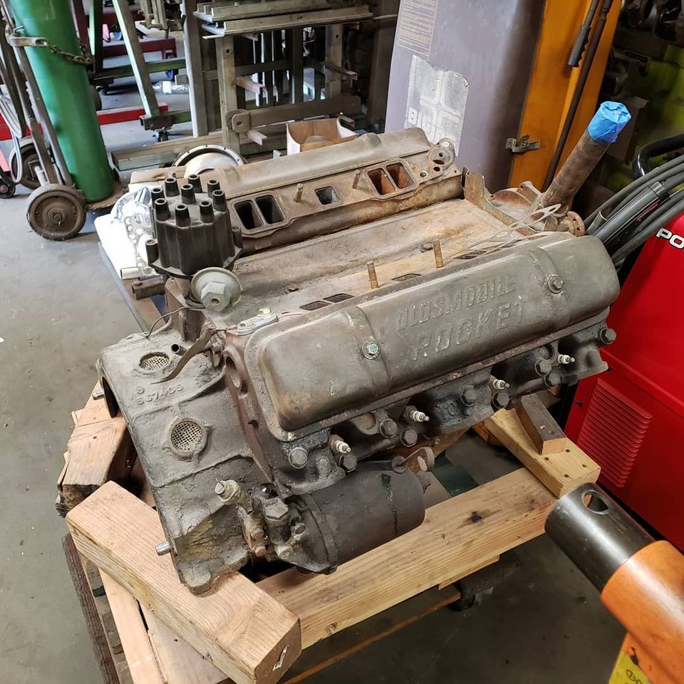

    Its been a long time since I posted an update. The project has been waiting for the engine to get done. Lesson learned is that if I want a popular engine guy to do my engine then I need to get in line way earlier. Good news is that the engine has been started. The block has been bored 40 over. The heads have new guides, exhaust seats, and 1.94/1.6 stainless valves. PXL_20210709_015205688.jpg PXL_20210709_015251326.jpg

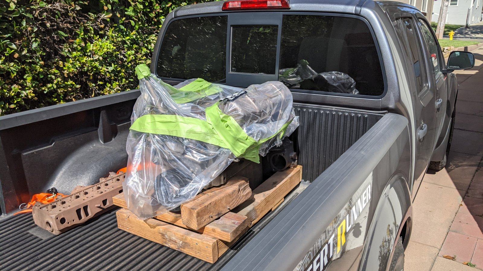

    Drove up to central California on Friday and picked up my engine from Tim at Hanford Auto. I am looking forward to going back to work on this project.
  28. vtwhead
    Joined: Oct 20, 2008
    Posts: 5,362
    vtwhead
    so what did Jim do to the engine? Can you share some specs on the rebuild?
  29. etboy97
    Joined: Nov 3, 2007
    Posts: 219
    etboy97
    The motor was bored 40 over (it was previously 30 over). The heads have new guides, hardened exhaust seats, and 1.94/1.6 stainless valves. Cam was reground with a 270 duration profile. Rocker arm ***emblies were rebuilt plus the other usual new parts.

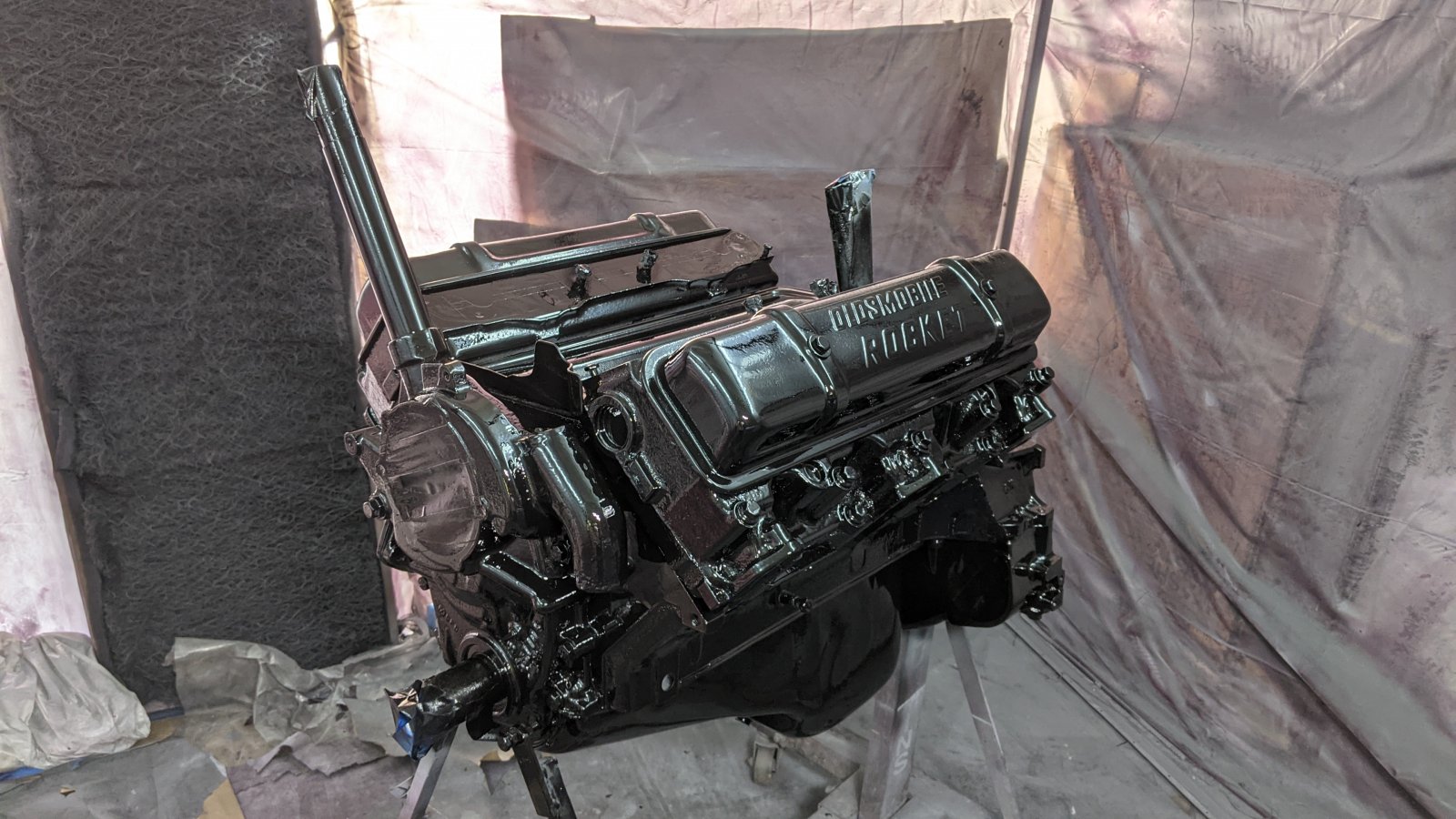

    Just finished painting the motor.
    The water pump got sent out last week to be rebuilt. I have the distributor torn apart and the bushings look real good so will clean it up, paint it and get it back together. The vacuum advance leaked but I was able to find a NOS one on ebay that works fine.
