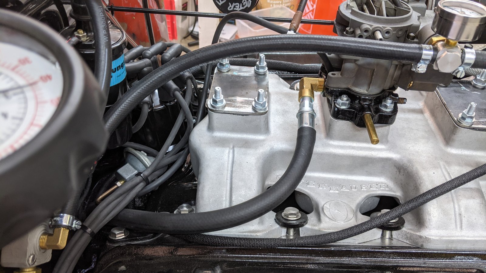

    Are you running a road draft tube ?
    loudbang and Stogy like this.
  9. etboy97
    Joined: Nov 3, 2007
    Posts: 219
    etboy97
    No my motor did not have one. It's a 56 324 so not sure what year they stopped using them. On my motor where the road draft tube was mounted on earlier motors my motor has a plate with a 1/2" hose barb connection point. I ran a hose from this to a early 60's Chevy PCV valve attached to the back of the carb with a br*** 90. PXL_20211014_192444540.jpg

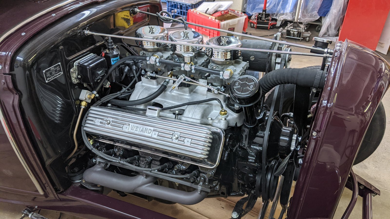

    Got the other carbs mounted up along with the Weiand valve covers.

    What headers are those? Thanx, n.c.
  16. etboy97
    Joined: Nov 3, 2007
    Posts: 219
    etboy97
    I made them from purchased flanges and mandrel bends.

    Nice fit. I was hopping those were off the shelf units. But a close look , I can there’re not.

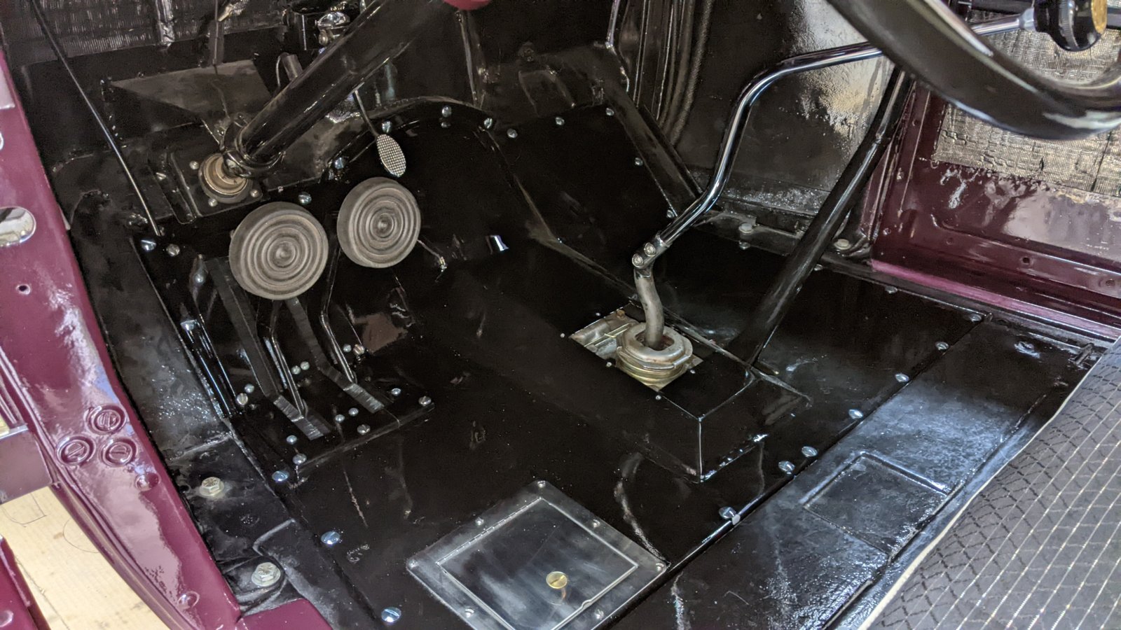

    Floor is in. When I do the interior some day I plan on having a rubber mat type flooring.

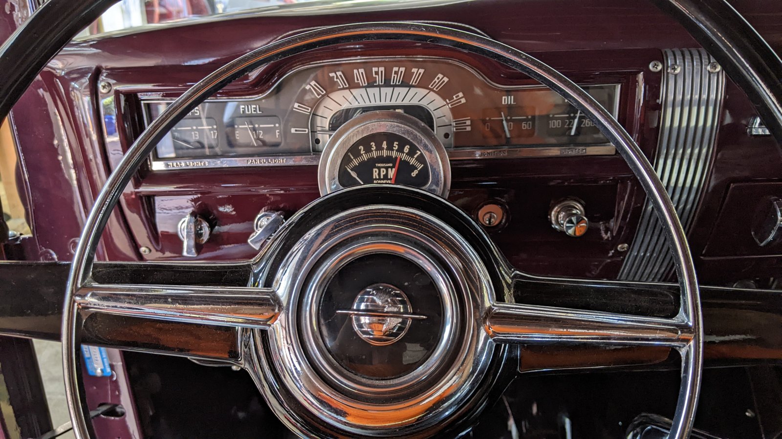

    I incorporated an Olds horn ****on onto the Ford horn ring. Not sure what year Olds this is from.
    The Rocket Circle emblem is an item that was a Oldsmobile dealer giveaway for repeat customers. It was meant to attach to the top of the dash. I had modified the dash so that it would recess and look more like a emblem. When the dealer gave you one it came with number stickers so you could stick onto it to show many Olds you had purchased.
    1938 Fisk Tire token shift knob I made.
