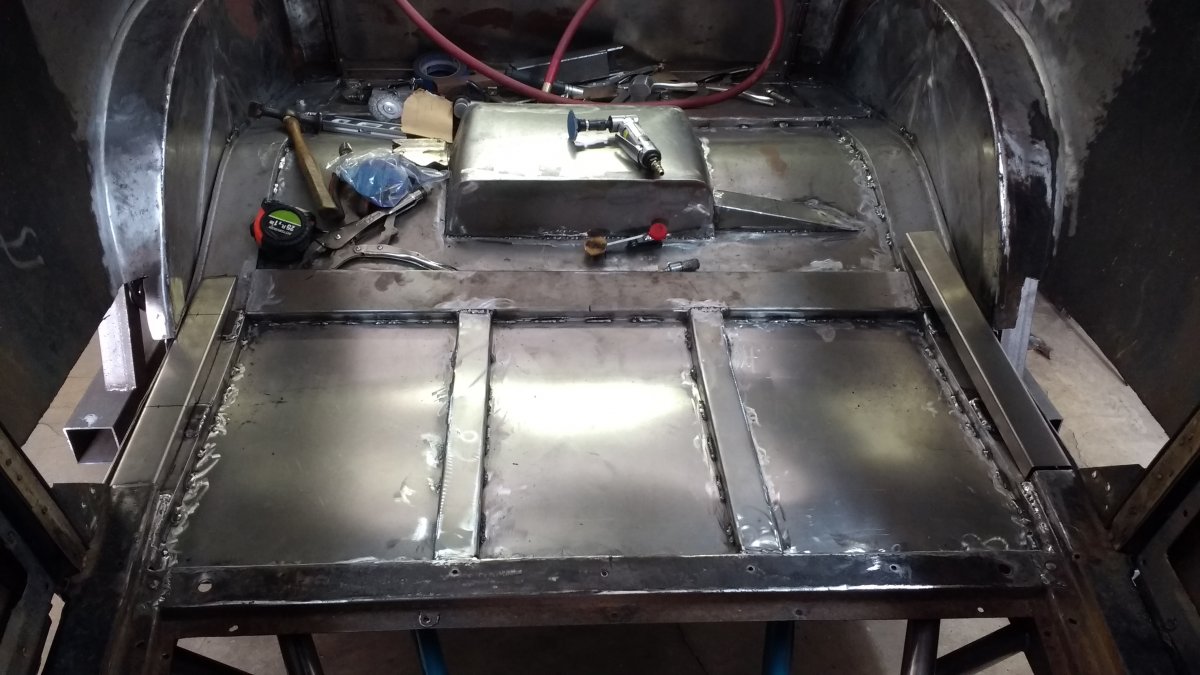

    Trunk came out perfect. Wished mine looked as good. Mine being a Northeastern car had structure issues. Probably not the best one to start with as a beginner but it will do fine for a daily driver.

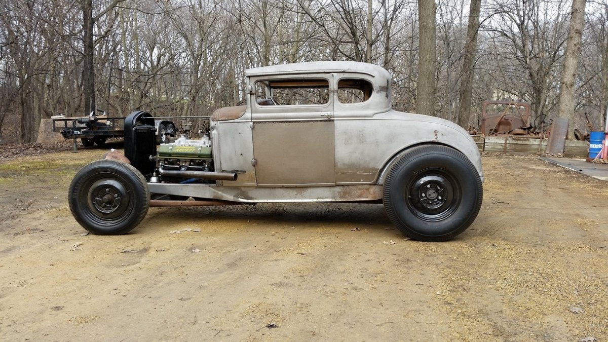

    Your back wheels fit the wheel well perfectly. It looks goofy when the wheels are higher than the trunk

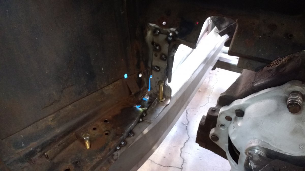

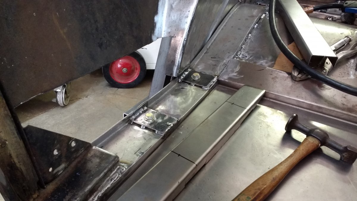

    Got some more work done on the floors.
    I had sleeved the bolt holes through the new subrail sections with dom tubing but added a welded washer plate to the top as the subrail is just gauge metal.
    Tacked the cowl subrail sections back in that I had cut and flattened out per a previous post after welding up the existing bolt holes and drilling new holes to work with the frame. I will finish welding these up when the body comes back off the frame.

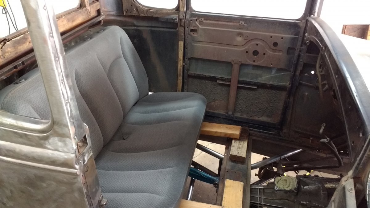

    Started to mock up the F1 pedals and seat to see how things are going to fit.

    Got my cowl top/tank taken out. The tank had not had fuel in it for decades and had no odor. I washed it out several times with dish soap then filled it up with as much water as I could and started cutting with a 3" cut off disk. I was surprised how clean the inside of the tank was.
    I will be installing a new 32 cowl vent. I used to have a 40 Ford pickup and loved having the air from the cowl vent blowing on my legs on the hot days so had to have one on this car as well.

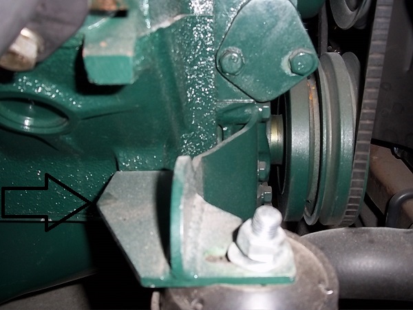

    I have a Hurst takeoff on my Olds that is a bit different design than yours. It is bent toward the rear most likely to allow it to be secured to the block on the side for additional strength. Yours may be too far away from the boss to take any benefit from it. Here is a pic of it for reference fwiw. The arrow points to the boss where it is tied to the block on each side.
  15. etboy97
    Joined: Nov 3, 2007
    Posts: 219
    etboy97
    Thanks for the photo of your mounts. I have seen those before and did consider adding something back to those holes and still might. I am going to have mid/rear motor mounts as well as I don't feel comfortable with just the front mount at the very front of the motor and then just a trans mount at the very back of T5. I have talked to guys that don't have the mid/rear motor mounts on their Olds and using a T5 and have had many trouble free miles but I am still installing them.
