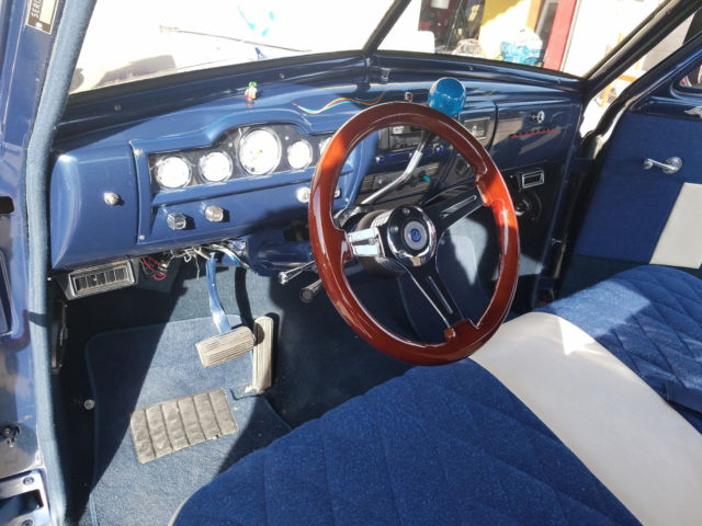

  4. 29StudeDude
    Joined: Mar 11, 2017
    Posts: 362
    29StudeDude
    If you want a more modern gauge layout, a company on eBay is making an aluminum insert for your dash. I had one in my '51 Plymouth Concord.
    loudbang and catdad49 like this.
  5. etboy97
    Joined: Nov 3, 2007
    Posts: 219
    etboy97
    Thanks but I plan on keeping the gauges looking stock.
