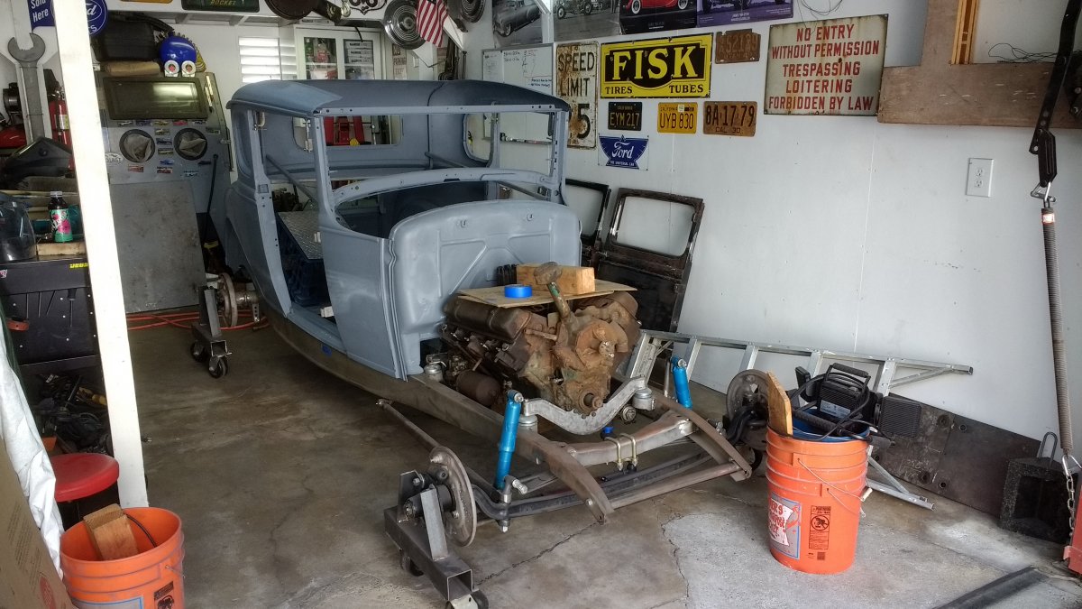

    Not wanting to hi jack etboy97's thread and I'm not ready to start a new thread yet. Bought from a local friend. 30 Coupe.png

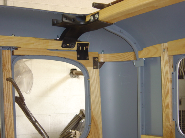

    Good stuff. Your build is very similar to mine. When you get to the point of installing new wood is it possible for you be as detailed photo wise? I'll be doing new top wood and this is my first go at it! Much appreciated

    JJ, just went thru this. Didn't have any wood to start with but @sloppy jalopies up in ME helped me out with some pieces and I added to that. I have some pics I can share that I pulled off the web that helped me with the brackets etc.
    Don't mean to hijack this thread just trying to help here.

    The wood pics will help me out also. Thanks.
