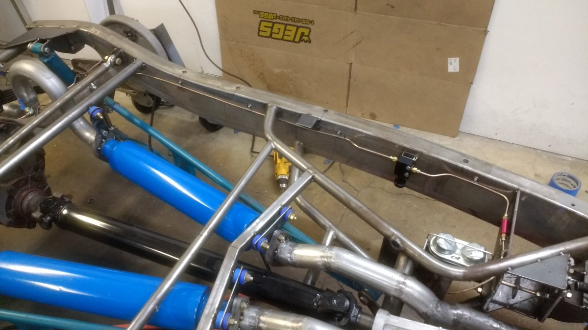

    Exhaust is all mocked up and ready to be welded. 2-1/4" aluminized mandrel bends and Porter mufflers. I will be adding bolt together flanges at both ends of the mufflers and will have to add at least one cross member to hang the exhaust off of.

    Exhaust looks good - tucked up nice and tight.

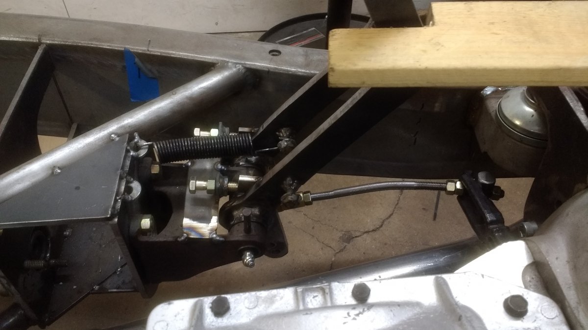

    The exhaust piping is all welded up with the exception of the flanges at the mufflers. I ended up adding two cross members to hang the exhaust off of.
    I also added adjustable return stops to my pedals along with alternative way to mount the return springs. Since I have a removable floor having these on top of the pedal ***embly is workable.

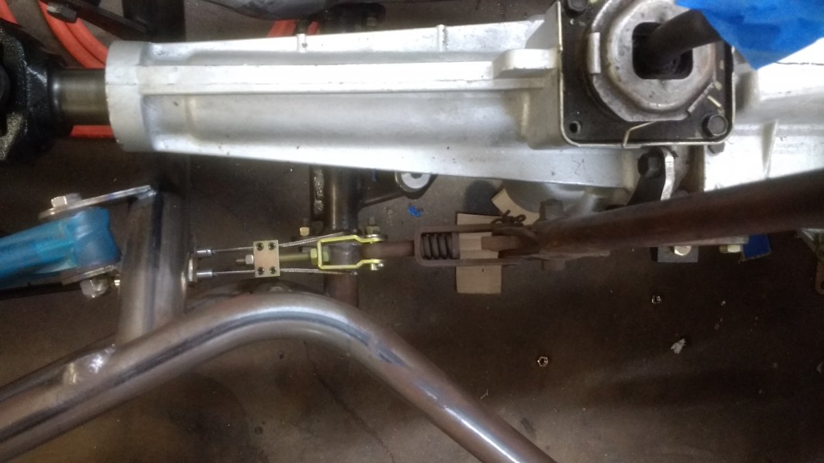

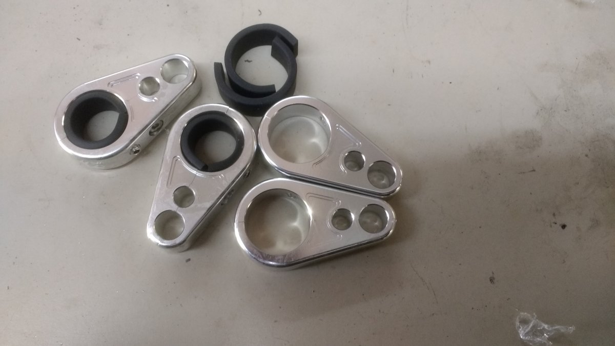

    I installed a universal parking brake cable kit which connected right up to my vintage Ford parking brake handle.

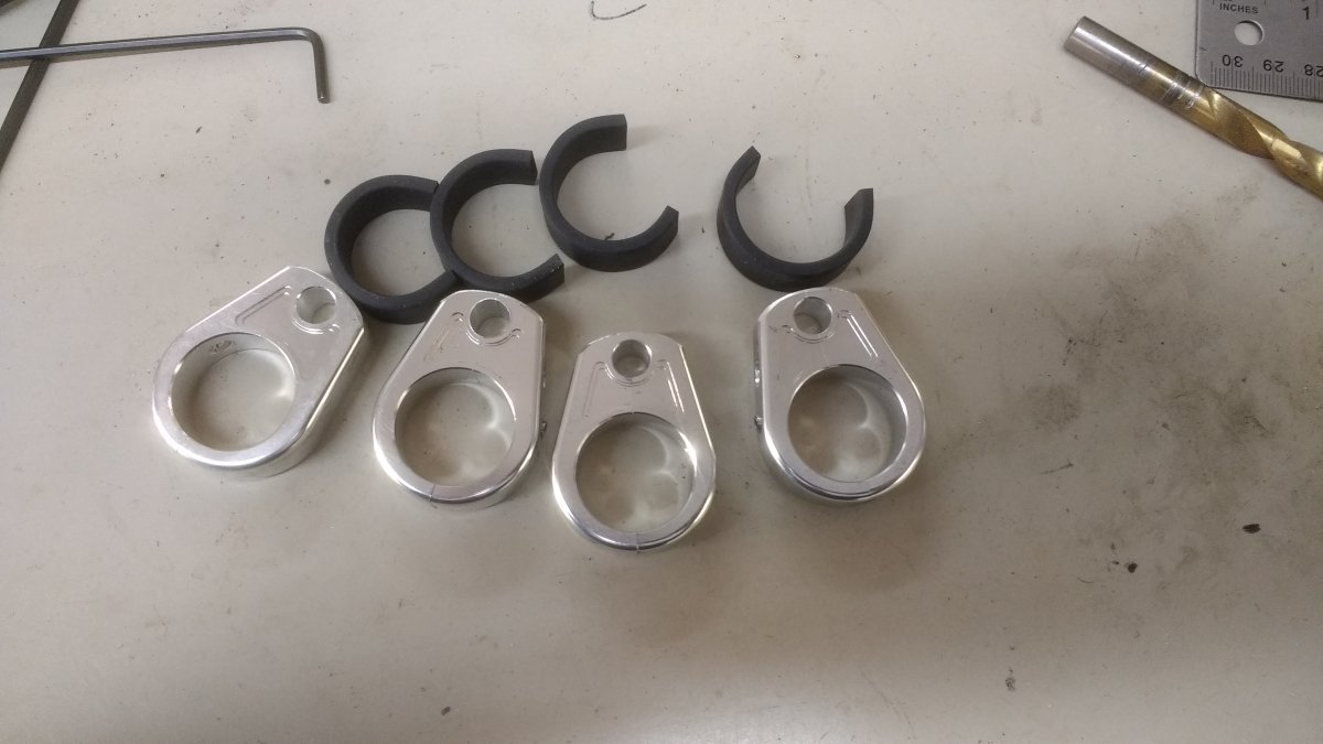

    To secure the cables to the ladder bars I bought some ATV brake cable brackets off of Ebay and modified them a little.
    This will be the only billet on the car.
    I also installed the rear brake lines using Nicopp line.

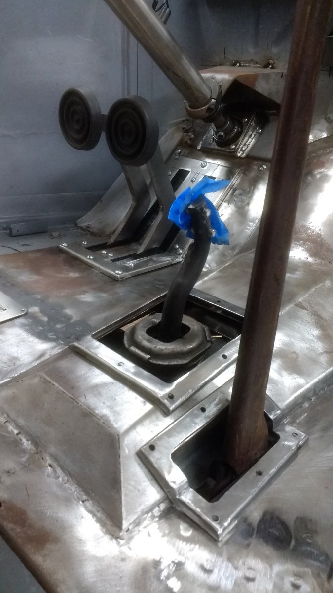

    The body is back on the ch***is so I can hopefully make all of the needed penetrations so there is no cutting or drilling after paint.
    I made trim for the shifter and brake handle boots along with a new pedal trim and a steering column hole trim.

    May I ask where you got the universal park brake cable kit?

    You can find them at Jeg's, Summit, eBay, etc. Lokar is the main manufacturer that I aware of.

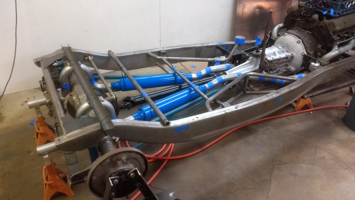

    Pulled the body, motor, and trans for what I hope is the last time. Finished up the brake lines and the fuel line and filter.
    I sold the 66 Mustang I had taking up 1/2 of the garage so I could get the space back to work in and have the funds to get the 324 Olds rebuilt. I should have done this sooner thinking about how much time I wasted moving stuff around to work. The front tires are just rollers and not what I am running.
    Next up is to take the ch***is apart and finish up all of the welding on the frame.

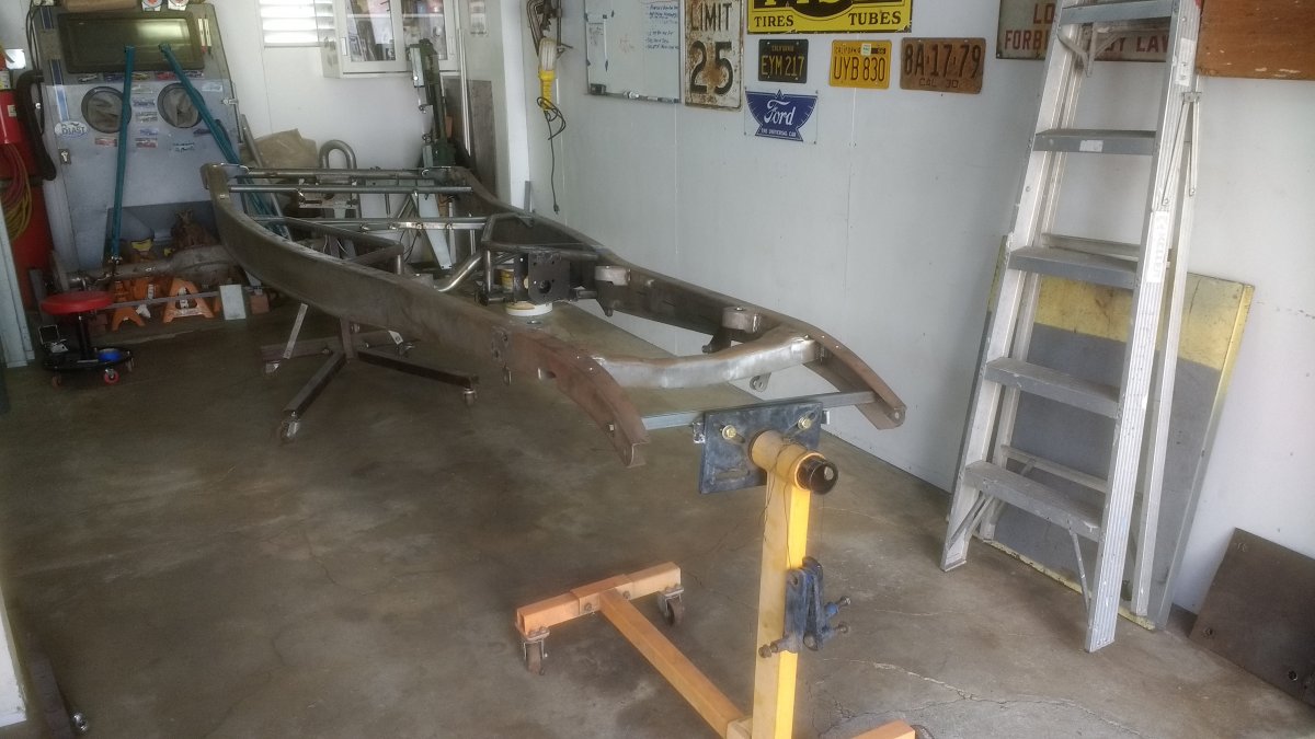

    I got the rest of the frame stripped down and built a rotisserie out of two engine stands so I could finish up all of the welding.
    With the welding done and the frame cleaned up I set up my spray booth and shot the frame in epoxy primer.
