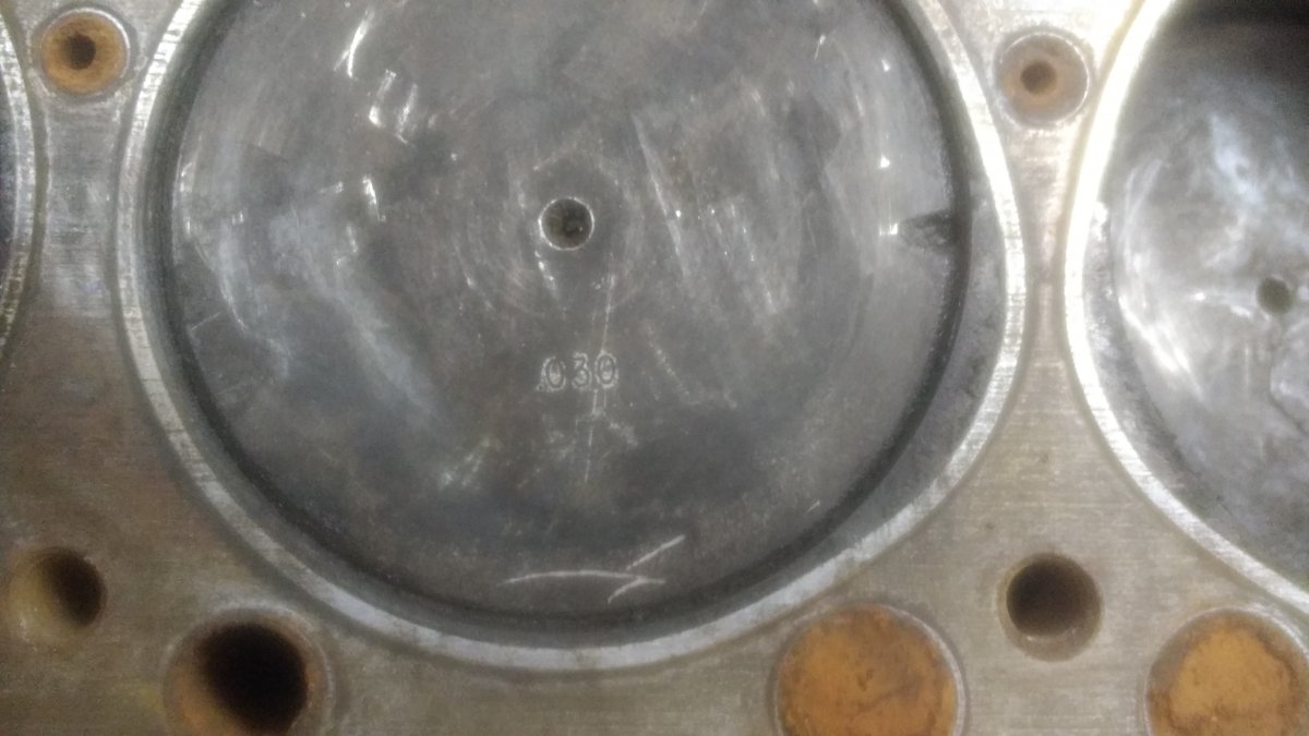

    I have been thinking about the motor lately and how clean it looked under the valley pan. The trans that had come with the motor had a rebuild tag on is so that got me thinking that maybe the motor had been rebuilt as well so I decided to pull one of the heads off to find .030 over pistons so I hope it will need more of a freshening up then a complete rebuild.

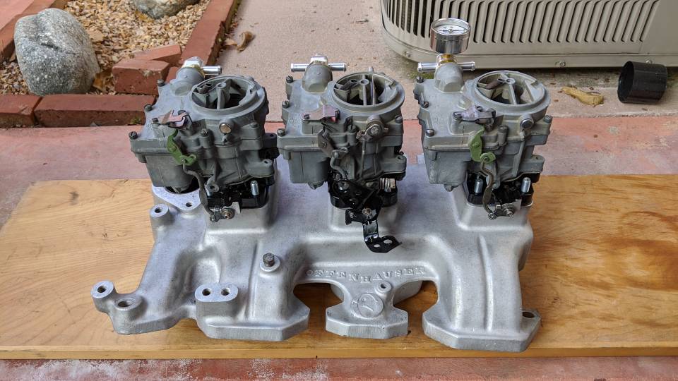

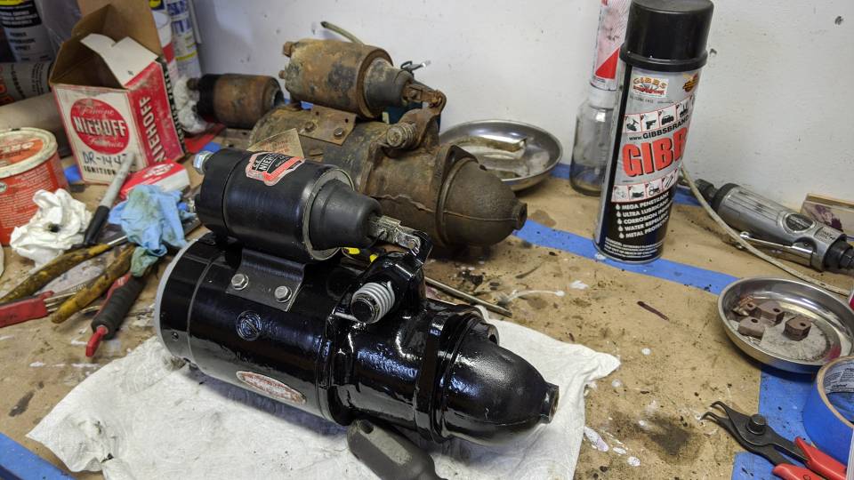

    I want to get started on getting the ch***is back together but have been messing with engine parts. I talked to Tim at Hanford Auto about doing my engine. I hope to get it in to him in a couple months when he has an opening. In the mean time I rebuilt my starter and got my tri power Rochester carbs done. I am using the Vintage Speed kit with the secondary bases. IMG_20200111_121907.jpeg IMG_20200116_085251.jpeg

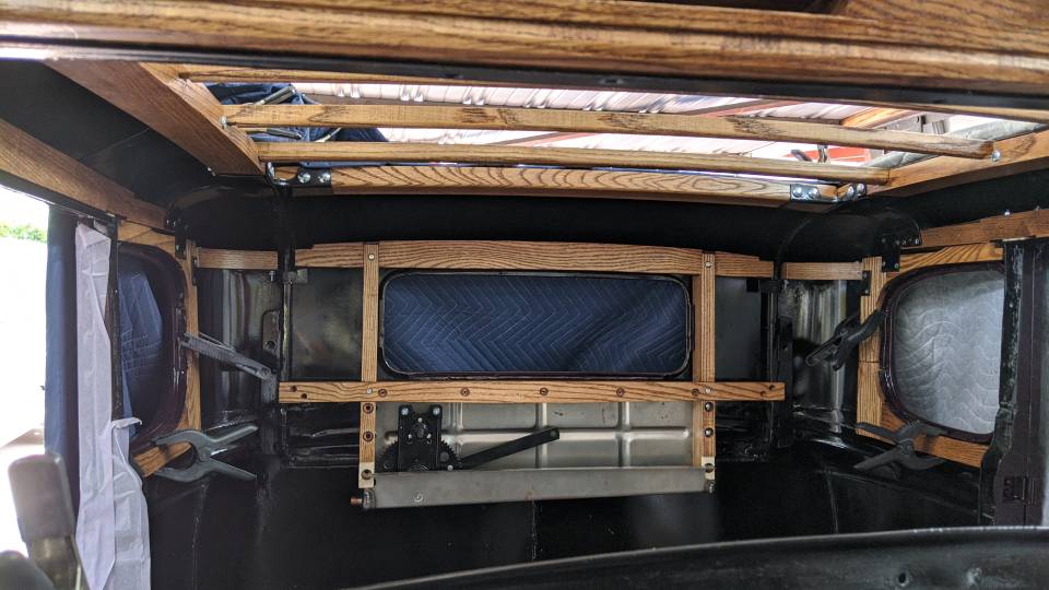

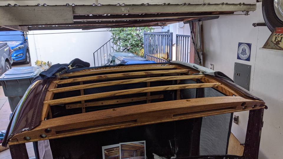

    Got most of my wood in. I had to do a little t******* and shimming for it to fit. I am doing a roll down rear window and had bought a complete kit from Brattons but am finding out most of the holes in the drip pan don't line up with the wood that came in the same kit so will have to modify the drip pan some. IMG_20200208_133550.jpeg IMG_20200207_163517.jpeg

  19. Kevin Ardinger
    Joined: Aug 31, 2019
    Posts: 1,050
    Kevin Ardinger
    Great pictures! They will help me immensely with the wood structure for the roof of my car.

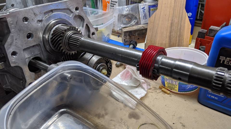

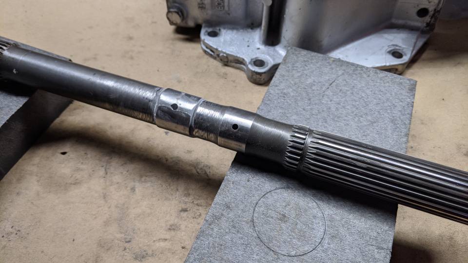

    Got my T5 trans rebuilt. It a combo of parts from three different trans.
    88 V8 Camaro trans with S10 tail shaft housing and Mustang top cover that has a neutral safety switch. I had to relocate the output shaft speedo gear.
    You also have to add a notch to the S10 shift rail for the Mustang neutral safety switch to work.
