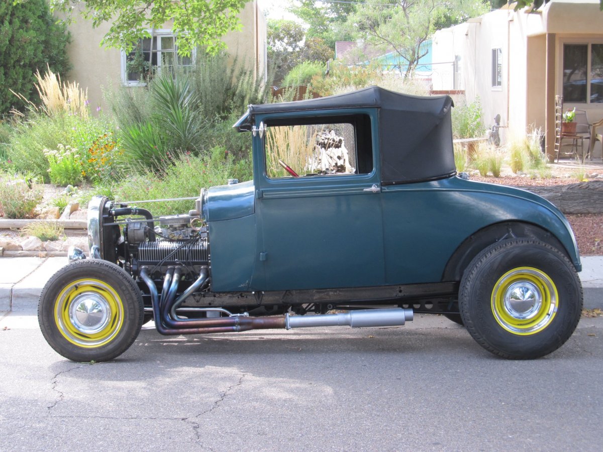

    exhaust isn't done, on the car now is so i could enjoy it while i gathered $ for an under car/out the back, system.

    Thanks for telling us that. The car looks great if you look around the exhaust - and sometimes you have to do whatever is necessary to be able to take a drive so it's understandable good job!
