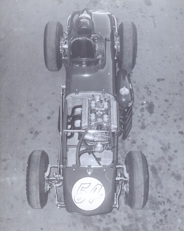

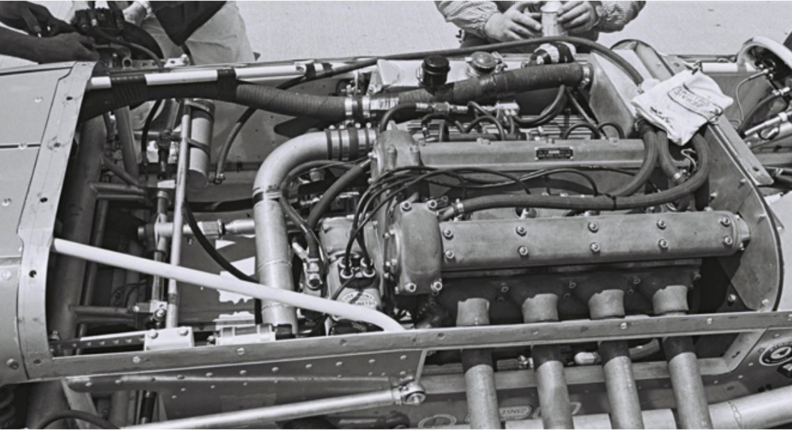

    blueprint2002
    This view of the 1961 Chenowth Chevy shows clearly how spacious the engine bay of the roadster was. Quite a lot of additional equipment could fit in there, if needed:

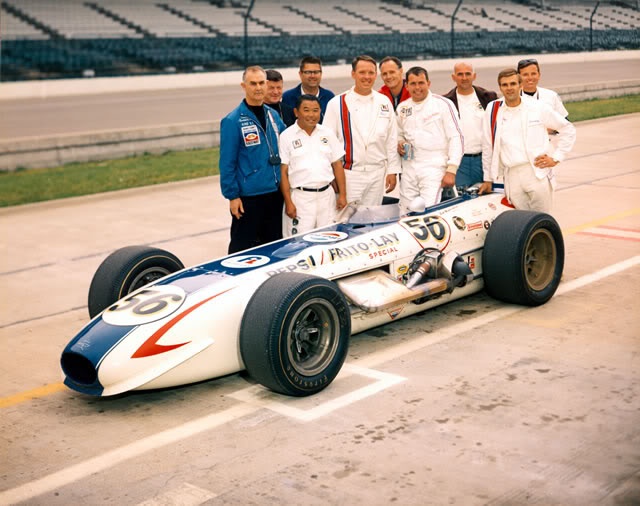

    So it is difficult to understand why the original Mallards had the exhaust header, turbocharger and blow-off valve hanging out in the breeze. More so as the car is not a “standard” roadster, so things could be arranged as the designer chose:

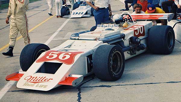

    And the later version must have had even more drag, with the induction manifold and what looks like an intercooler sitting on top, in the airstream:
    Were they smaller and more compact than the usual roadsters?

    I can think of several reasons the turbo was positioned as it was.
    1 : It keeps the turbo closer to the header exit so the exhaust gases have less chance to cool. The hotter the gases, the more efficient the turbo is. It also cuts down on the complication of the exhaust system and there's no massive heat source under the hood to transfer heat to the fuel system or cockpit.
    2 : It might have been done to enhance left side weight bias, Although I'm not sure that was as much of a consideration as it later became to be.
    3 : The placement of the turbo probably was not much of a detriment to the aerodynamics, being tucked in behind the left front and the tire acting as a wind deflector. Also, as with most open wheel cars, the tires are the main spoiler of air flow over and around the car since they have the aerodynamics of a concrete block.
    Any reasoning beyond that you would have to ask Herk or Pete.

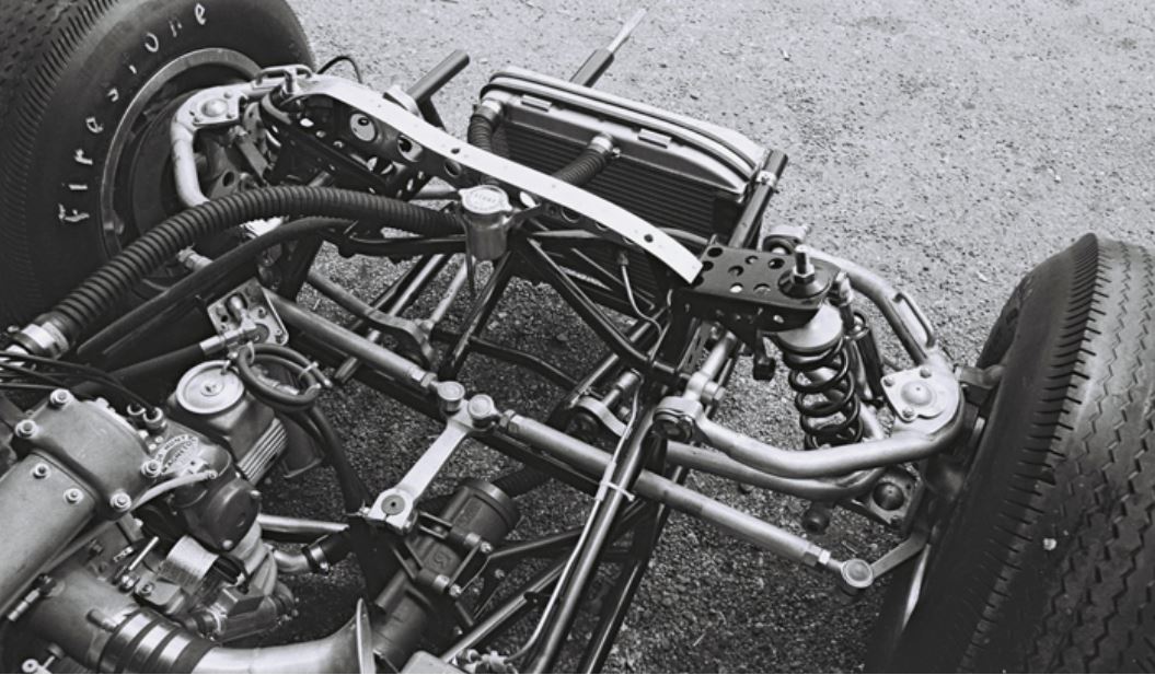

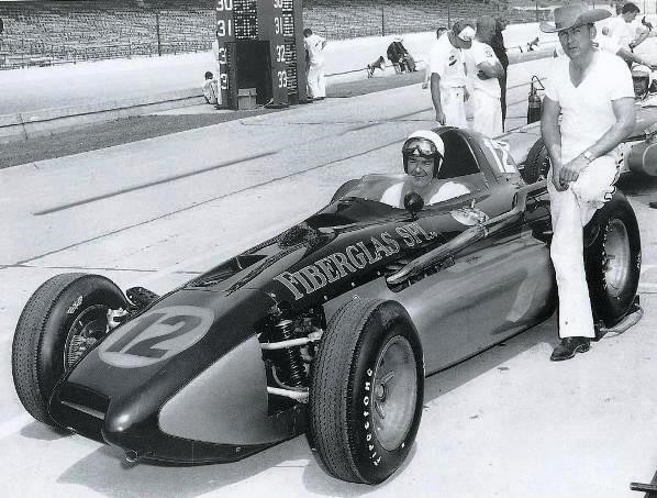

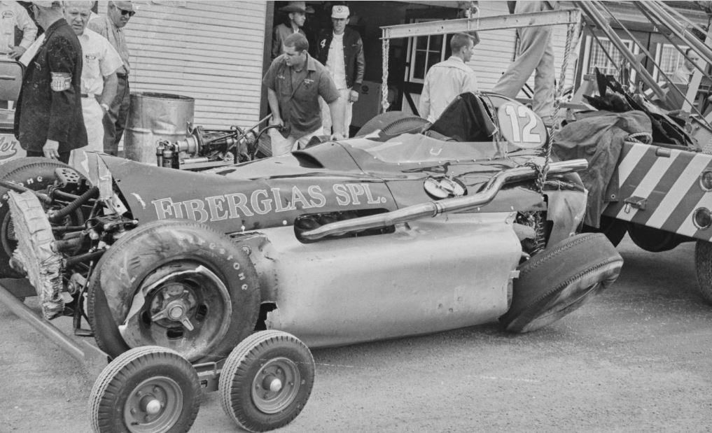

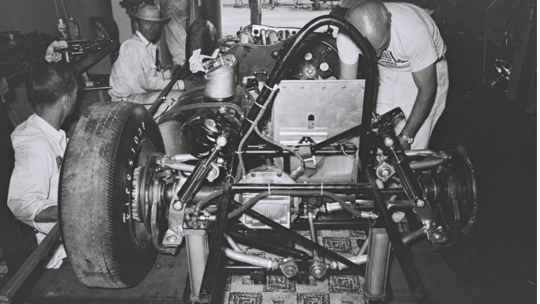

    Smokey Yunick’s “Python” of 62-63 (Simoniz Special). Just about the most radical roadster of all. Chassis and upright engine offset to the left were fairly standard roadster, but fuel tank in a left side pannier was not.
    Independent suspension all around, arranged to cause the car to bank inwards on the turns: how this was achieved is fairly apparent at the rear, where the upper wishbones are unusually long and steeply angled so that their inboard ends are well below those of the lower wishbones, and nearer the car centreline. Looks like simple geometry does the trick. Not so apparent at the front, where the wishbone geometry appears fairly conventional as IFS systems go.
    Some unusual features of the chassis mounts, for the upper wishbones and for the coil/shocks, may hold the secret here?
    Whatever the method, banking the car inwards is exactly opposite to the natural tendency, and can only be achieved by overcoming the weight transfer, thus generating unusually high forces at some points in the suspension and the chassis?
    Did it work as intended? Were the drivers able to adapt to this unusual behaviour?

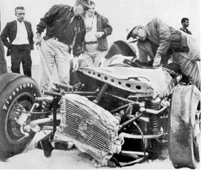

    To slow in 62 and then put itself out of its misery running into the wall at high speed in 63. Lots of whizz-bang, whirly gig stuff to see but in the end it ended up in the scrap dumpster. His only real success at Indy came when he was wrenching on a Watson type roadster which was about as simple as dirt. Sometimes the KISS principle really does apply best to the situation.
    Capture p-a.JPG Capture p-b.JPG Capture p-2.JPG Capture p-3.JPG Capture p-4.JPG Capture p-5.JPG Capture p-6.JPG

    It looks like both pics depict attempts at different approaches. What looks strange to me is that I would guess the right rear upright would be fixed to the housing and the left to float (in and out). Otherwise the bind in the mechanical movement would induce an uncontrolled rising spring rate.
    Keep this info coming, it is great to see, John

    The third member is fixed and the driveshafts appear to have splined "plunge" connections just outboard of the inner U joint as evidenced by the reduction in diameter (just inboard of the frame rail)
    Roo
  11. Roo,
    Yup, I see what you are saying, my bad. I knew something didn't look right to me.

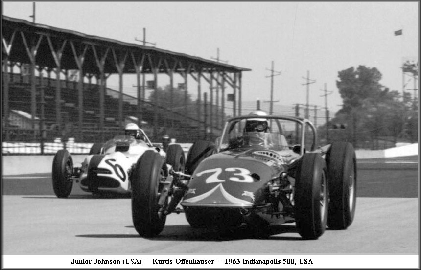

    The only contemporary picture I am able to find of a Kurtis KK500L, possibly the last roadster built by Frank Kurtis? It does not seem to figure in any Indy 500 results, so presumably DNQ.
    Some recent pictures of the car (as restored?) seem to show independent suspension front and rear, perhaps an attempt to keep competitive with the threatening rear-engine cars? Externally at least, no other apparent changes from earlier roadsters: upright engine offset to the left, fuel tank at the back, no reduction of frontal area, aerodynamically similar to KK500H and J (was there a KK500I?).

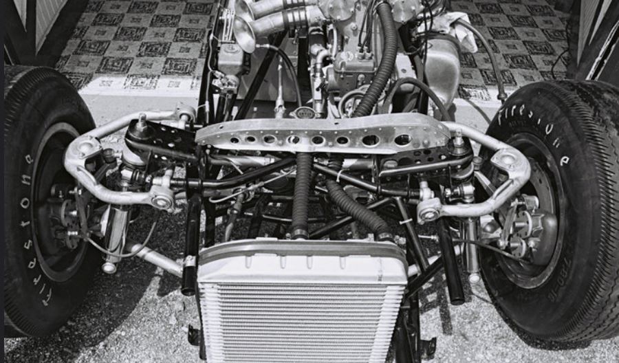

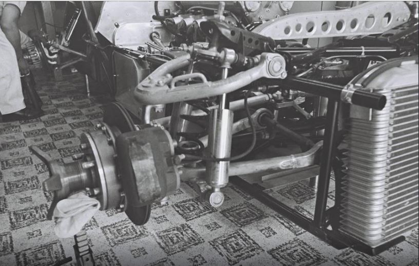

  17. blueprint2002
    Joined: Dec 25, 2018
    Posts: 235
    blueprint2002
    Thanks Rootie for another set of amazing historic pictures, clearly showing so much detail.
    Independent suspension all round, fairly similar to various road racing cars of that era, though with typical Indy torsion bars. No apparent offset to the suspension, though it is difficult to be certain.
    Good to see the safety belts and the full roll cage (even if ugly): driver safety at last being attended to!

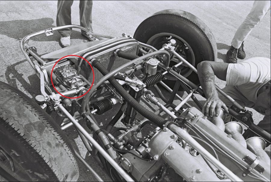

    In the fifth and sixth pictures, there is some device just ahead of the jack, and to the left. It seems to have two pipe connections: what could it be?
    Was there only this one car of this type?
    Thanks again.

  18. deucemac
    Joined: Aug 31, 2008
    Posts: 1,625
    deucemac
    If my memory is correct, Ed Hite's book on Kurtis speaks directly about this car. The car was built for Junior Johnson to drive. The car owner insisted on a distributor ignition instead of a mag. Frank Kurtis talked until he was blue in the face, trying to convince him to change his mind about that ignition but to no avail. The combination of owner, ignition , roll cage, and Junior's reluctance about the car all added into Kurtis' decision to end the Indy car business.

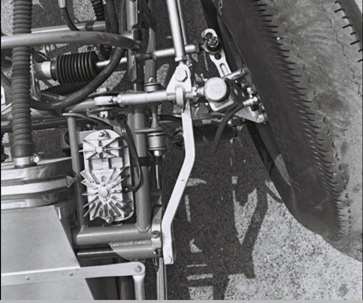

    Here's a couple of pics without the nose on. I'm thinking that the chingus with the pipes is this circled part ( whatever it may be) that was unattached and laying upsidedown on the bottom of the nose.
  20. Speedwrench
    Joined: Nov 21, 2009
    Posts: 1,032
    Speedwrench
    To venture a guess. I'd say the circled item is part of a transistorized ignition system.
    J Willy Richins and dana barlow like this.
  21. Fordors
    Joined: Sep 22, 2016
    Posts: 6,232
    Fordors
    I agree about the transistor box, it looks like the Prestolite 201 that Chrysler used. Could the component laying upside down be a hydraulic pump for the jacks on the car? The lines look to be -8, or maybe -10 but either way they appear to be the same size as the hose to the front jack. Were those jacks hydraulic or air operated back then?
  22. I think the device laying in the early photos is the fuel pump for the injection.
    The pic above with the red circle shows the FI pump just below the mag drive.
    The early pics have no motor in the chassis. Pump laid forward (yeah I do that when can..........lazy)
    Don't want to open up lines unless necessary, or just lazy
    AmishMike likes this.

  25. That's absolutely correct. The stubborn owner was John Chalick.
    Speedwrench and deucemac like this.

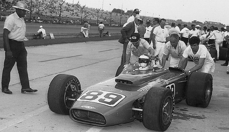

    Quin Epperly built Maxson Special. Probably the last roadster ever constructed, and the first with a monocoque chassis. All the fuel carried on the driver’s left, helping with weight distribution.
    Front suspension appears fairly conventional double wishbone and coil spring IFS. Rear suspension appears to be a modern version of De Dion, with a tubular lattice replacing the old-style large-diameter single tube. (Something similar was used on Sam Posey’s Caldwell D7 CanAm car of 1968, with a horizontal Watt linkage below).
    Supposedly fitted with a Turbo Offy engine, if so, all that plumbing and hardware is cleverly concealed within a very smooth body. Must have been a tight fit.
    Does this car still exist? DNQ at Indy, but surely of historical significance.

    IIRC collector/racer Jim Lattin has/had it in his collection in So.Cal.
