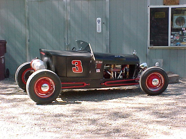

    I think that the reason they are so damned cool is that there is no "exact" specification on how they should be built.
    But this 26/27 is a PNW car that pretty well has it all right on the numbers.
