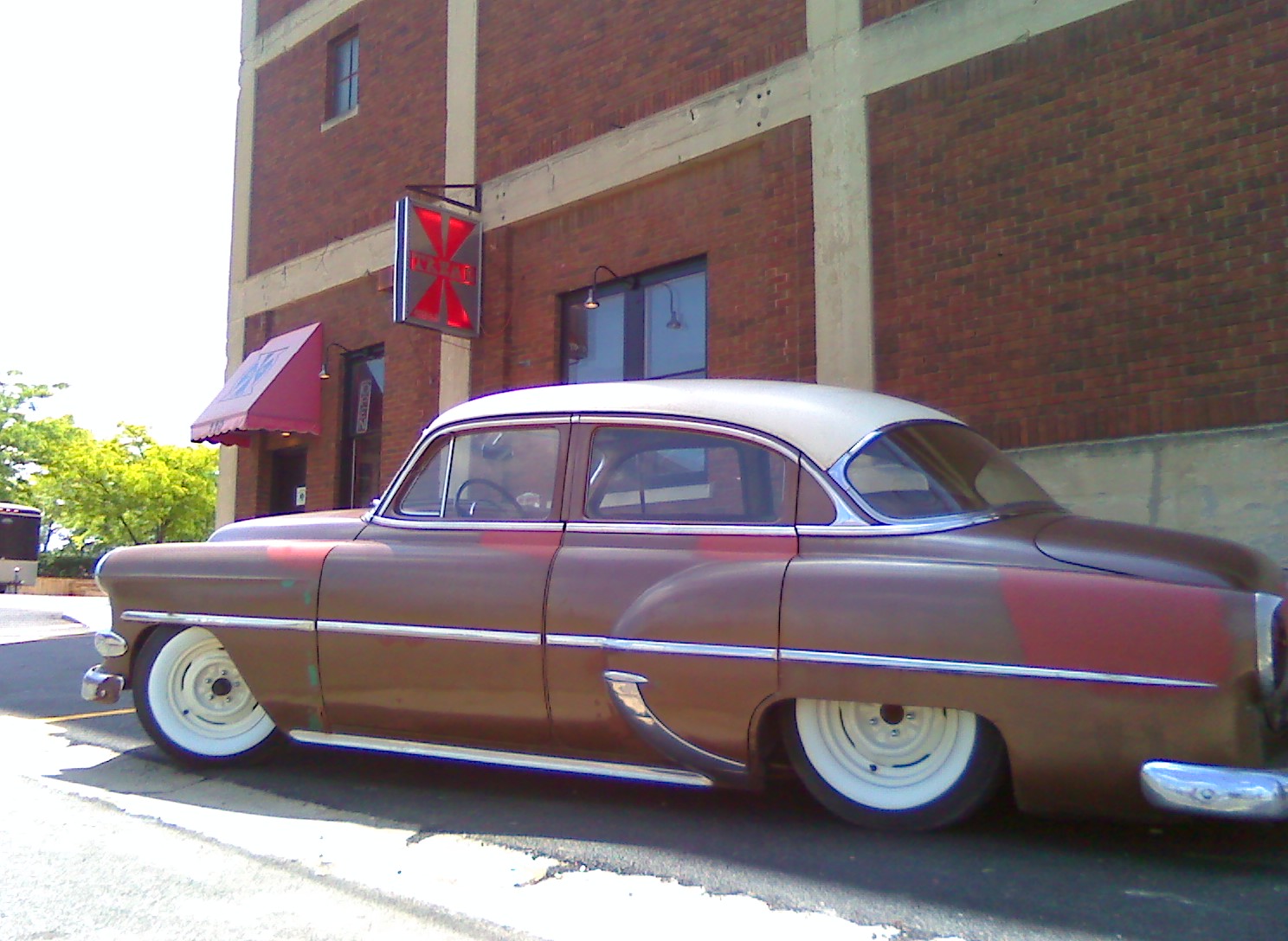

    We installed the brackets under the rear seat similar to the new cars that accept the new car seats with straps up until the kids were old enough to need the shoulder belt, we got some from Juliano's and installed them in the pillars. Now they are in toddler seats and safe. Took some engineering but worth every penny. 54 chevy moor door
