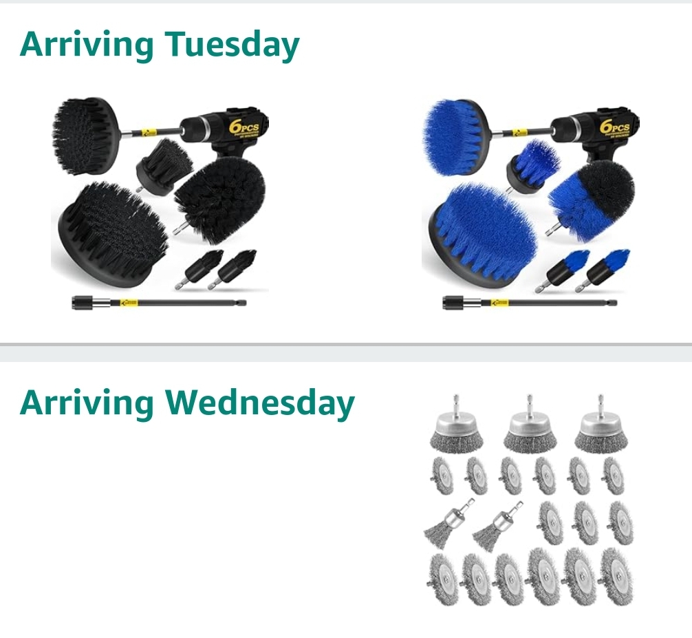

    I'm in a position where I can't sandblast or power wash this frame do to being "locked in" a small garage.
    I've s****ed with a puddy knife, wire brush,
    used a wire wheel on a drill and a wire cup on an angle grinder so far.
    I've ordered and ***ortment of brushes and wire wheel type brushes
    How are you guys gettin down in the nitty gritty behind the crossmembers where it attaches to the frame ?
    End goal is to use Por-15 or similar product on the frame.

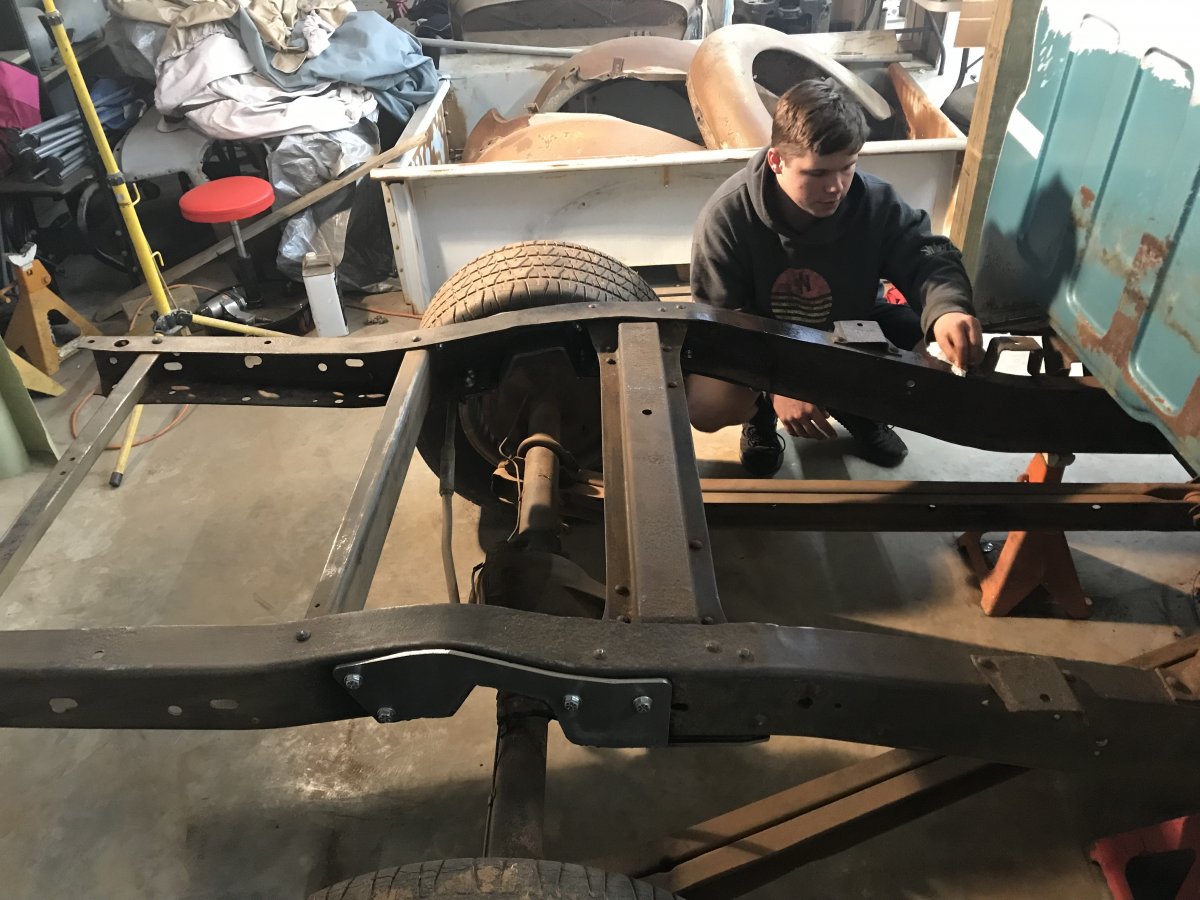

    We basically used most of the tools you described and a teenager when we did my son’s pu.

    The cylinder brushes on the right can get in some pretty tight spots and the drill does the work. The rust busters on the left really clean but they won't get in tight spots and they don't last long.

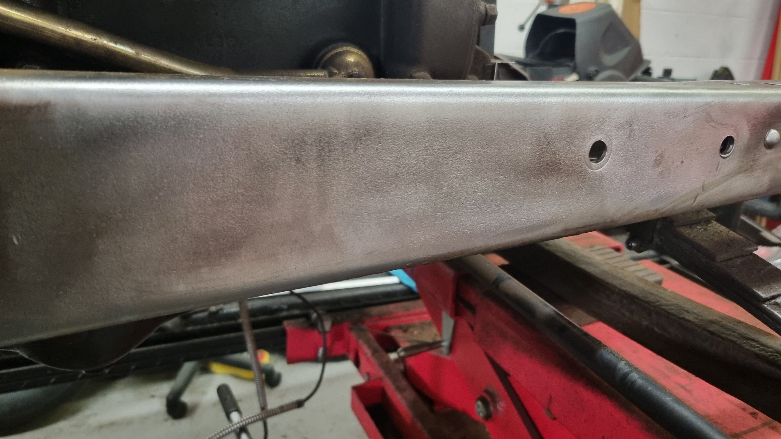

    Drill mounted stuff is a complete waste of time.
    You need stuff that mounts on an angle grinder, cupped brushes, scotch brite pads etc.. this is mine after a couple of hours work

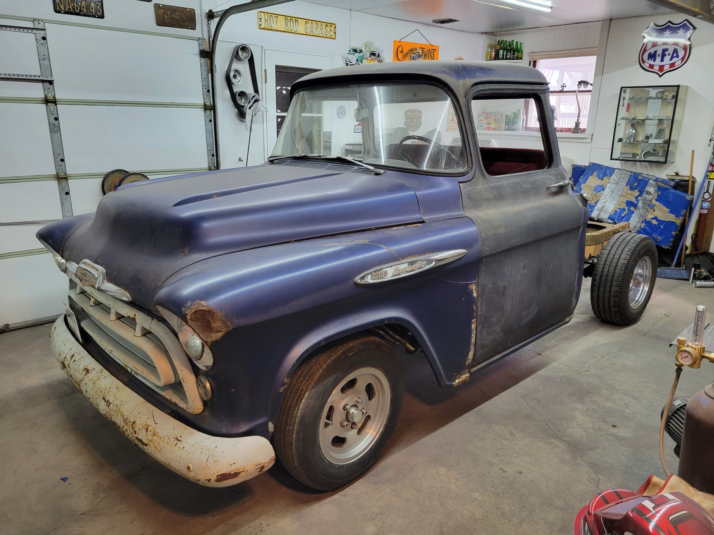

    This will be a shop truck, but not to sure if I'm removing the cab, would prefer not but who knows what will transpire as the build goes along, front clip definitely coming off.
    I just want to do a one and done type a deal on the frame, clean it, coat it with a rust preventer then satin black paint.
    I just moved all 4 cars, a bike and all kinds of parts and pieces to get the truck in there before our first snowfall and long 6 months of winter, so the truck is "locked in" the work area until it's done. Could there be more room, sure, can I build the truck in the current space, sure can, how was the space comment relevant to my question about cleaning the frame, no f'n clue.

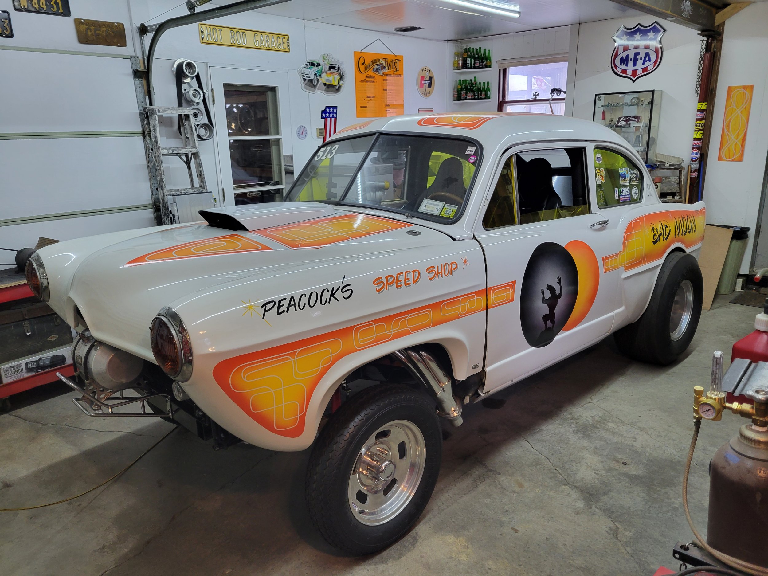

    Finished the Henry J in there last year

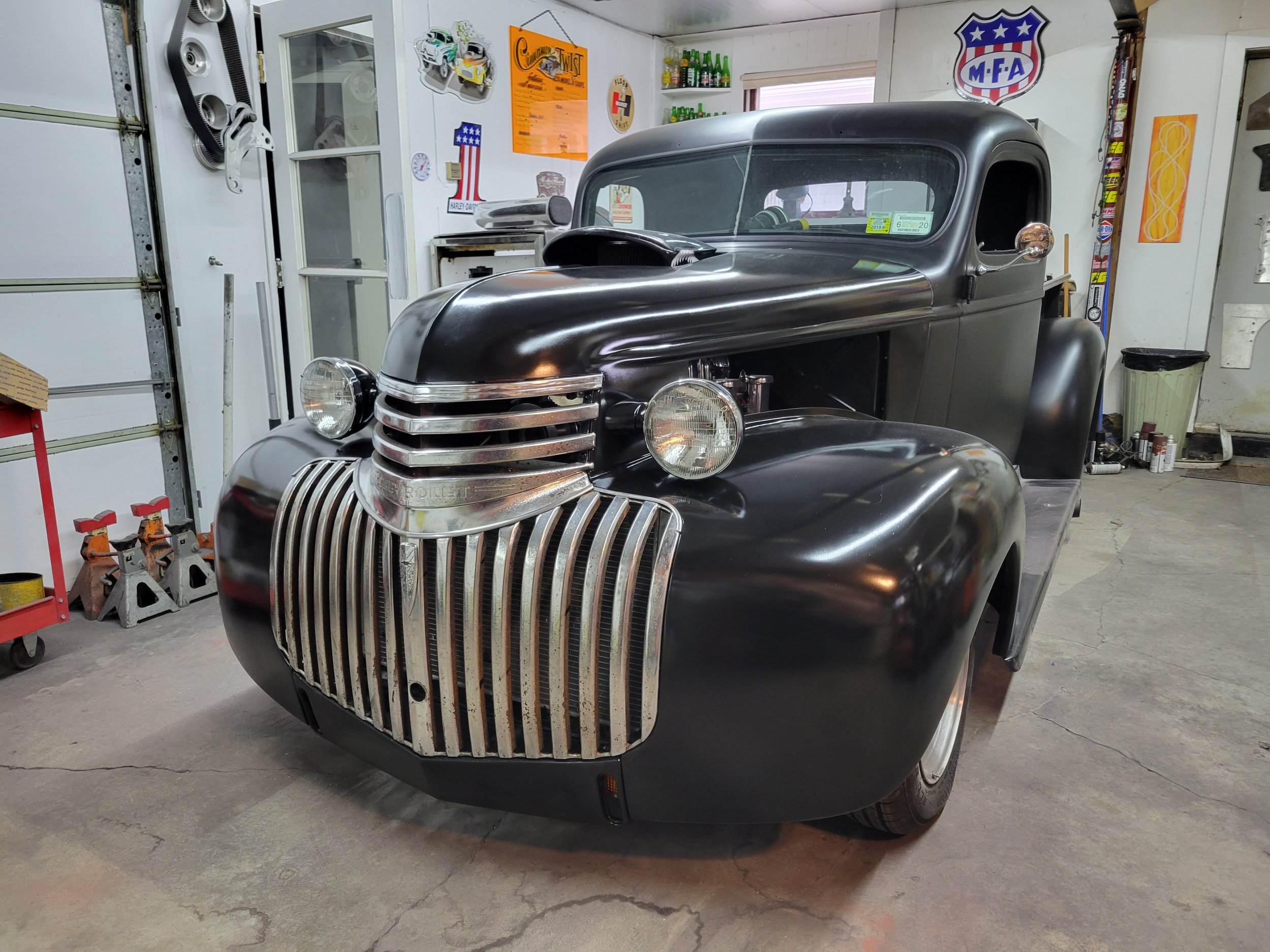

    And the 41 in there this year
    So no show truck, no flawless paint job, just a good solid foundation that looks pretty decent when looking under the truck. Think of it as your 70 yr old skin d****d over your 25 year old body lol

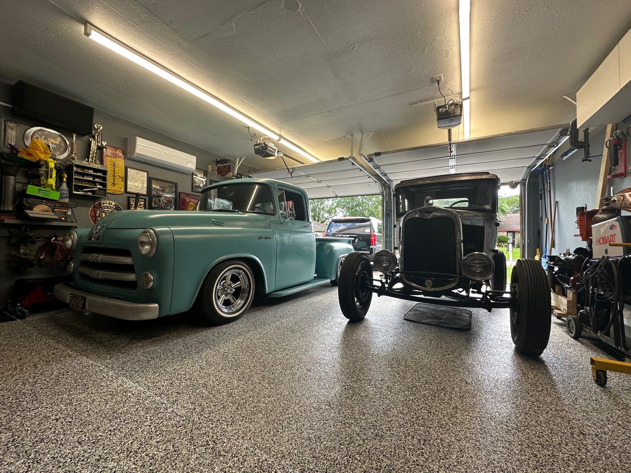

    What did you use on the floor? HRP

    Its Polyurea coating grey with Domino Flakes. Oil just wipes up.
