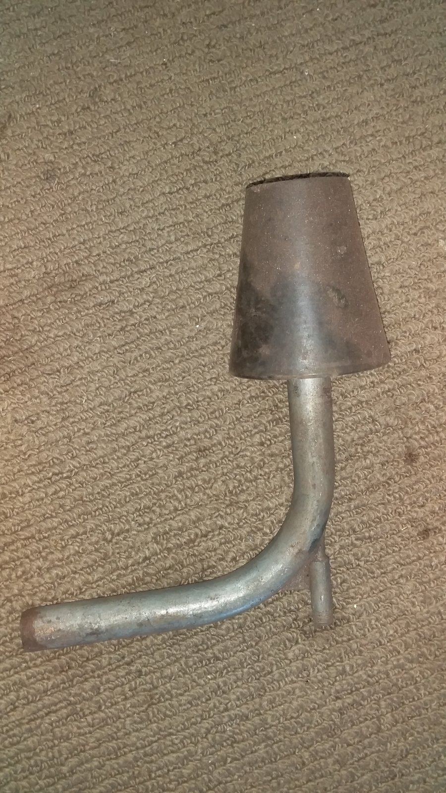

    20230324_112927.jpg Back in the day, we removed both hoses, and had a water hose/air hose (with operating valve, like an air gun) My one pictured uses a tire inflator, with a big tapered rubber sealing plug at the end ..
    The rubber end/plug, was put in the bottom of the radiator, (or reverse to water flow) and the water turned on, when the water came out the other outlet, short bursts of compressed air was used to move the gunk until the water ran clean..
