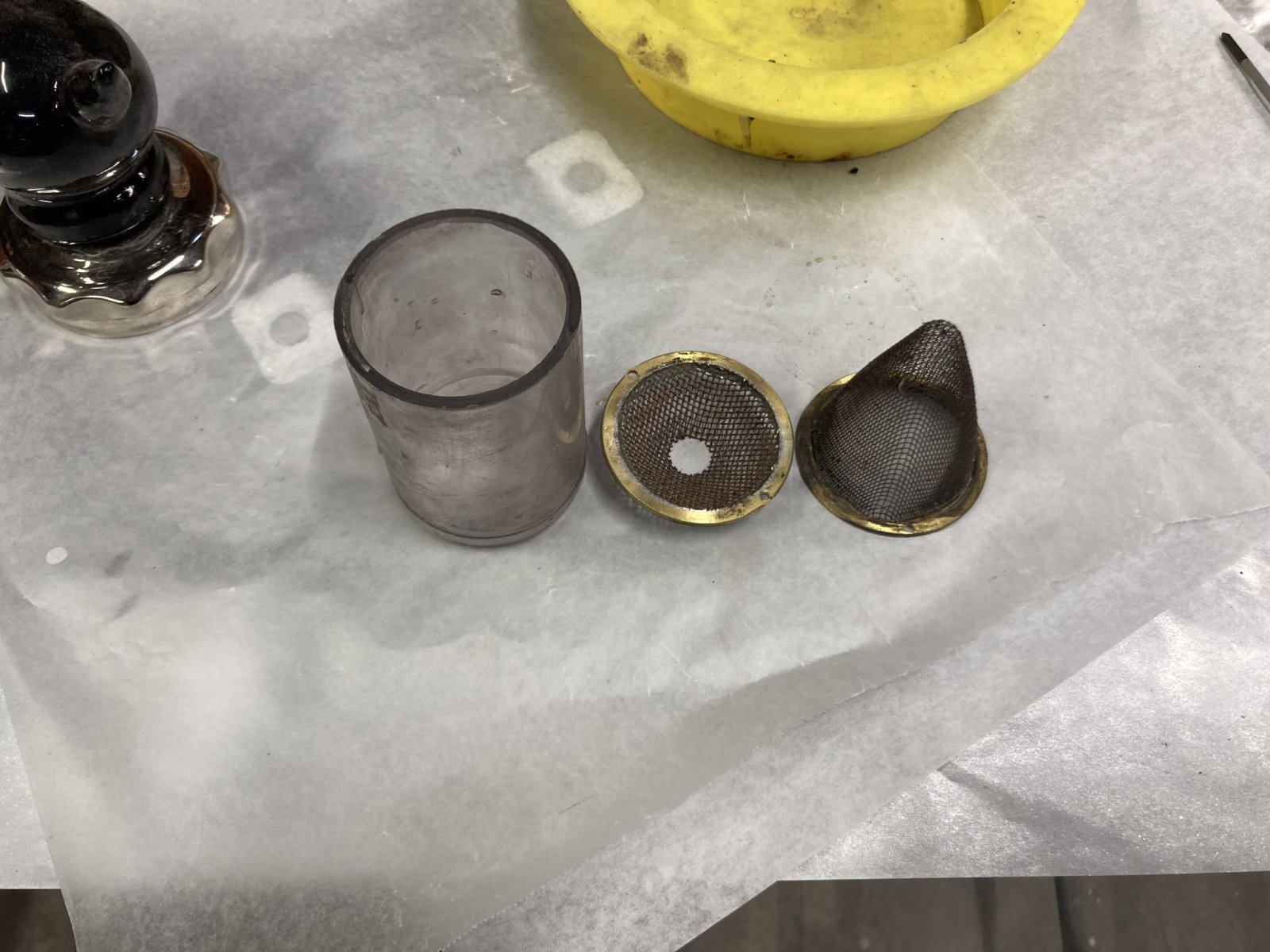

    Something to consider once you have the rad cleaned out
    is add a Gano filter into the return hose to the radiator
    Restoration Supply Company Inc sells them
    they make two sizes
    I have one in my model A and two in my Roadster
    Pull it once every year to clean
    you’ll be surprised how much **** they catch
    8B2F7E5A-8F02-485E-A731-EFC4C607A0FF.jpeg B2984050-9E6F-4710-866A-203DB66611E2.jpeg
    This one is from my model A after a year and maybe 500 miles
    The coolant looked very clean
