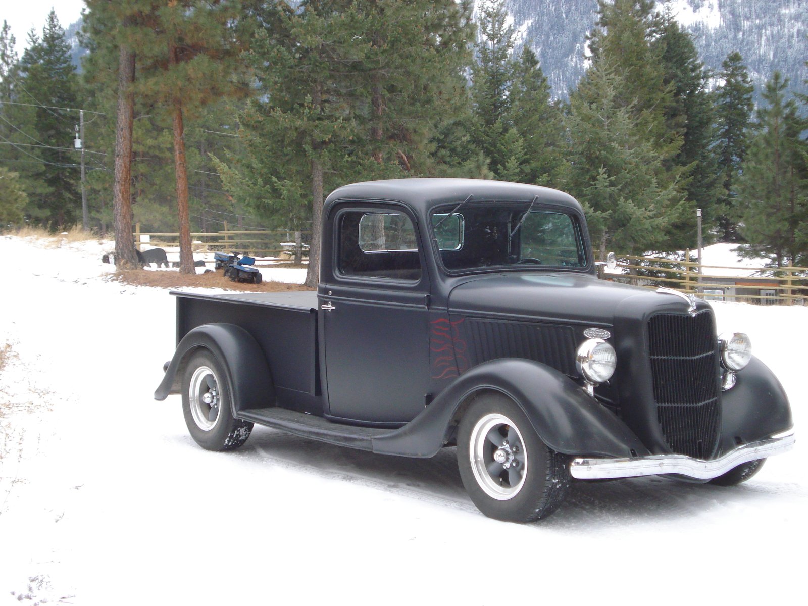

    So, my old girl is twenty five years old, the rad has always had green coolant in it, and after all this time it needs cleaning. It still cools, the 327 has no fan, but it has an electric fan with a 190 sensor in the bottom tank of the rad, which has worked well.
    My issue is....the engine when not moving heats up faster now than before, and takes longer to cool back down when moving. Generally, it's not a problem.
    My question is this, because rad shops mostly don't do rad work, only re and re's, I'm looking at serious money to clean-redo it, so, got any experience with aftermarket rads? A 36 ford pickup rad has extensions on each side that act as hold downs for the hood. I don't want junk, and am looking for real life experience concerning aftermarket rads. My first rad was aluminum, the bottom tank cracked, so I had the original redone, br*** and copper, 25 years ago. Either I redo mine for serious money, or buy new, for the same money. Ideas? DSC07768.JPG

    Nice truck....bet it's running cool in that photo
