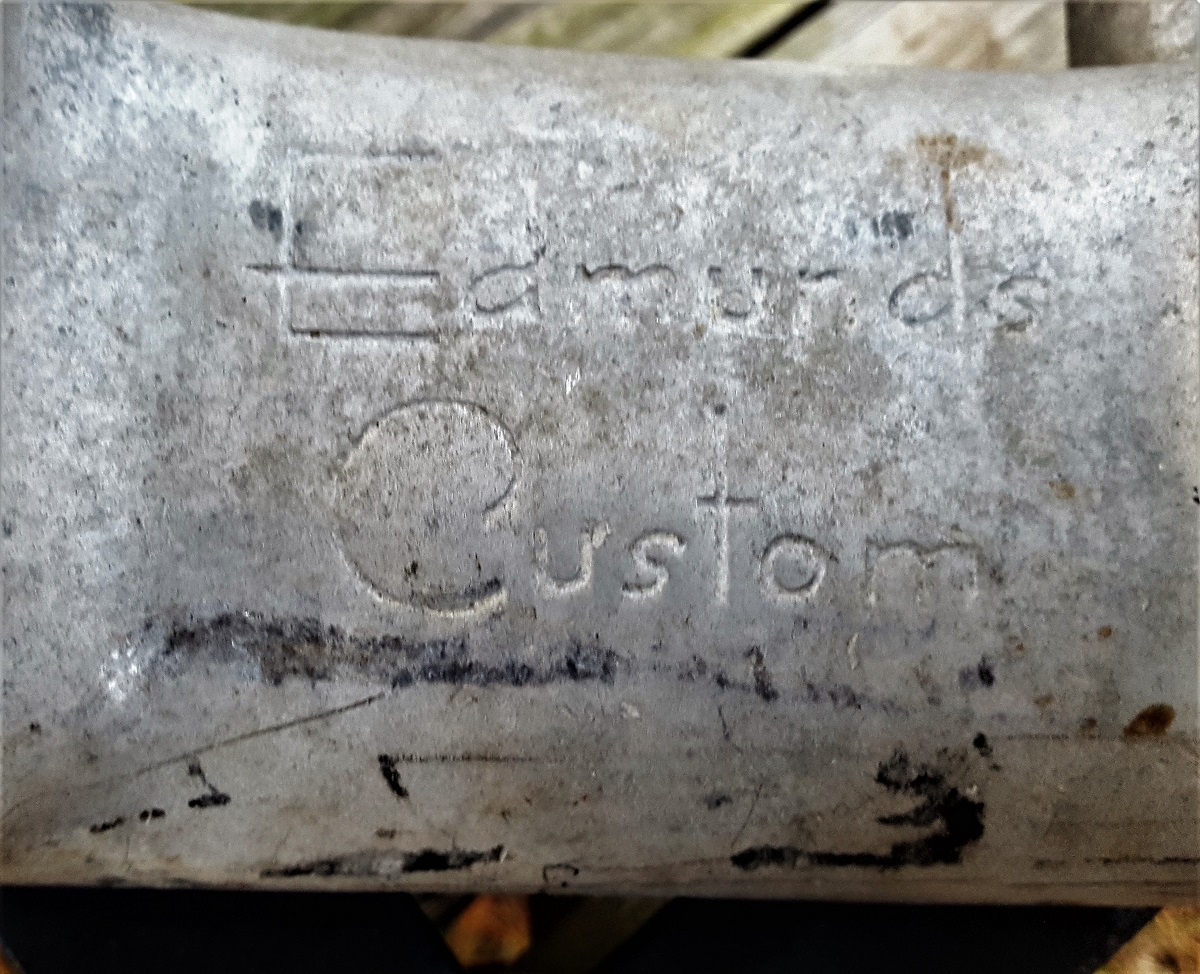

  9. The "symbols" you show pictures of are probably the original owners name or initials used to identify it and have been disguised by the person who stole it from him......or "aliens" left a message on it. Has it been near Roswell?
  10. [​IMG]
    BIG improvement! You can clean up the letters with the end of a small triangle file with light pressure and two hands for control.

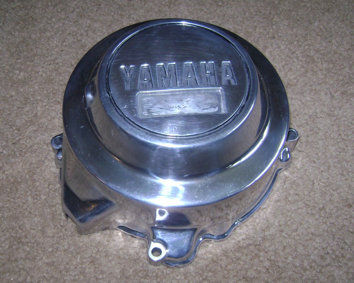

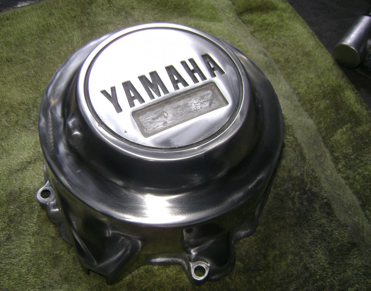

    Top to bottom: as found, prepped with the discs, polished. Total time a bit over 1/2 hour for both steps. The only time I use sandpaper is to 'blend out' deep gouges and scratches. Cost you some bucks in supplies, but once you've done it this way you'll never go back....

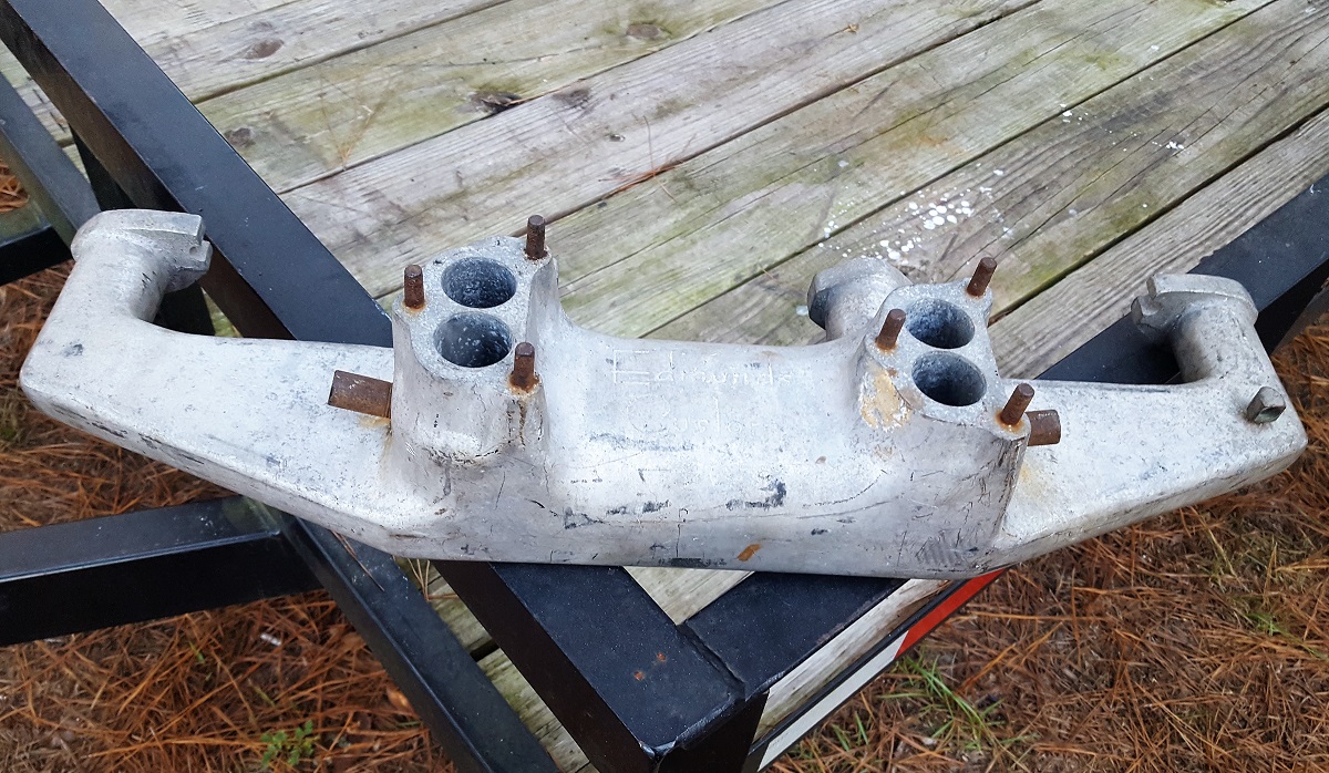

  16. fyrffytr1
    Joined: Dec 20, 2016
    Posts: 1,526
    fyrffytr1
    I picked up a gallon of aluminum cleaner from work today and sprayed the manifold with a 25% solution. It cleaned it up a little but I still have a lot of work to get it where I want it. I am going to hit a spot on the bottom with a Roloc pad and see what happens.

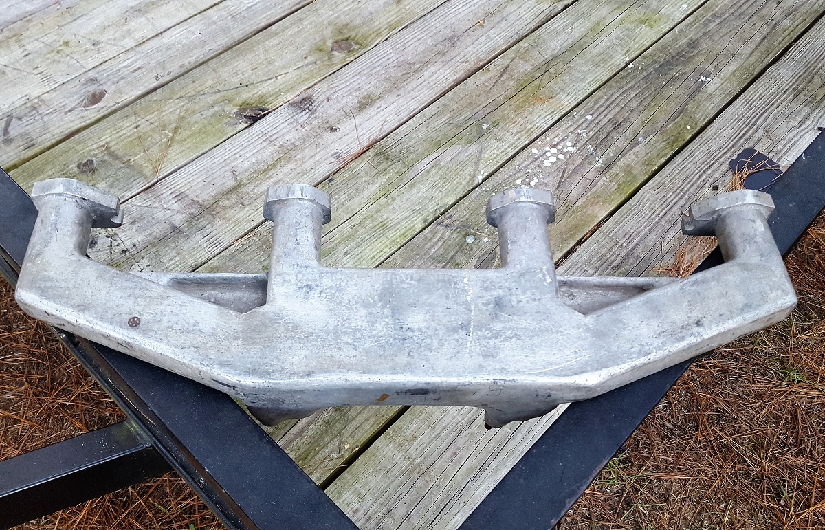

  19. fyrffytr1
    Posts: 1,526
    fyrffytr1
    Thanks for all the great ideas. The problem I have with this intake is the relatively deep nicks in both runners. I have wet sanded with a coarse paper and just about have them out of one end. I may get my Dremel tool out and try it. And, it looks like I will have to work around the water inlet and outlet as they nor the carburetor studs will move. I have soaked them with penetrating oil for several days with no luck. I may spring for a torch and see if heating will free them up.
    It may take a while with the upcoming holidays and a medical procedure I am not looking forward to after the new year but I will keep at it until I finish it or destroy it!
