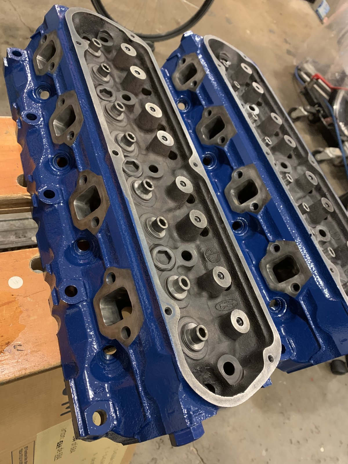

    I just finished the port work on some heads.
    Everything I’ve seen says to wash them with soap and water then dry and oil.
    but I need to paint them.
    So
    Do I try to wash them then paint before oiling and hope they don’t flash rust?
    or
    Do I pint them now and then wash after the pint has dried?

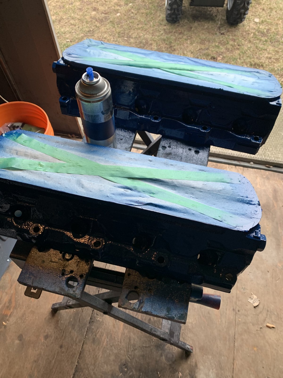

    Follow up,
    I washed the heads with thinners and a paint brush then painted them,
    the paint can cure for a few days then I’ll wash with soap and water, dry, oil then ***emble
