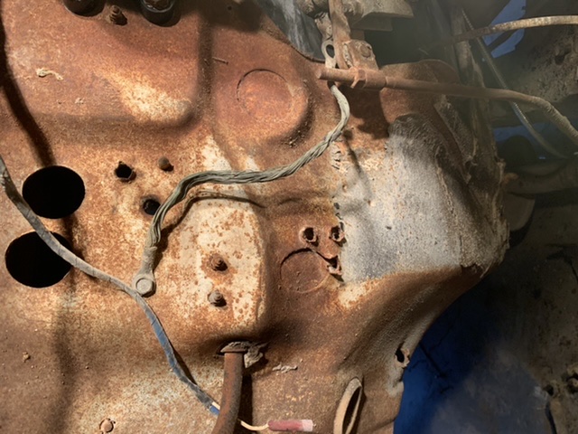

    Here is what I am working with rust wise. Some is a bit more invasive due being where the bay sat. But generally, it like this part of the firewall all the way round.

  9. stillrunners
    Joined: Aug 27, 2009
    Posts: 10,588
    stillrunners
    from dallas
    Not bad...not bad at all....

    All thing considered it isnt to bad. I just want to preserve the metal and slow down the rusting until I can get around to doing a frame off resto on her after I retire.
