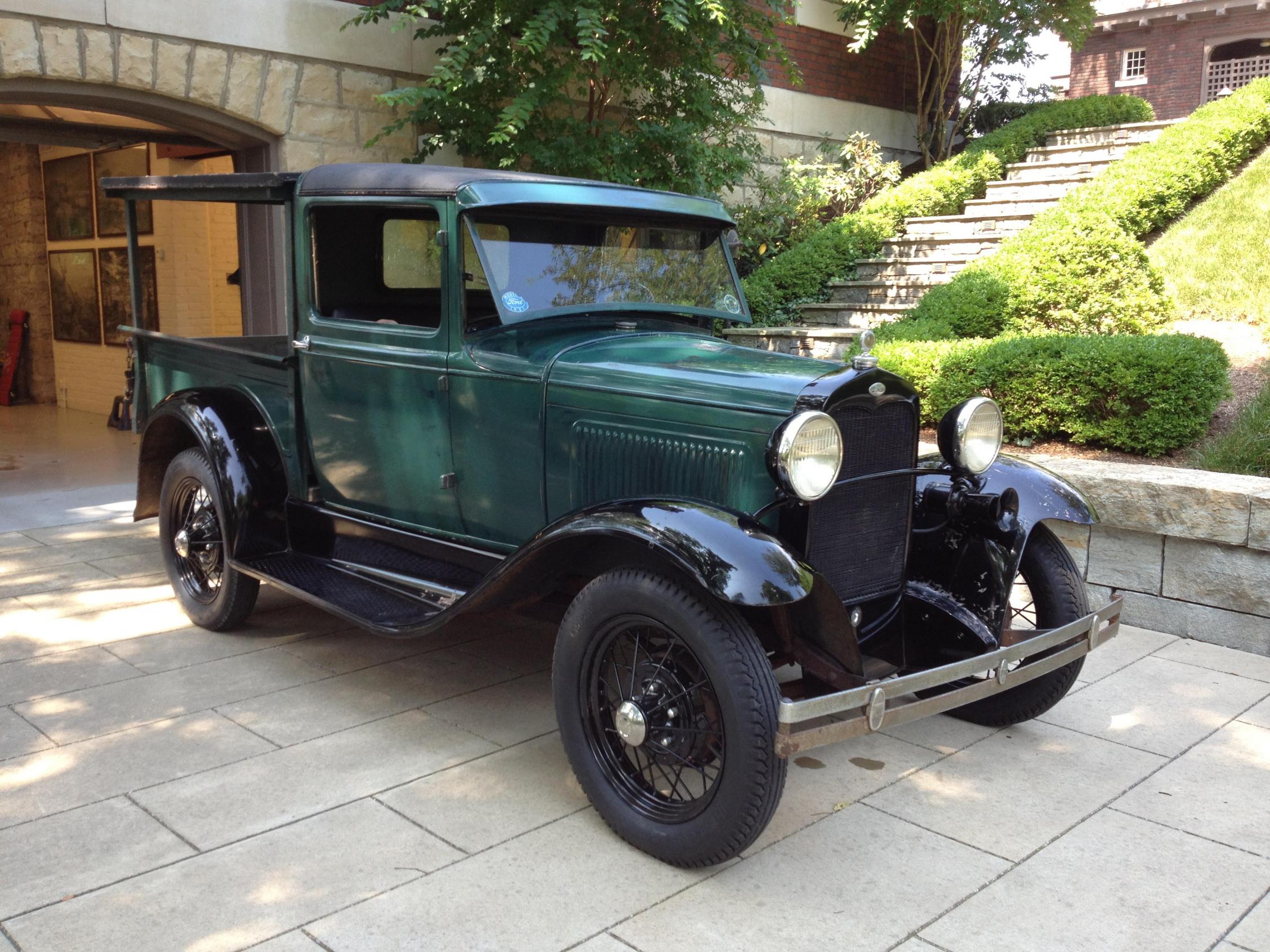

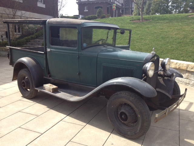

    I agree that CLR and a good heavy coat of yellow wax will do fine. I did this to our A pickup and am very happy with the results.

  7. Both photos are the same truck?,,man that CLR does wonders!:eek: HRP

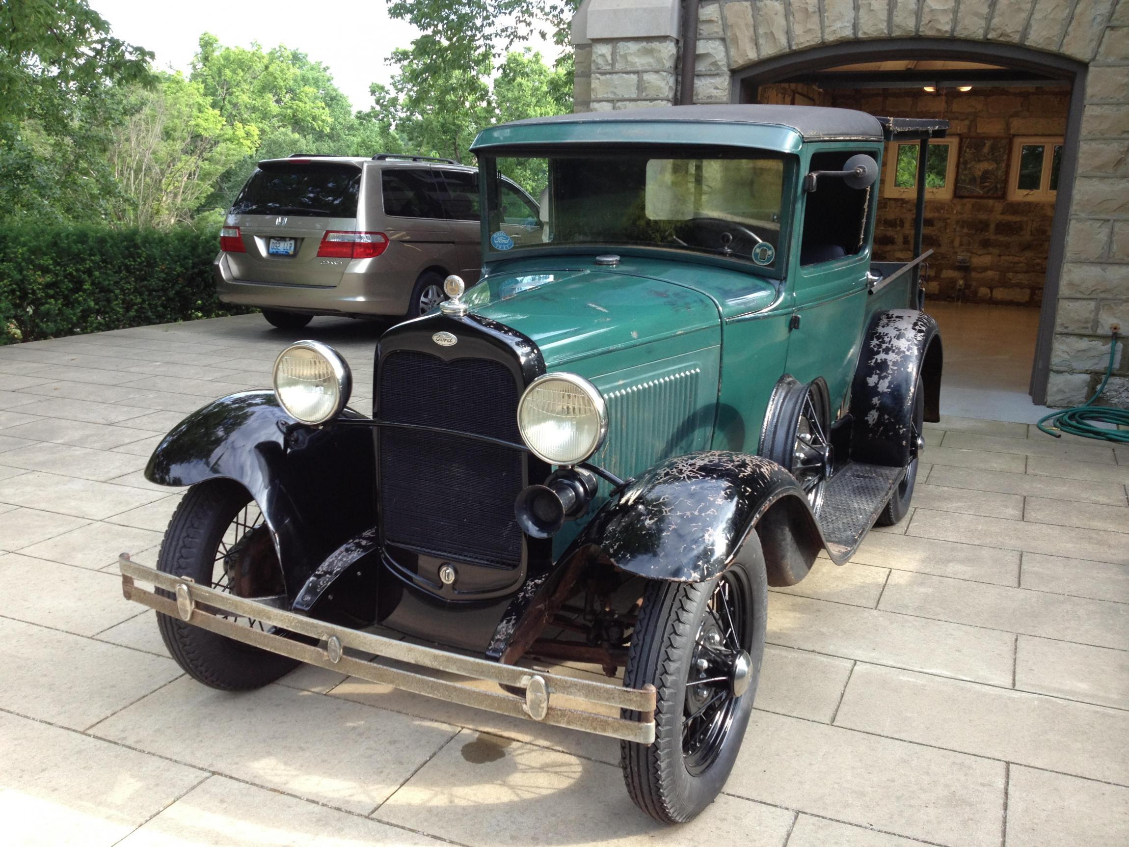

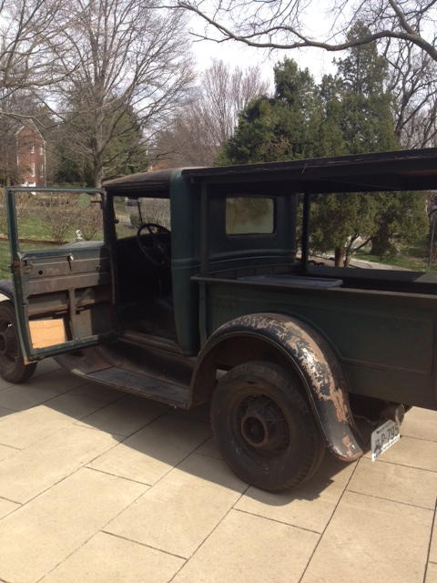

    It does work pretty good at getting the surface rust off. Here are a few more pictures that show the before and after.
