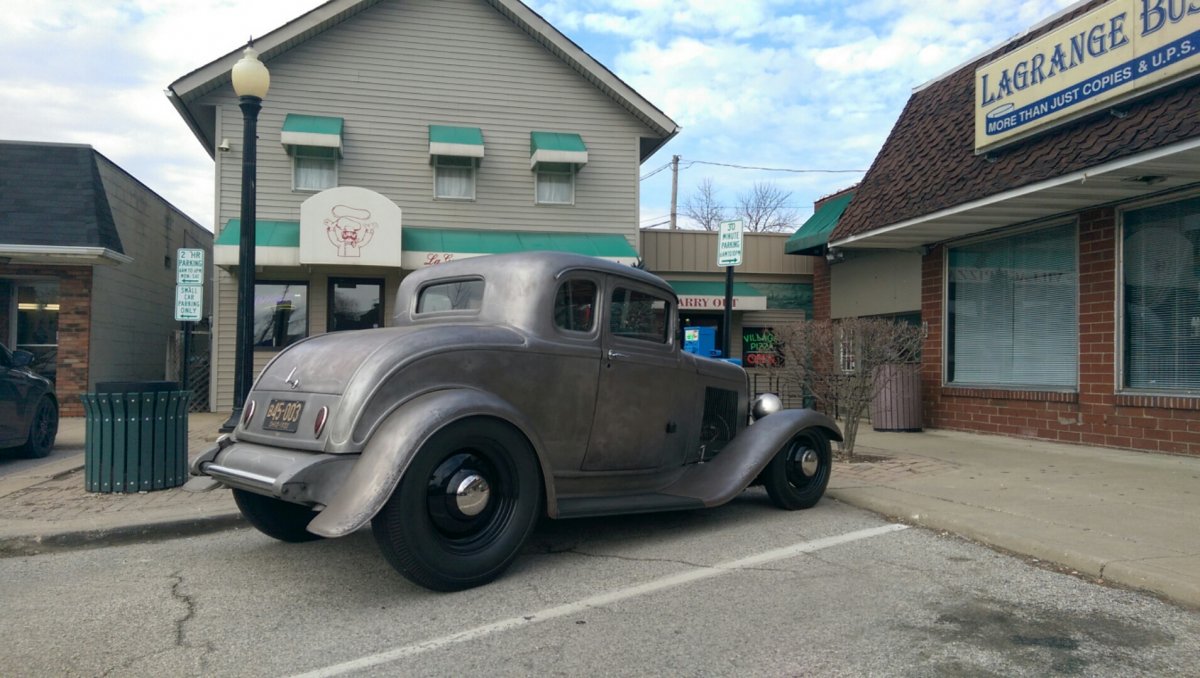

    Don't listen to everyone who says you need to paint it, do what you want. I used a scotch brite pad on mine. I don't have clear on mine, just use a Gibbs oil on it to keep it from rusting, works pretty good. Go ahead you can bash my car now for not having paint as well.

    LOOKS GREAT

  20. HOTRODPRIMER
    Joined: Jan 3, 2003
    Posts: 65,331
    HOTRODPRIMER
    What size wheels and tires? HRP

  21. itsonsucka
    Joined: Apr 26, 2017
    Posts: 30
    itsonsucka
    How could they ??? It looks Frick in wicked . That s one evil lookin hot rod

  23. Bigbangtheory
    Joined: Mar 18, 2012
    Posts: 476
    Bigbangtheory
    from ohio
    HRP 7.00x18 on the rear and 4.50/4.75x16 on the front.
