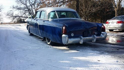

  2. Just for the record. This is the car that is now bare metal, that you are trying to preserve?
