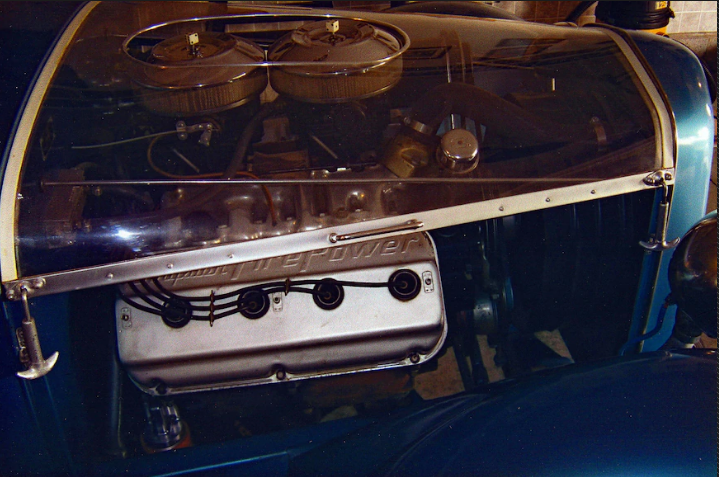

    There was a local 'blue coloured' 32 roadster quite a few years ago at the local hot rod show with a well dressed flathead V8. The owner had fabricated a clear prespex hood, impressive; similar appearance to below. I've no idea what happened to the car and haven't seen it for a long time. A well fabricated buck and some suitable material and you'd be on your way. I've no idea how'd it'd hold up long term to UV light exposure and heat.
