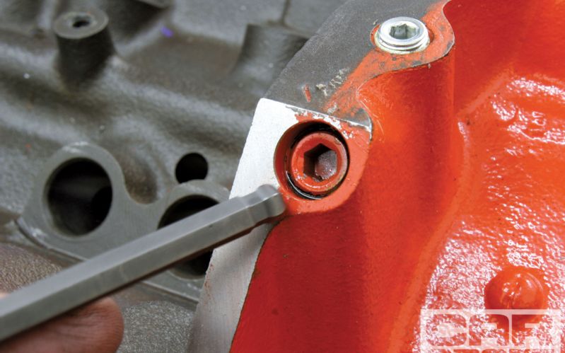

    Is oil on the driver side on back side of head ??
    If so Loose or missing oil galley plug on top of deck block..
    """ Not the one for oil gauge / Light """""
  12. henryj1951
    Joined: Sep 23, 2012
    Posts: 2,304
    henryj1951
    from USA
    eddy ...? this one...?

    from NKy
    Either plug will work oil galley or sending unit , I prefer oil sending unit , because it can be used with valve covers on . Sorry I should not be making comments on GM engines , just not my cup of soup . It that is all that is remaining I'm out of the Hot Rod games ! [emoji851]

    from Downey, Ca
    It's ok. It would be fun to watch you put a fitting in with the head in place. ;) :D
