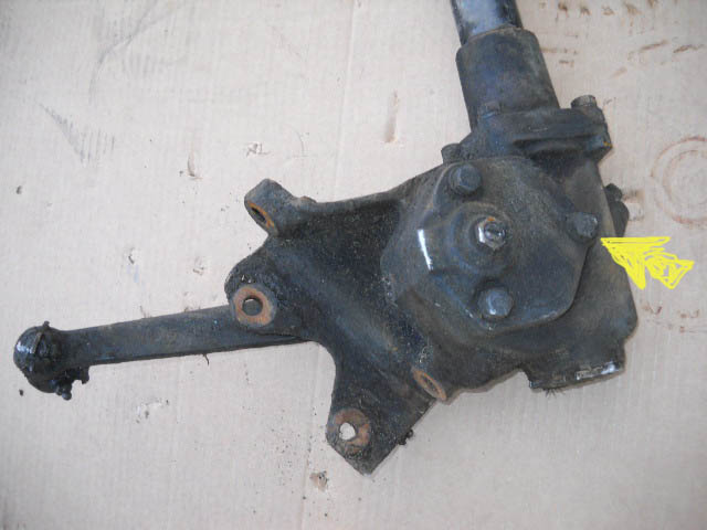

    This isn't a pic of my truck, but the same kind of manifold and steering box. The arrows show where the clearance is worst. The manifold actually has a little spot worn on it there from the motor tweaking over onto the steering box when I goose it. The spot that is making contact is a bolt on the steering box.

    Joined: Mar 18, 2001
    Posts: 5,030
    phat rat
    Have you considered going to full lenght headers? You would likely get rid of the bulk in that spot
  7. Kerrynzl
    Joined: Jun 20, 2010
    Posts: 3,536
    Kerrynzl
    This above
    or face the manifold in a mill
    You could try shimming up the engine mount on one side only to tilt the engine away a little more.
    Washers are a cheap way for trial and error

  9. SpikedLeatherworks
    Joined: Oct 5, 2005
    Posts: 62
    SpikedLeatherworks
    I like that idea on shimming the motor mounts. Never thought of that before. Don't think I will have room to do it with the clearance of the bell housing to the floor pan though. Thanks for a good idea.
