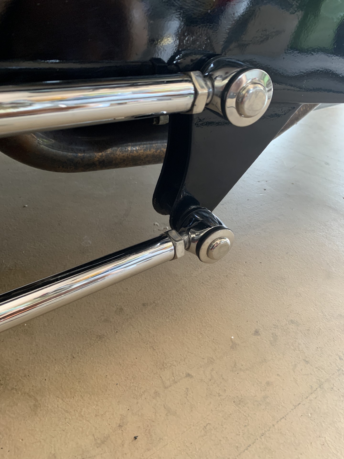

  11. All American 6
    Joined: Sep 25, 2012
    Posts: 284
    All American 6
    Fell out during a drive.
  12. All American 6
    Posts: 284
    All American 6
    I think I've found the pins. Someone that lives in Havasu messaged me.
    I agree that bolts would be safer. I might figure out how to wire tie the pins

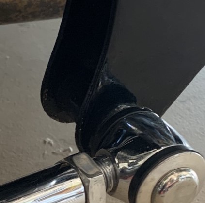

  16. ramblin dan
    Joined: Apr 16, 2018
    Posts: 4,074
    ramblin dan
    I always thought these shoulder bolts with a drilled hole on the end for a safety wire or small cotter pin would be the ticket. OIP.jpg
  17. woodiewagon46
    Joined: Mar 14, 2013
    Posts: 2,525
    woodiewagon46
    from New York
    Question, in post 15, shouldn't the bushing be sandwiched between the two mounting plates? It looks like yours is only grabbing one side. If so, you are asking for more trouble, that's a very weak way to attach it.

  18. lake_harley
    Joined: Jun 4, 2017
    Posts: 2,419
    lake_harley
    In my opinion Andy in a post above has the answer. I think the bushed end should be sandwiched between the four bar brackets and clamped tight with a bolt and nut as he suggests. The flex in the four bar is in the rubber or polyurethane bushing, not the center metal bushing floating on the bolt.
    JMHO.
    Lynn

    Am I mistaken that these should not be mounted this way? thumbnail_IMG_3271.jpg
    alanp561 and Johnny Gee like this.
  23. tomcat11
    Joined: Mar 31, 2010
    Posts: 1,141
    tomcat11
    You are not mistaken. Obviously intended to be double shear.
  24. Ebbsspeed
    Joined: Nov 11, 2005
    Posts: 6,479
    Ebbsspeed
    It appears as though there is a sleeve welded between the two halves of the 4-bar mount. Odd setup....
    gimpyshotrods and All American 6 like this.

  26. chickenridgerods
    Joined: Jul 22, 2003
    Posts: 1,548
    chickenridgerods
    from DSM, IA
    That is a common method of mounting the rear joints of a 4-bar linkage.

  28. oldolds
    Joined: Oct 18, 2010
    Posts: 3,635
    oldolds
    When they talk double shear they want the end to be between the brackets. That way it would have to break the bolt at two places to fall apart. The way it is now the bolt only has to snap at one place and it will fall apart. I have seen a lot of set ups each way.
    The compe***ion guy like the double shear because of the abuse. Street driving you should be fine.
  29. All American 6
    Posts: 284
    All American 6
  30. GuyW
    Joined: Feb 23, 2007
    Posts: 813
    GuyW
    Yes - in other words, the double shear is at least twice as strong as single shear. For any application where significant loads exist or "disaster upon failure" could occur, double shear is the only answer....
