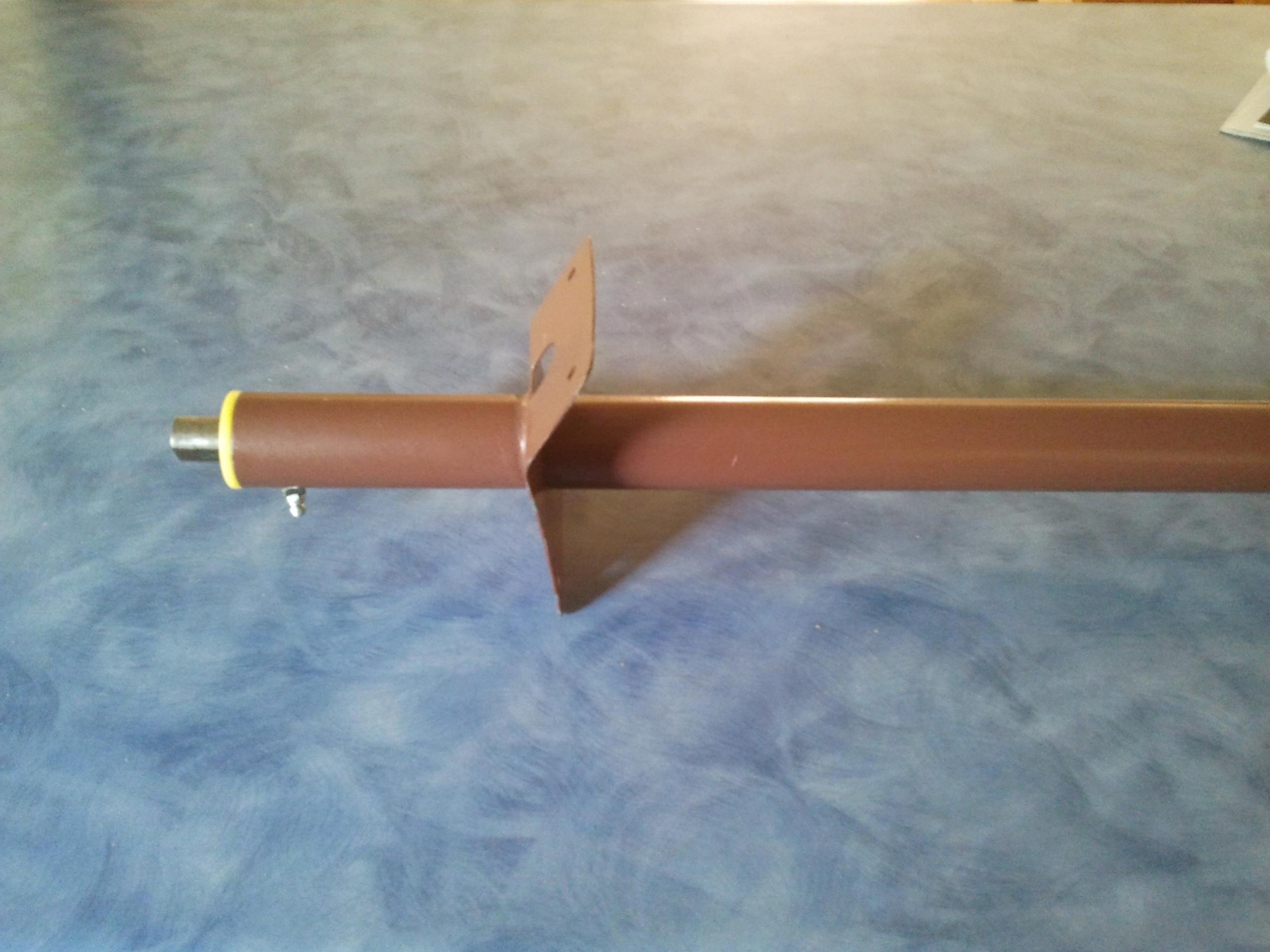

    mgtstumpy
    Cut OEM column where it goes into engine bay, machine a nylon block, add a grease nipple fitting and a small 1" ID roller bearing to it. Nipple holds block in end of column. Machine a 3/4" DD end to shaft and a small collar to hold bearing, weld collar to shaft and add a floor plate to column base. I just need to machine a small groove for a cir-clip at base of nylon to stop movement in shaft. Whilst at it, replace upper bearing. Done. Might be a bit overkill for some folk but works for me.:)
  21. the-rodster
    Joined: Jul 2, 2003
    Posts: 6,959
    the-rodster
    Very nice solution.
