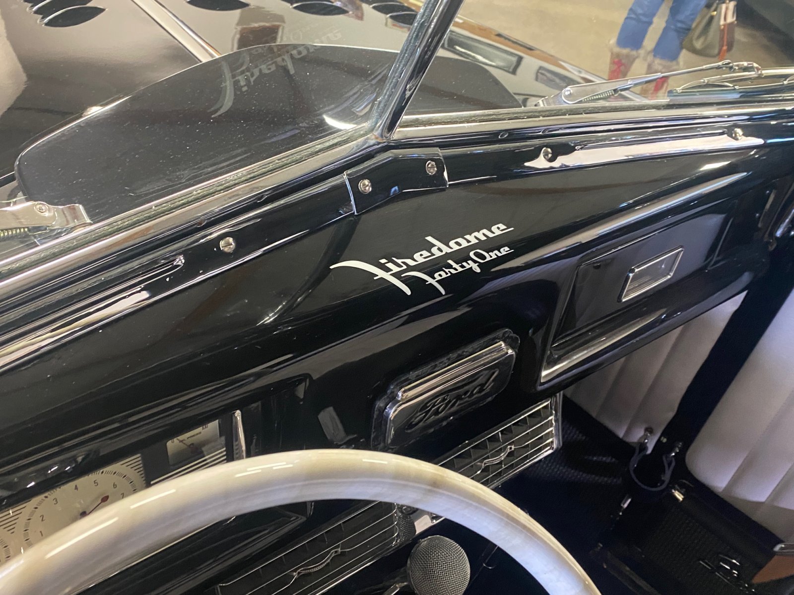

    This isn't a good picture but I can't be bothered. I had Cl***ic Instruments paint my clock to match the cluster and install new guts and lights. I don't know why I bothered, I turn off the battery switch at night, the clock has never had the correct time on it and likely never will.
    vtx1800 likes this.

    Correct. CI installed an electric movement and LED lights to match their cluster. I could install a battery back up that plugs into the power port under the seat but the clock was more of a design feature for my build than a time piece.
    ClayMart likes this.
