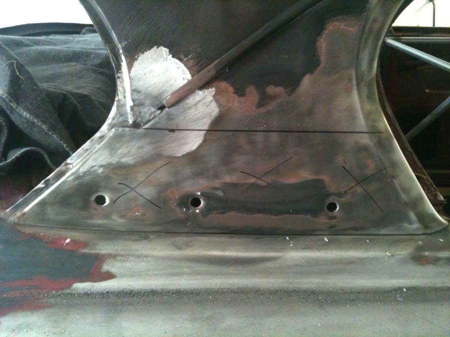

  28. PeteFromTexas
    Joined: Apr 4, 2007
    Posts: 3,837
    PeteFromTexas
    Factory lead out in the C pillar. We now see the factory line where Barris decided to cut. Makes our job much easier. A total of 3 3/4 inches is coming out of the back.

  30. PeteFromTexas
    Joined: Apr 4, 2007
    Posts: 3,837
    PeteFromTexas
    Barris had claims of chopping the car 4 and in some places he claimed 5 inches. It now is very apparent that the top was brought down an equal amount of 3 3/4 inches all the way around. The A pillars are 4 7/8 but 3 3/4 vertical.
