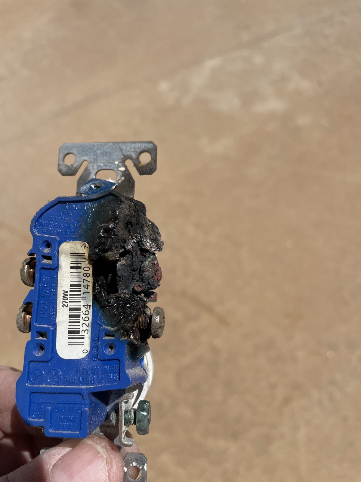

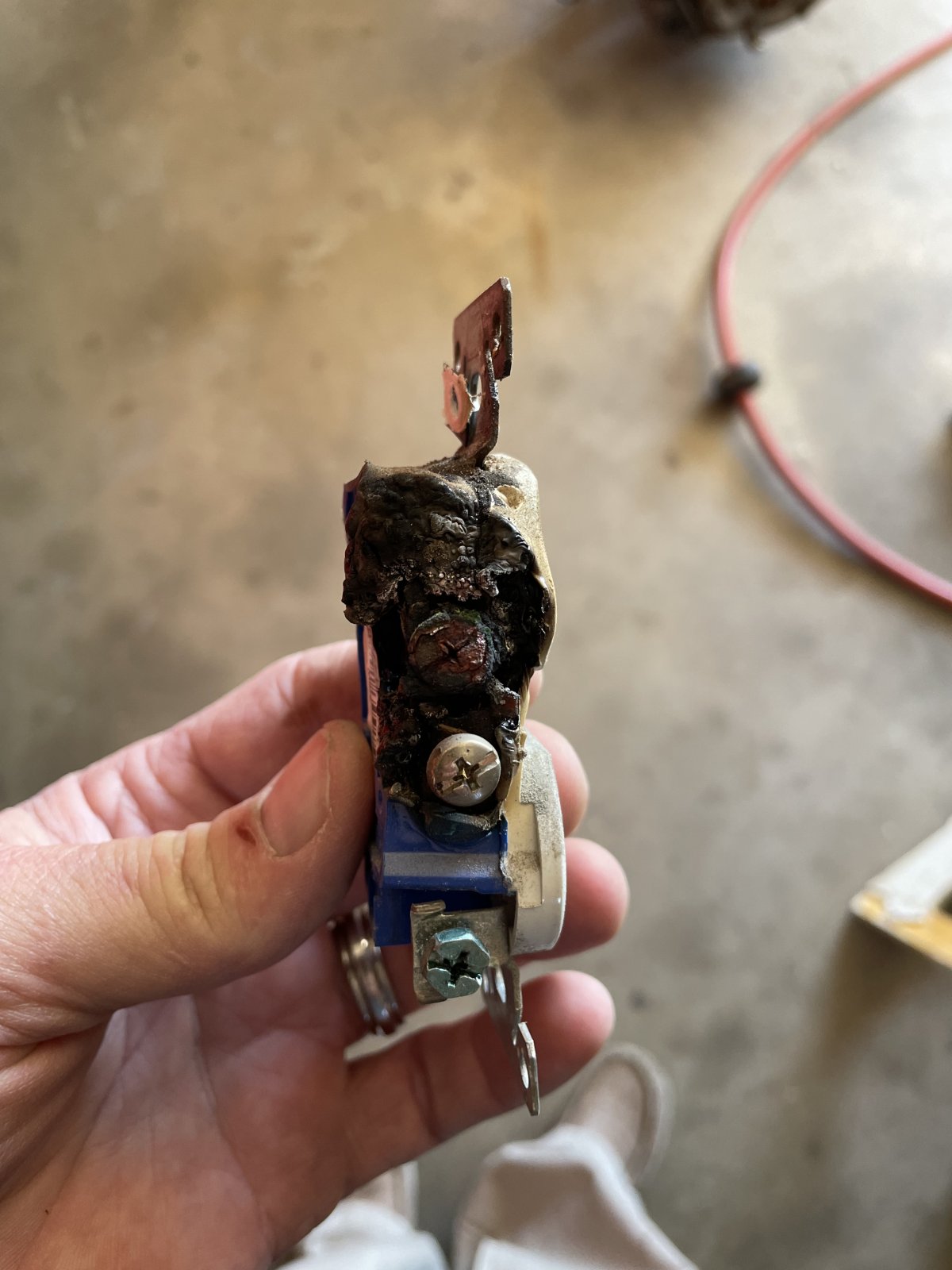

    My brother had this happen in his kitchen, his electrician buddy said do not use a phillips screw driver on those connections, that screw is made for a flat screwdriver to get them tight enough.

    It won't hurt to do a total inventory on all the outlets. I'm changing all the receptacles and converting to pigtails. I'll also incorporate all the info I pick up from this thread. No one wants to come home to a pile of smoldering hot rods.

    IMO, 15A recpts are fine on a 20A circuit. They are all rated at 20A p*** thru but only 20A are rated to draw 20 at a single yoke. I've opened up both and have seen no difference except for the slots. Nothing wrong with 20A, just not needed unless you need to draw full rated circuit load from a single yoke.
    Pigtails are the way to go though. I only have a few 20A in my shop and those are only because my MIG has a 20A plug so I needed a few places to hook it up.
    My choice for recpts are the back wired that use screws to apply pressure on the wire, not the little spring-loaded back stabs. They don't loosen with load cycling like those with wire looped around the side screws and are much easier to tighten correctly too.

    That's why the screws are on the duplex, nothing wrong with using them, it just depends on what's going on downstream as it's pulling amperage through the unused outlet. I use the screws, always have, and all of my stuff p***es inspection with flying colors. Just a basic understanding of electrical theory goes a long way. Somebody already said it, but tightening the connections is important. Very important.

  19. That was no doubt a local code. The NEC is surprisingly minimal on residential requirements. When I first started in the trade, all that was required was 3 watts per square foot for 'convenience' outlets and that included lighting. #14 wire was acceptable for any of this. Then they started adding additional things; you should never be more than six feet from an outlet on a wall, dedicated circuits for kitchen/laundry appliances with minimum current ratings, etc, etc. But that minimum core requirement of only 3 watts per square foot is still there AFAIK. Most AHJ (authority having jurisdiction) would adopt the NEC then modify it to suit local conditions or experience. You could have a state code, along with counties and cities adopting their own versions. It can get confusing! Get a dipstick local inspector with personal 'novel' interpretations it can be a nightmare....
    Those look like residential grade to me. You will find four types of wiring methods on these; stab-in only, stab and side wire, side wire only, and side and back wire. I personally avoid the stab types even if they have side wire. Don't confuse the back wire with stabs, those retain the wire with a screw/clamp arrangement. And if installing these in a shop environment, I'd recommend using outlets/trim plates made of nylon as its much less prone to breaking. And while many of these can share the same basic internal yoke design, the higher grades can have extra springs for better clamping to the cord cap blade.
    And I'll be a bit of an outlier on GFI and arc fault protection. While both of these have their place, they can generate nuisance tripping in a shop setting. Arc faults don't like brushed motor loads (unless they've improved them) as they can 'see' normal brush arcing as a fault. Excessive resetting of either type can cause them to fail.

    I don't KNOW, but I'd logically have to question this. It would seem that one factor of tightening would be the amount of surface to which you would be able to apply the force of tightening. I picture twice as much loading surface available with a Phillips as a flat blade. Even considering that the bottom of each Phillips surface is tapered vs the flat bottom of the single groove, I can't imagine it's less.
  22. Yeah, that's BS. You shouldn't be tightening them gorilla-tight in any case, those are only 10/32 screws. I've installed hundreds if not thousands with a phillips...

    If you look at it, it's not a phillips screw.
  24. could be an older outlet, I've seen many that aren't Phillips.
    personally, i prefer to use my wide blade flathead screwdriver until its tight, with about 6-10 inches of extra, then you accordion it back into the box., pigtails on the wires unless its for a GFCI, then only for ground.
