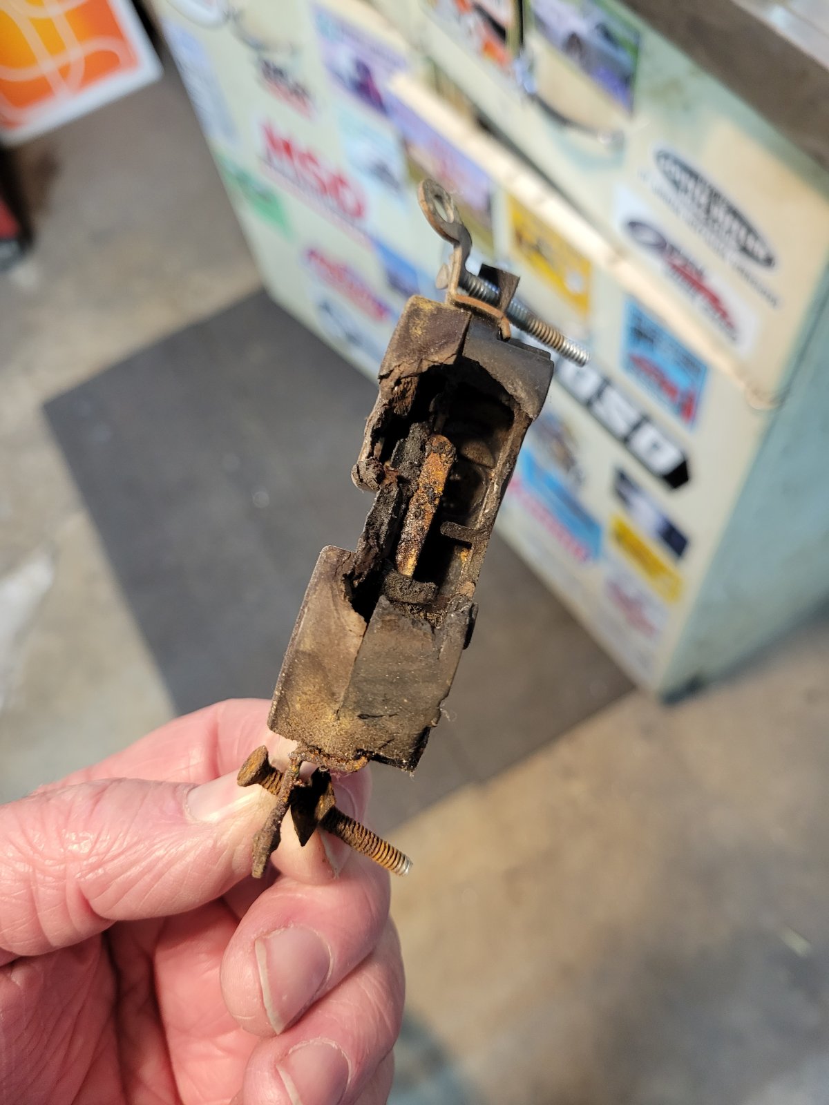

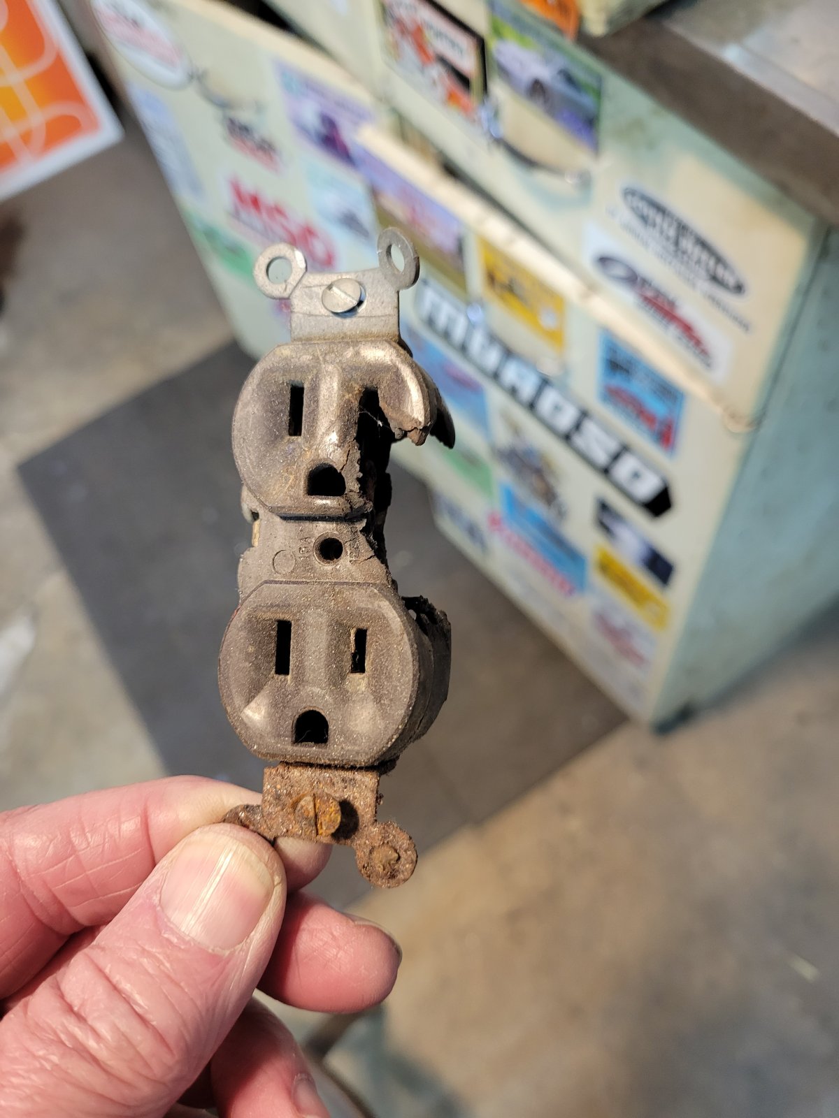

    I had that same thing happen, had a fake neon clock plugged into it, the clock didn't even work just lit up, I was redoing the wall and found it.
    Like you no 15 amp breakers tripped, my electrician buddy explained it as a ground issue that slowly heated the plug over an extended period of time.

    I don't ever remember seeing an outlet that rusty in an indoor situation ?

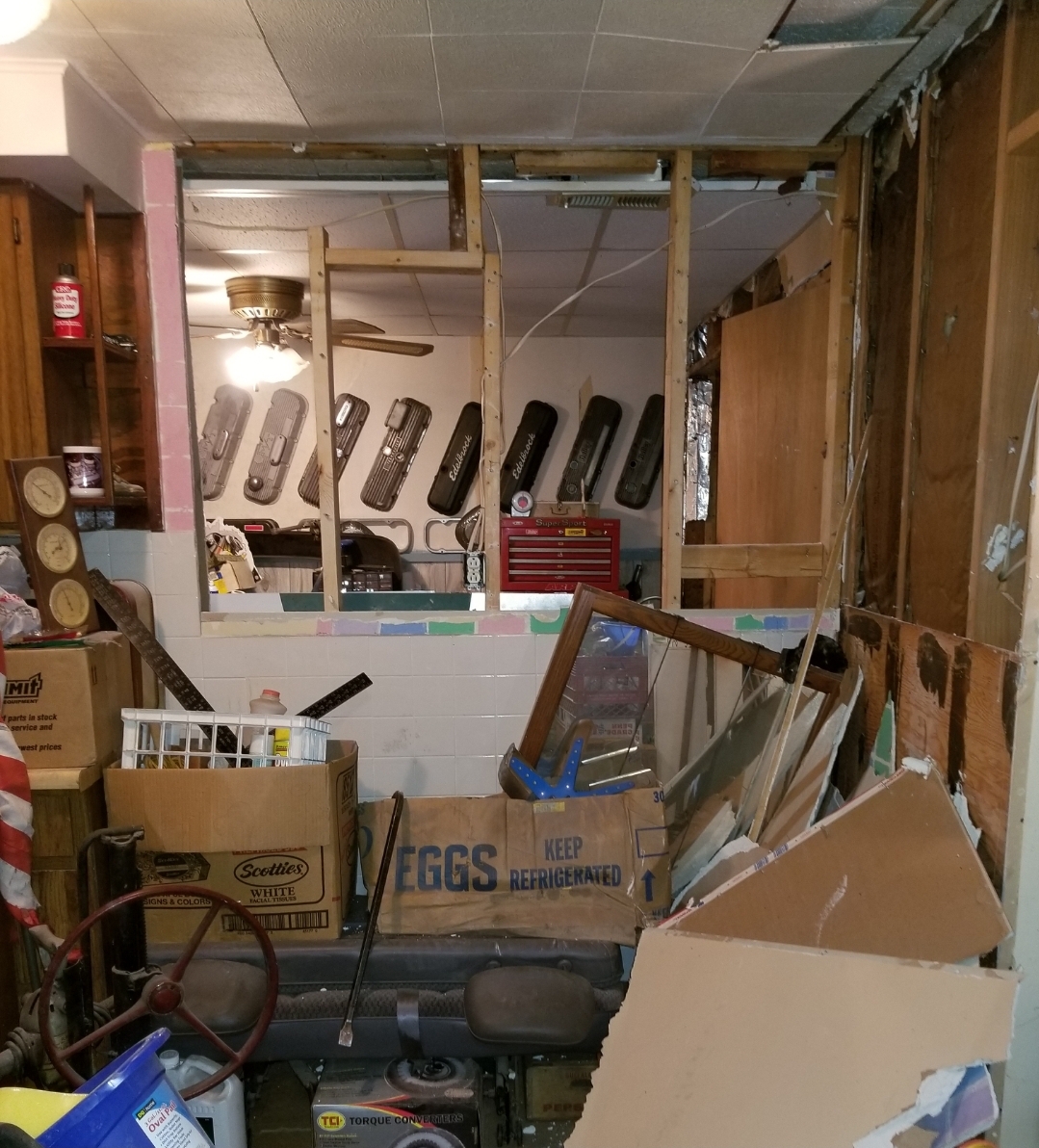

    This garage leaked like a sieve when I bought the place even though it had 7 layers on the roof and 3 different stacked ceilings, there was a one bedroom apartment built inside that soaked up the moisture, hence tearing the wall apart.

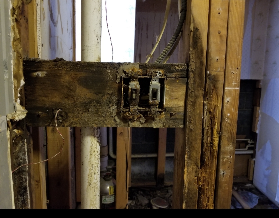

    That was nothing as compared to a wall that held a couple dual light switches and doorbell.
    Look at those studs, what is supporting what lol

    If that is a load bearing wall.................:eek::eek::eek:

    No **** eh, thankfully it wasn't, no idea how they got it past code to qualify as a multi-family, I gutted it and made it a usable heated work area and returned it to single family.

    That burn out is actually on the hot side of the plug. The Neon tube on the clock must have had a transformer to illuminate the neon tube. It is probable that the transformer current caused weak connection on that side of the receptacle to heat up and cause the burn out. The history of moisture contacting that device didn't help any either.
