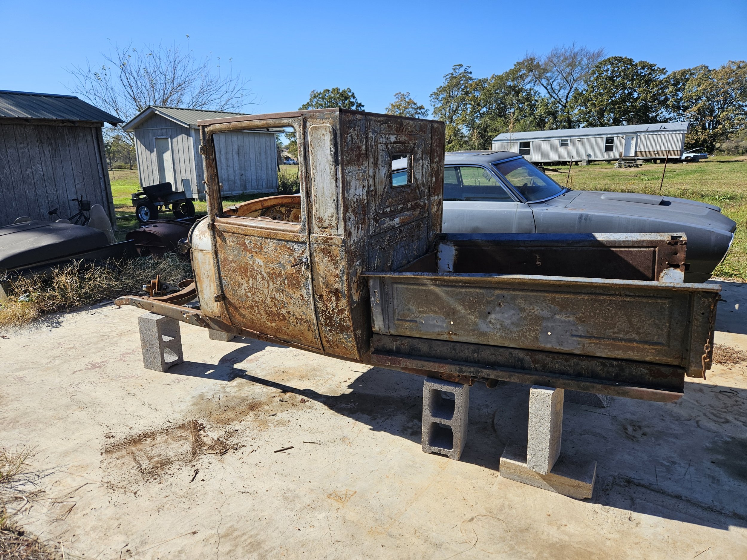

  1. 20241115_110833.jpg got my 29 mocked up, decided against Chopping it for now, really want to do a late 50s early 60s style hot rod, not going to channel it I like the highboy look, I have a 57 283 engine and transmission and a early 60s pontiac rear end, 34 for drop front axle, here's my questions to the guys doing traditional hot rods #1 how do I mount the rear axle? #2 do I need to remove the middle crossmember from the frame? # Will I need to recesse my firewall. I'm keeping my points distributor and the sagnaw 3 speed, really want to keep flat plywood floors if possible and I have a set of 48 ford rear radius rods if like to use to mount the rear axle can someone tell me what spring set up to run? I want it low as I can get through the suspension without stepping up the frame or channeling the body and still keep it looking traditional.

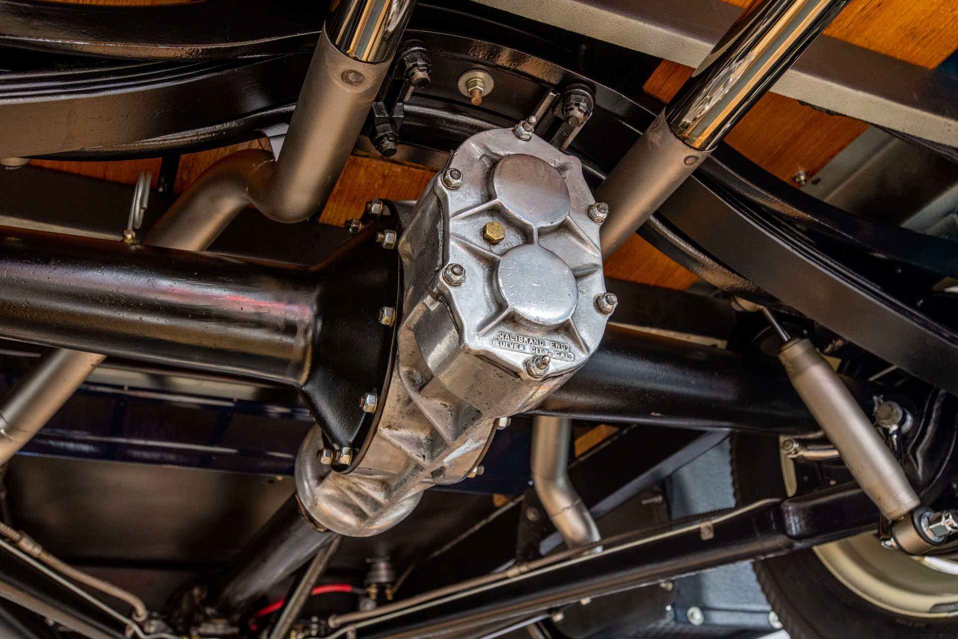

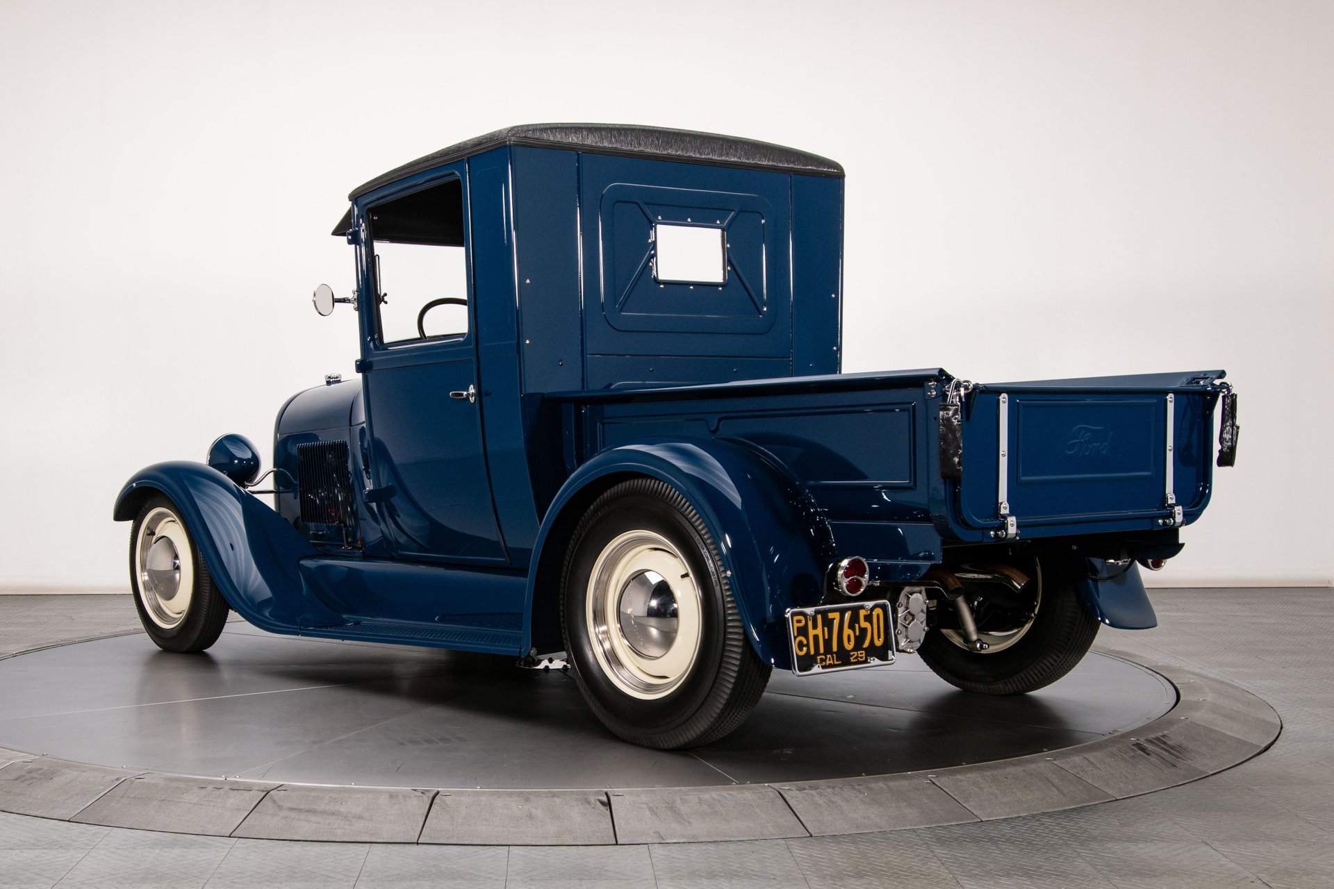

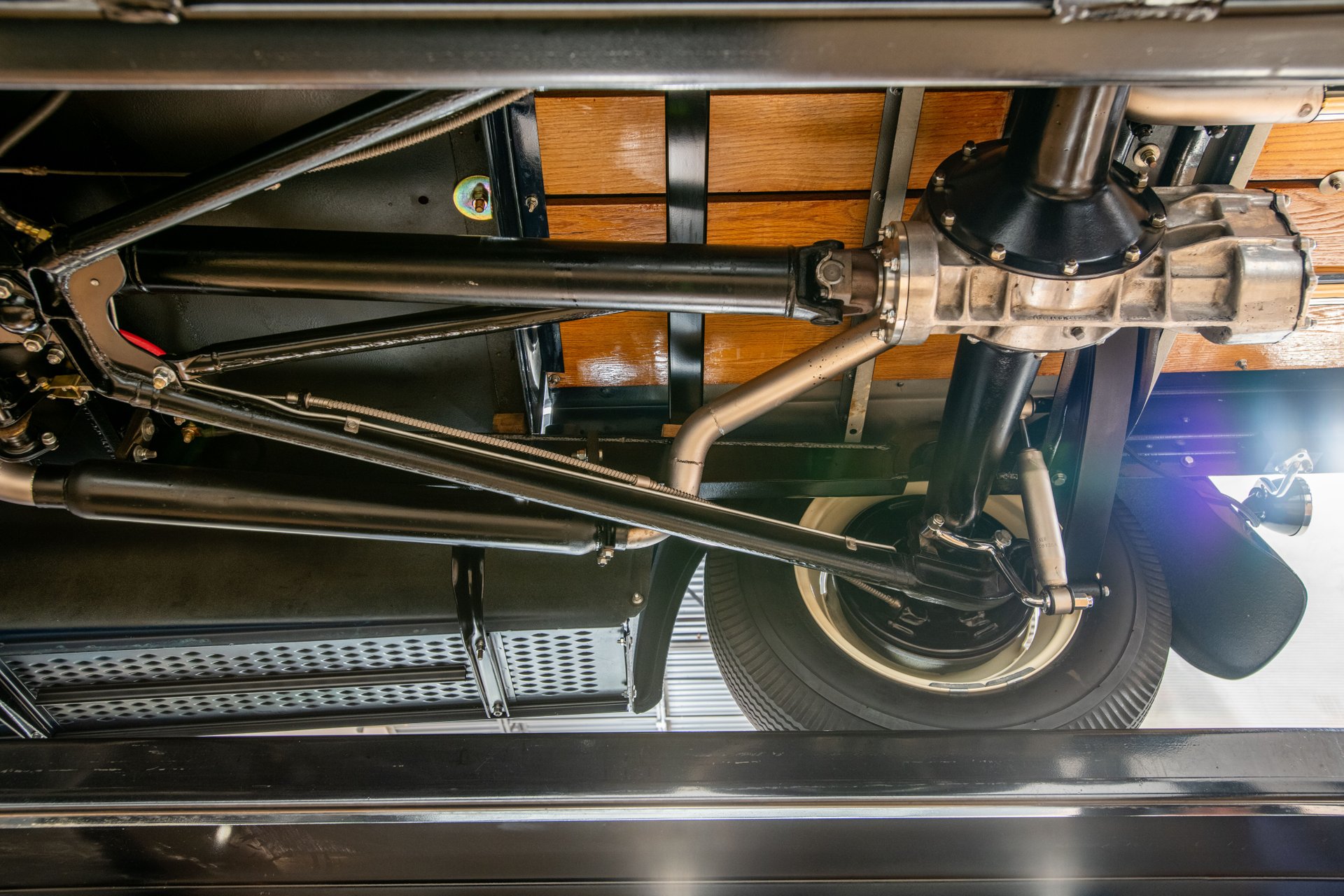

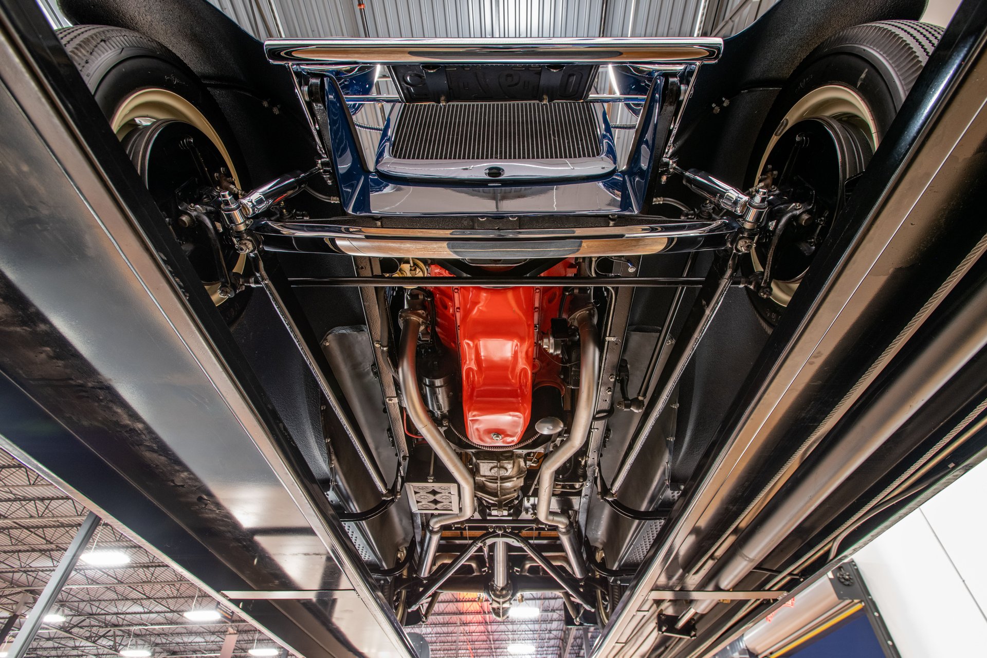

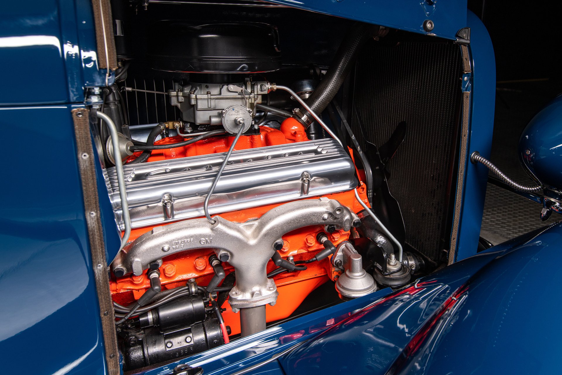

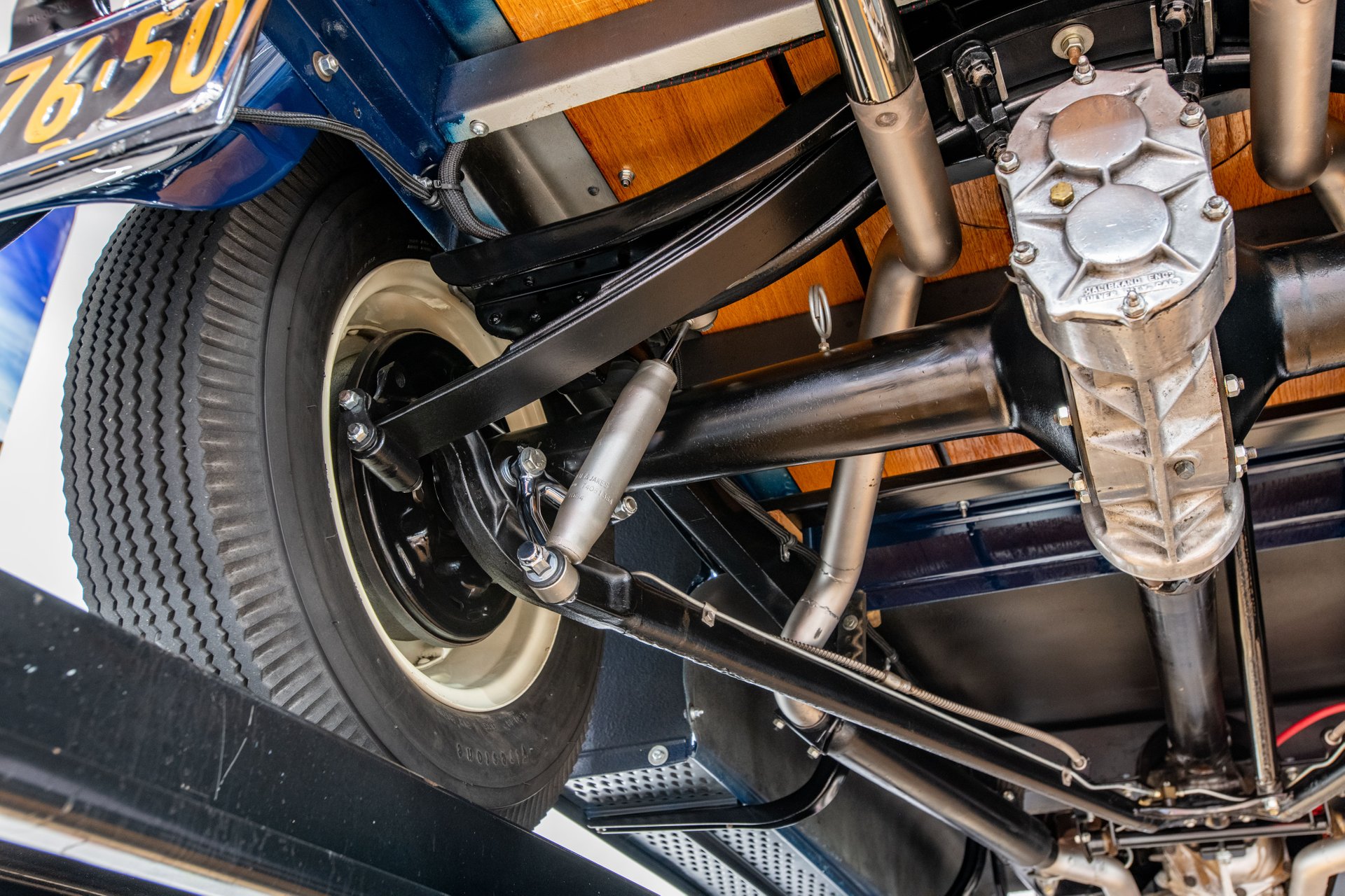

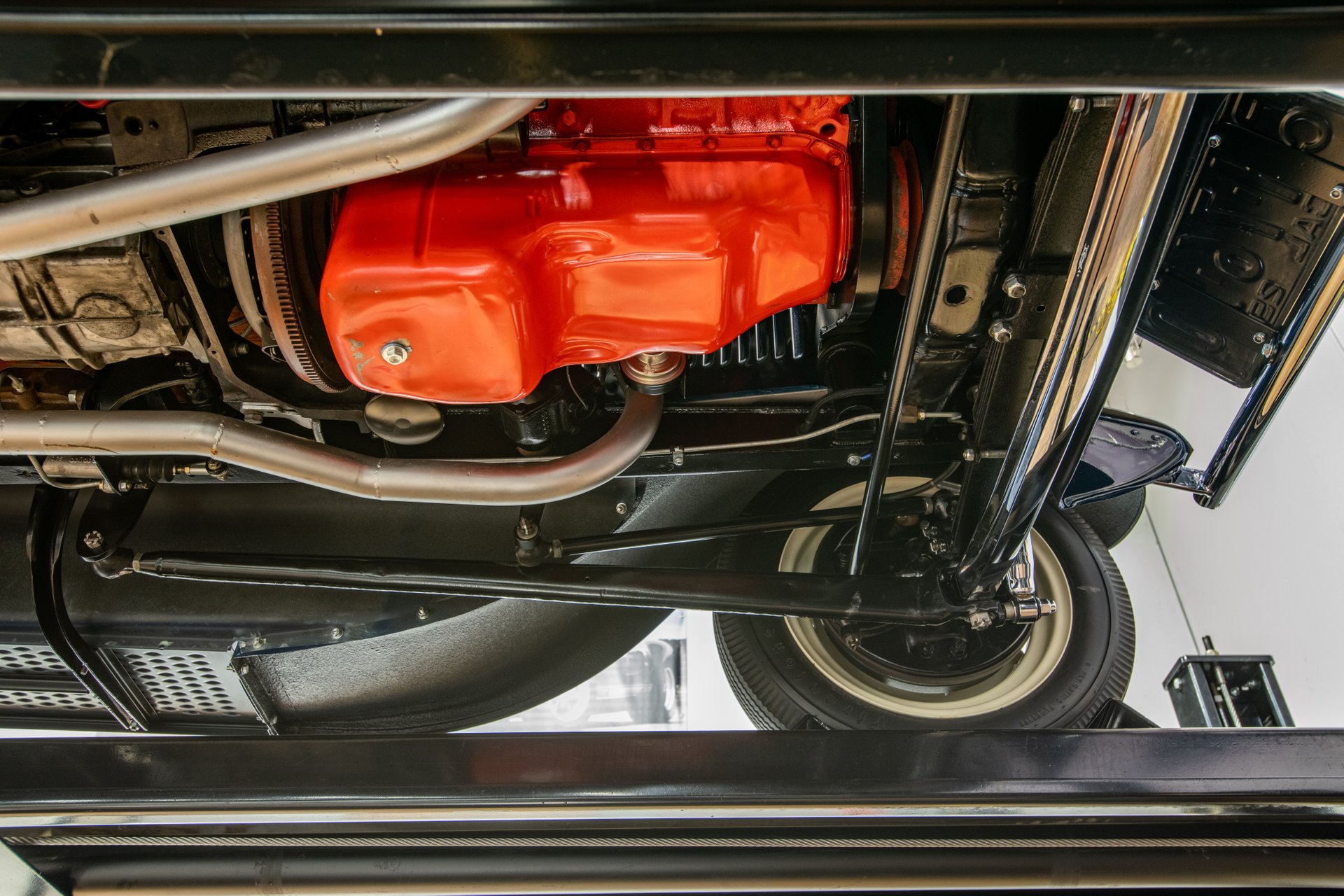

    I did build threads on mine. Click on threads by me.
    IMG_1309.jpeg IMG_1308.jpeg IMG_1307.jpeg IMG_1306.jpeg IMG_1304.jpeg IMG_1303.jpeg IMG_1302.jpeg IMG_1301.jpeg IMG_1299.jpeg

    Mock up, mock up, and then mock up before you cut or weld.

    WOW! I like that cab & bed you are starting with. The finished truck badshifter posted needs close study, like the '36 rear radius rod use for a lowered rear, note that the ch***is needed to be lengthened to keep the wheels centered in the fenders. I'm off to read the build thread, thanks! Bob

    Your windshield header, and windshield frame appear to be missing.

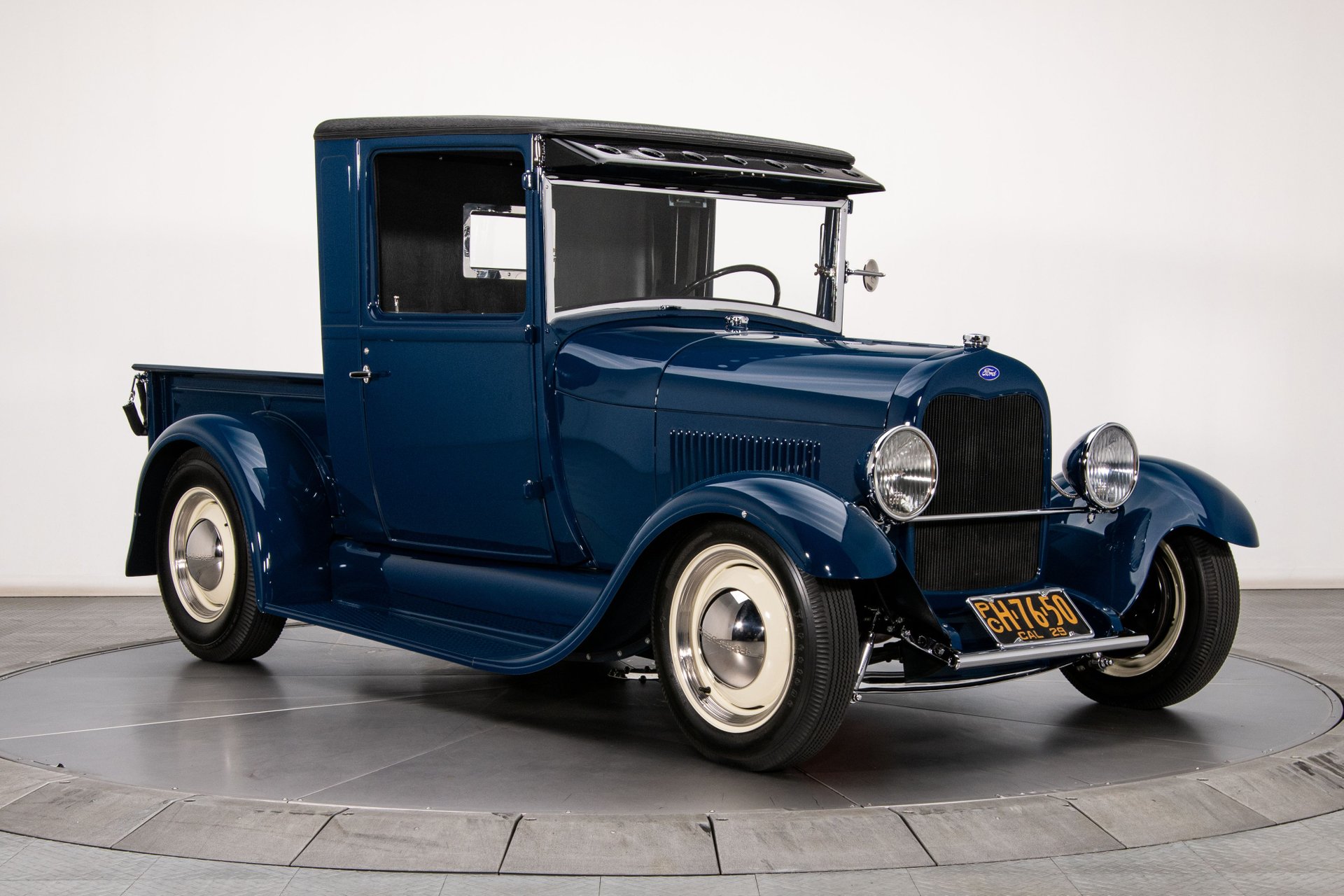

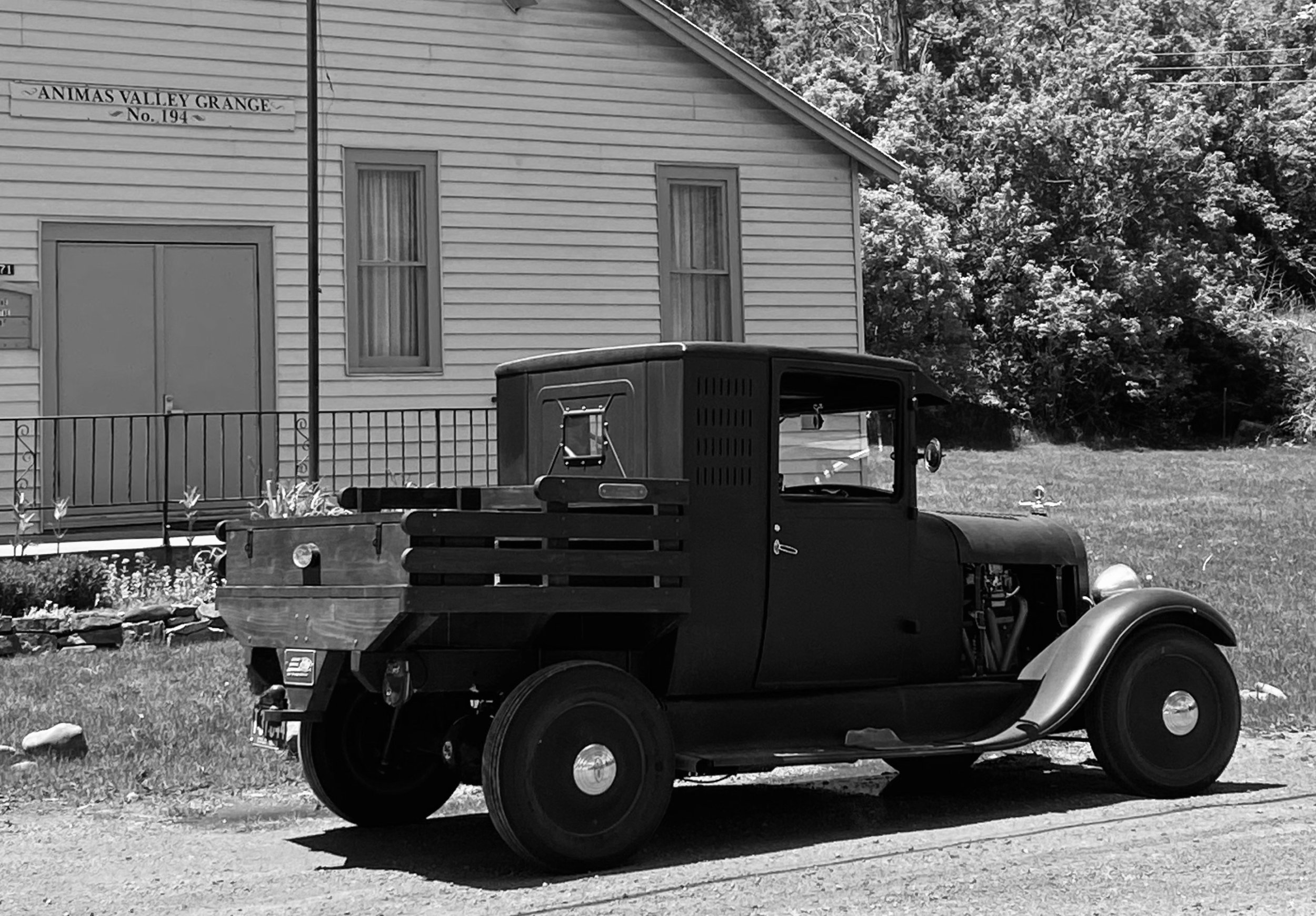

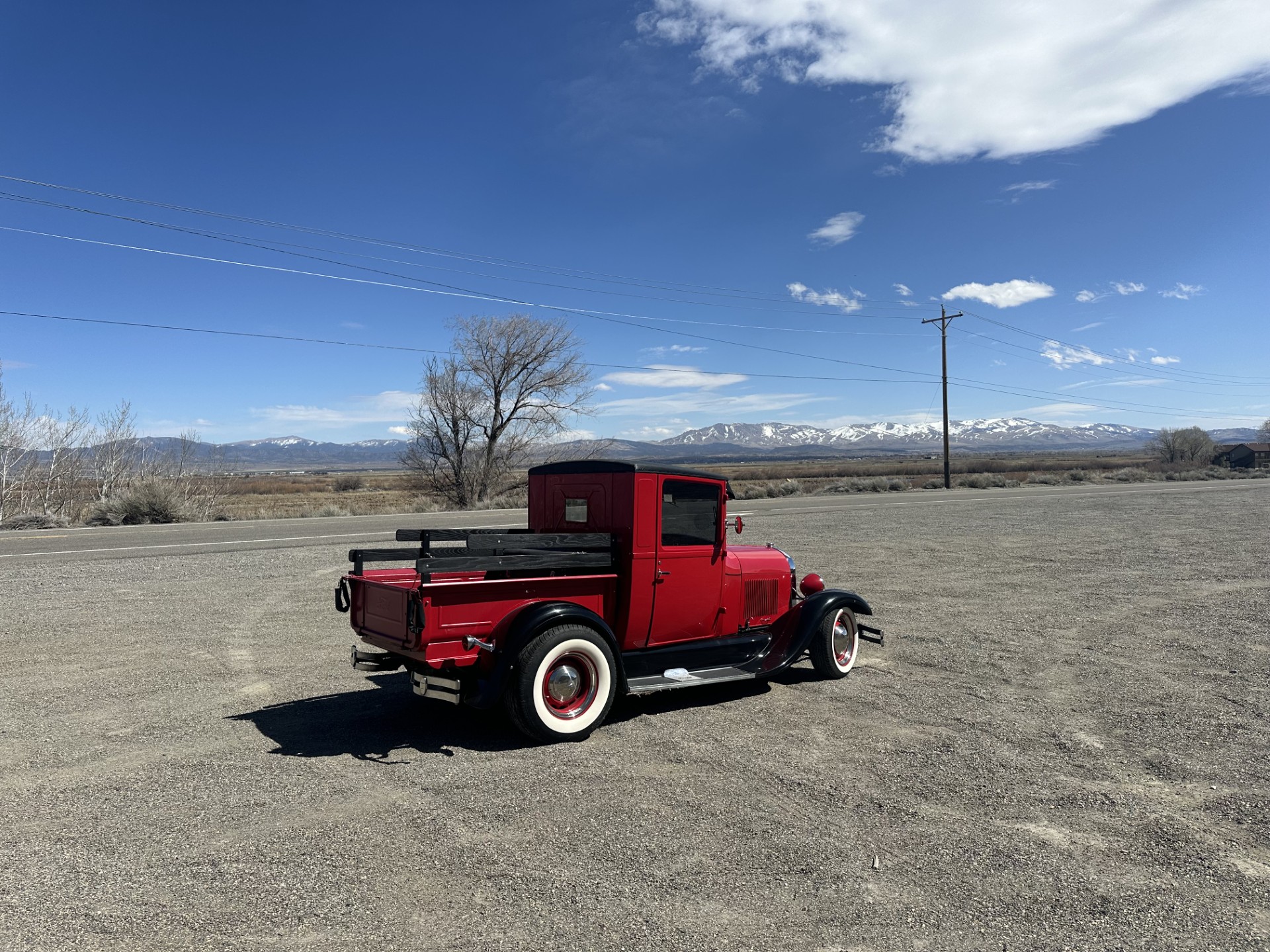

  16. I've got a '29AA. I will fabricate an express bed for it, which is only about 12-13 inches high but low and long. Stock express beds are rare but look just right on those heavy frames.
