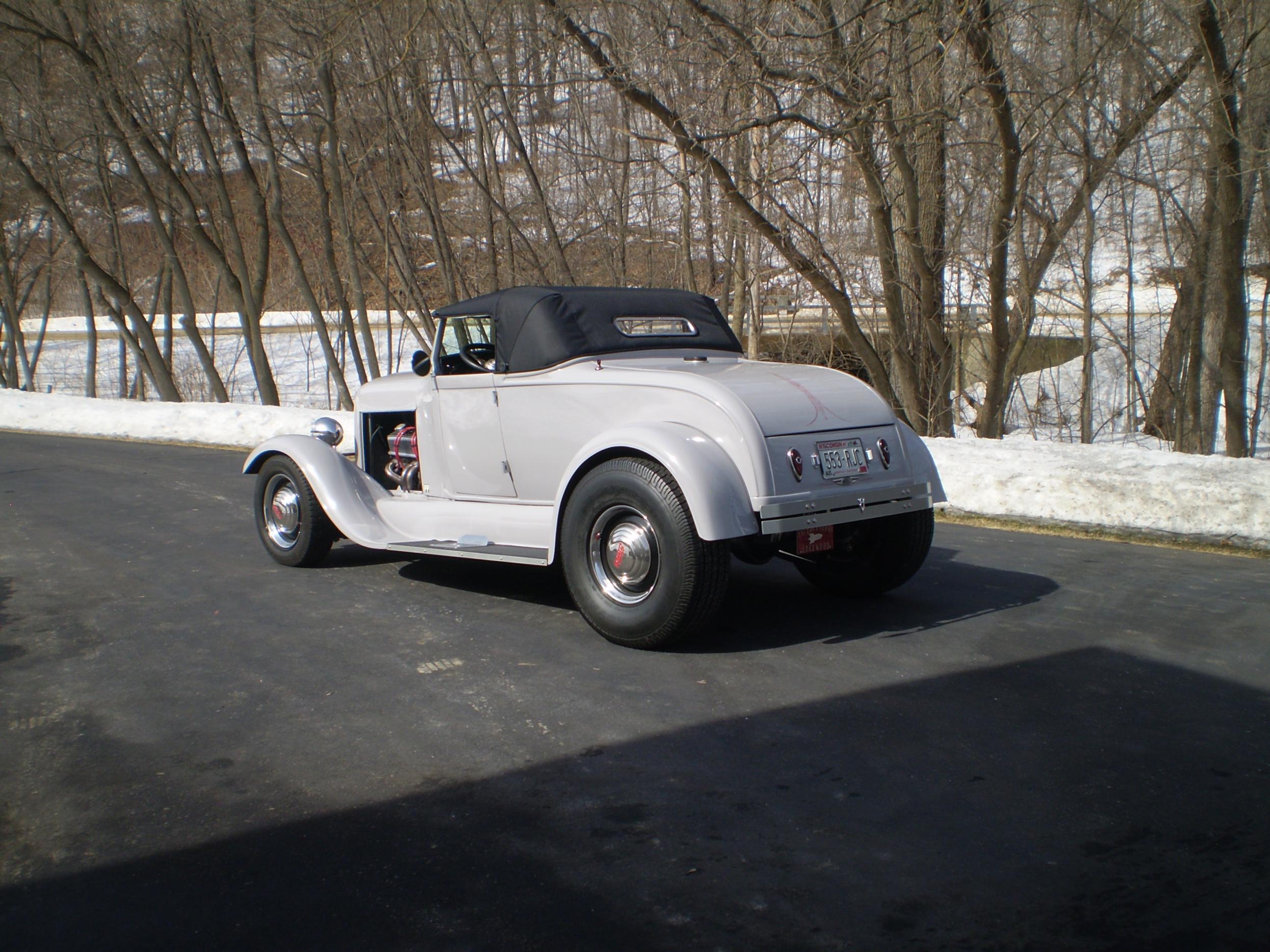

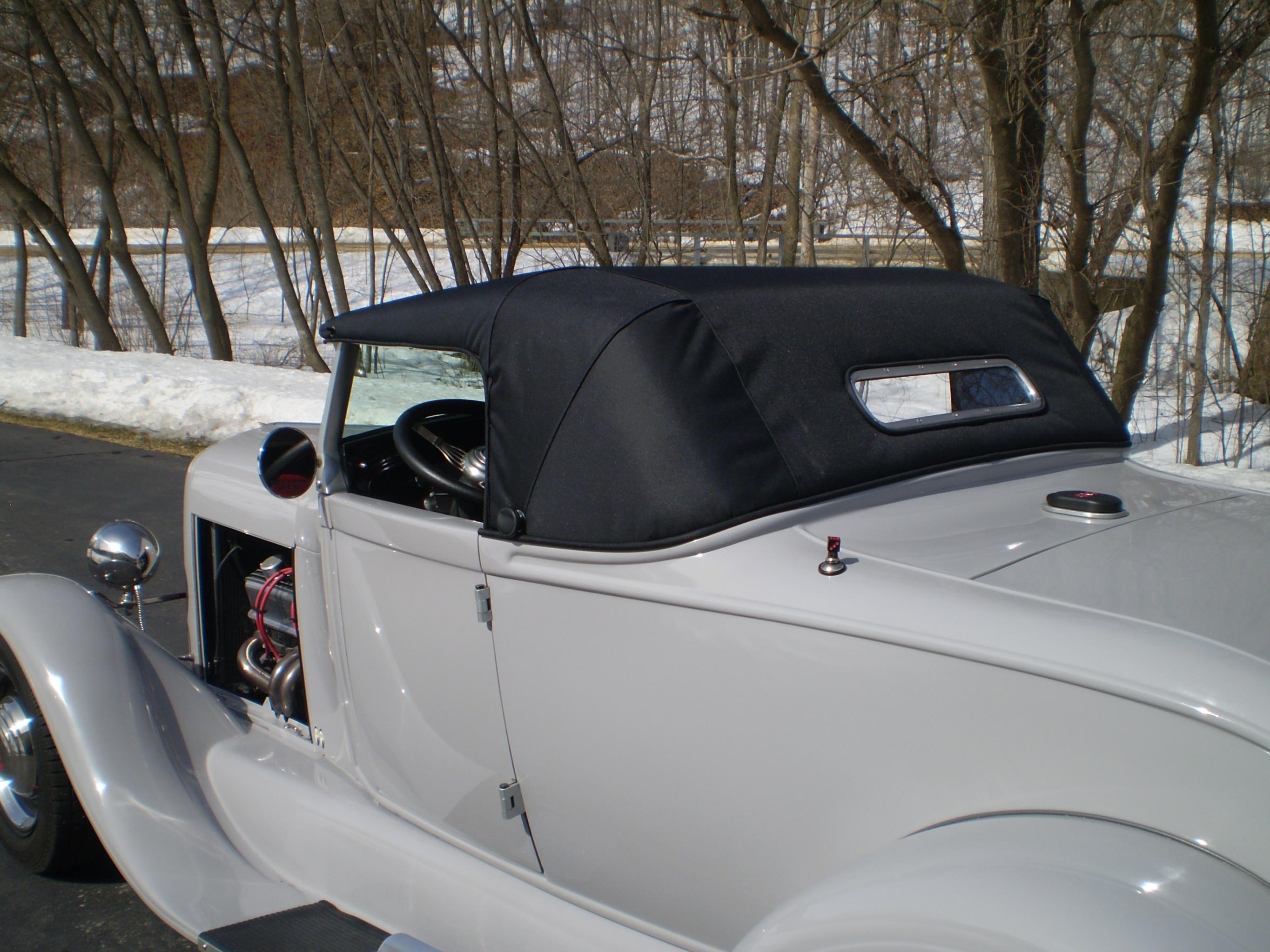

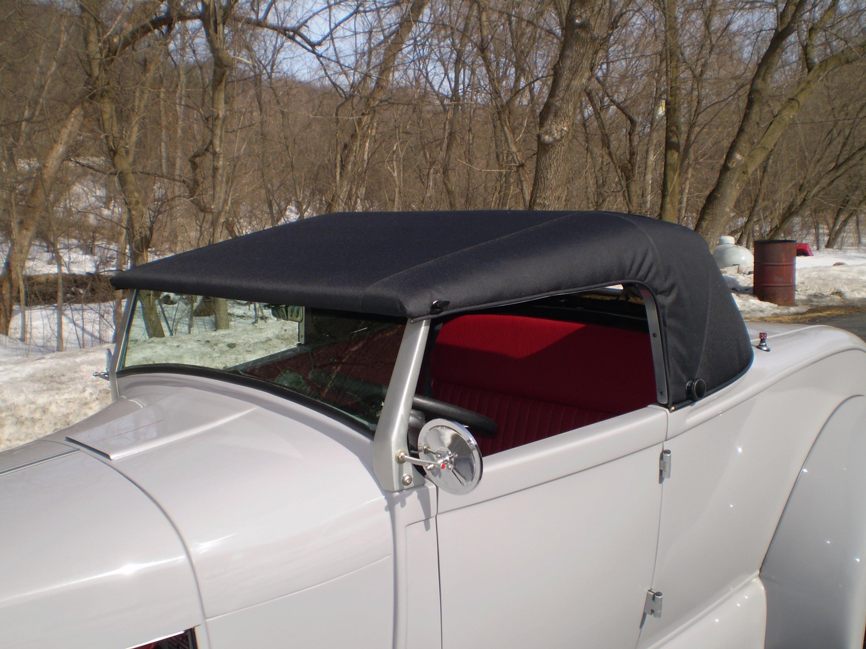

  1. Well, I decided that I've talked about how I was gonna get my molded fibergl*** top covered to look more like a roadster top should. Well after getting two estimates to have it covered I decided to save some money and try it myself.
    I started out with a Goodwill ten dollar 1934 Percision Deluxe Sewmore sewing machine. Nice heavy duty machine. Then I found some outdoor material used for awnings and umbrellas, $10.00 per yard, bought 3 yards.
    I cut the center piece first, then laid out the side pieces, sewed the 3 side pieces together and then sewed them to the center piece. It took some trial and error but all and all it came out pretty good. It's even got a few puckers in it just like a real cloth top:eek:. I'm all done for under $100.00 and that's about $650.00 less than the cheapest estimate I got. Not perfect but much better than what it was.

    Looks good. What did you use to attach it to the fibergl*** top?
  5. Thanks. I used 1/8th quilt batting and doubled it up. I attached the batting to the top with carpet tape every 10 or 12 inches across the width to hold it in place while I laid the sewn top over it. This was on a table, then I flipped it over and stapled and glued it to the inside, where I had glued plywood strips around the edges. The pipeing is 3/16 clear vinyl tubeing inside some of the top material. I shoved the tube inside, I also used some of that for windlace on the doors.
    I saw an article in Rod&Custom where they did a top by glueing it to the top, but I thought that looked to much like a vinyl top. I wanted it to look like a convertable top.

    What was the finish on the top before you covered it? Nice job,it does really look more like a convert top now!

  15. The top is fibergl*** and I had sprayed it with some spray on bed liner by Rustoleum, I had to sand that all off in order to get the carpet tape to stick to it.

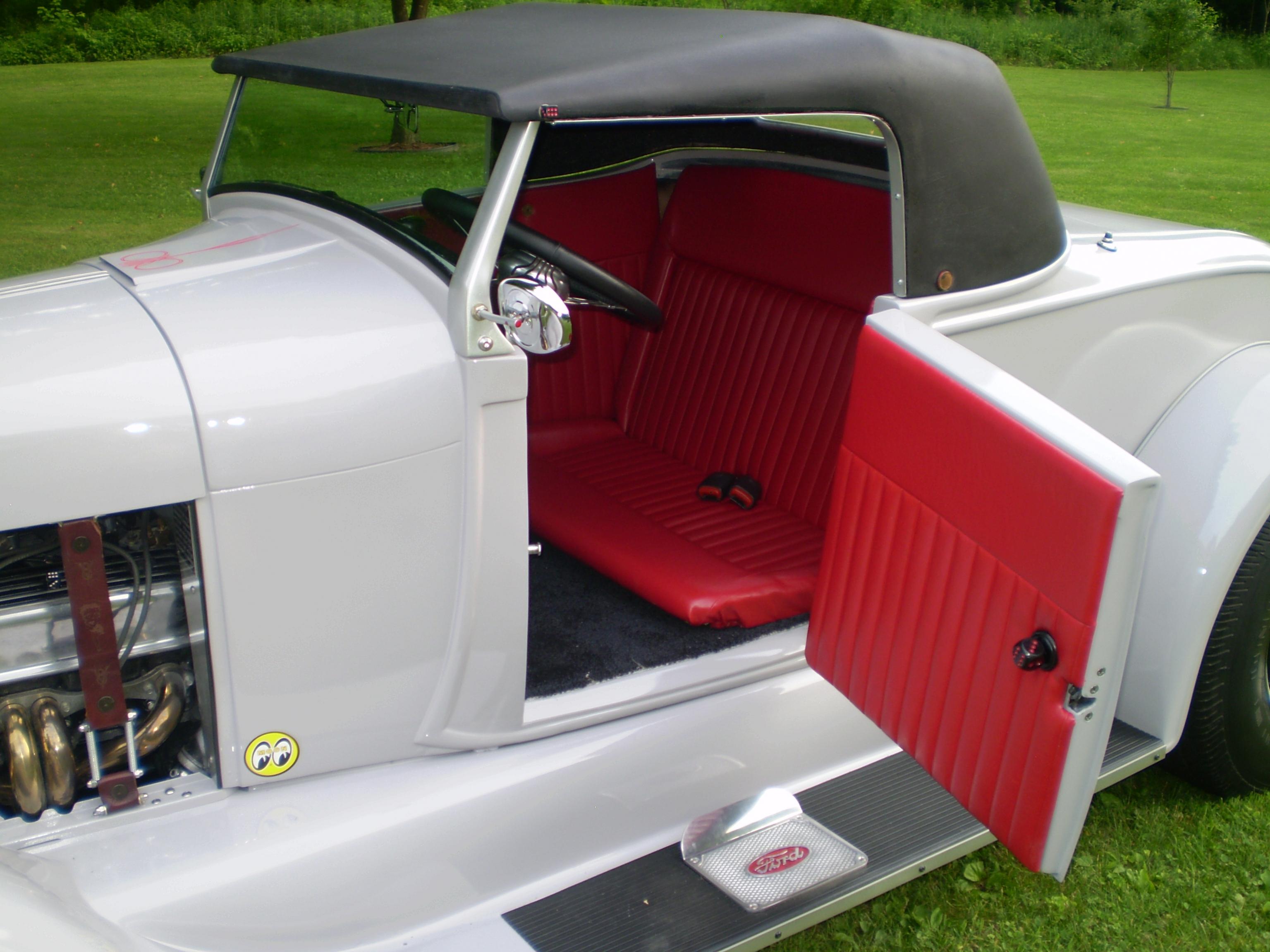

    Great work! Nice job on the interior too!
