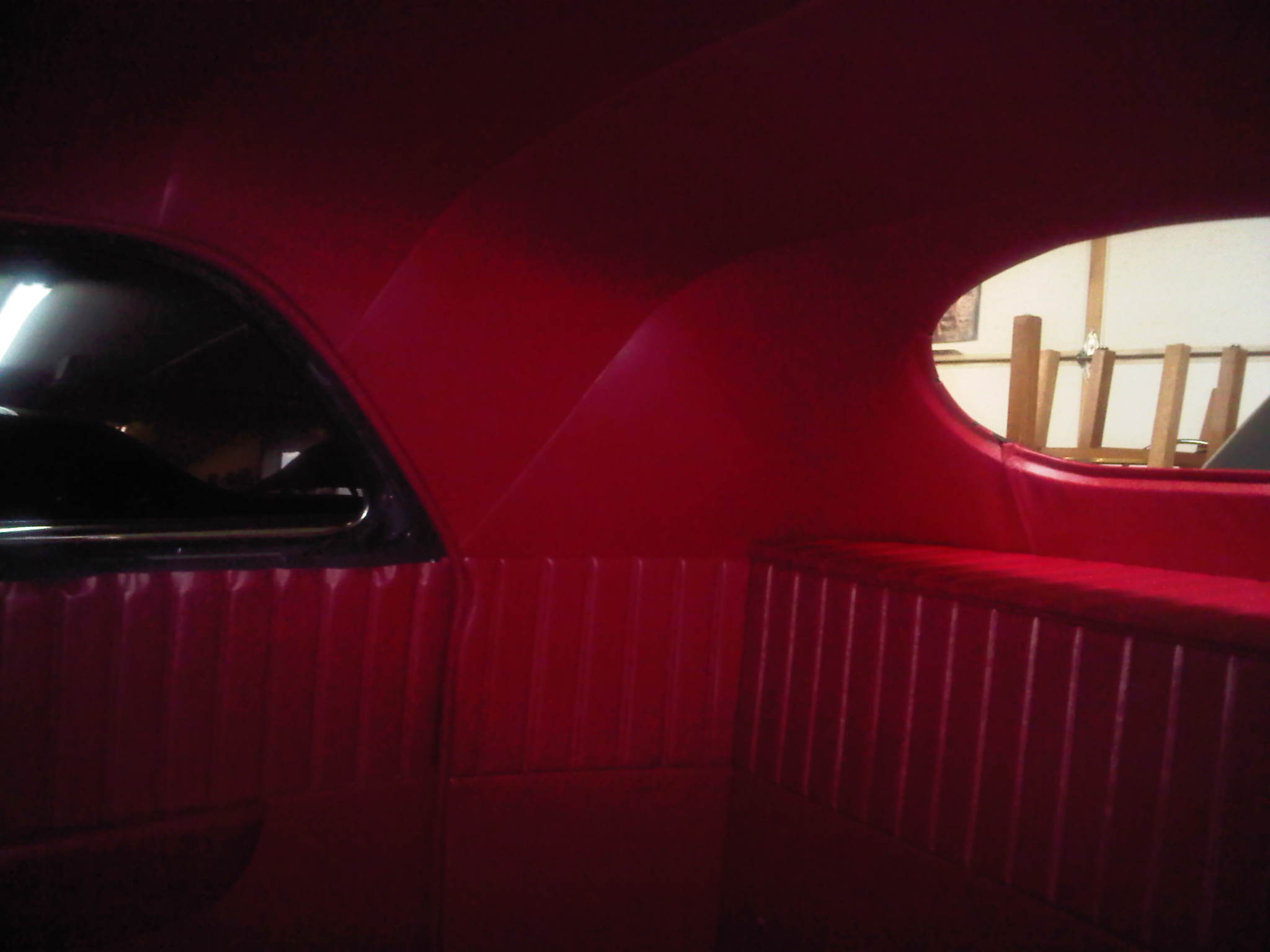

    What's wrong with the attached picture?( other than it's too dark,grin)
    Hint....the back window is missing! When the gl*** guy dropped by Ed's to remove it for the headliner to be added, he pushed in a little too hard from the outside and the gl*** sailed past the package tray and landed upside down on the ****** tunnel. CRASH. Well, it just so happens that I am planning on driving the coupe up to Loveland Friday morning for the GoodGuys weekend. Panick! Get a new window on order and ship it two day air for a last minit Thursday install. Wish me luck! smile
