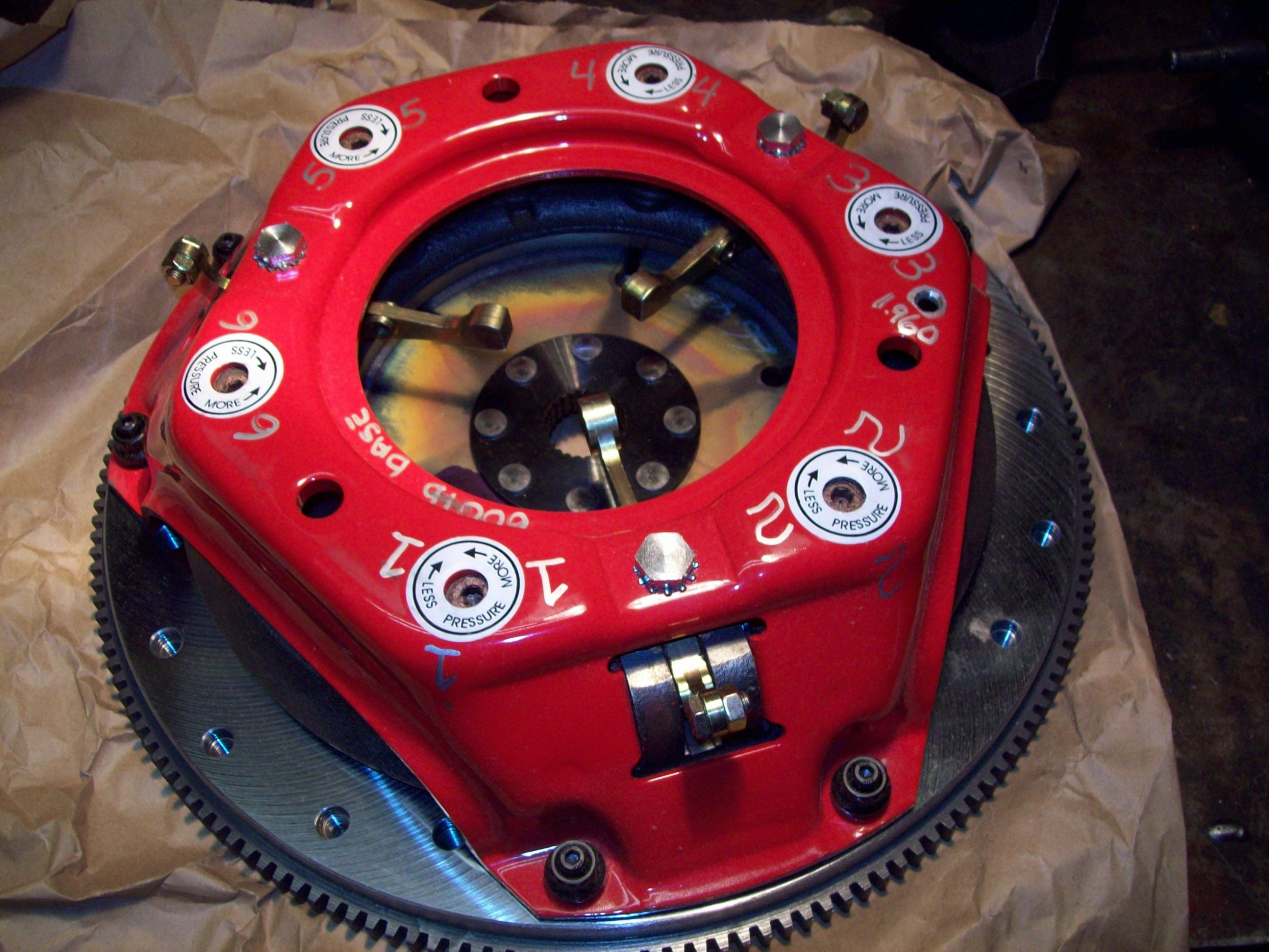

  11. I start with .065 with my Ram adj. p.p. and sintered iron disc.
