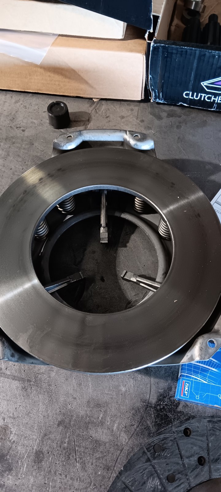

    Of the 2 clutches that I put in. I adjusted the bearing each time so it's got an eighth of an inch of play before it hits the fingers. Here is a picture of the zoom clutch that I took out last week. As you can see, it's got hotspots on 1/2 of the pressure plate. That definitely leads me to believe it's not clamping properly. 20231211_093154.jpg

    Definitely checked that for sure. I checked the pilot bushing on the input shaft before I put it into the crank. It was nice and tight compared to the old one, which was super sloppy and loose. Yesterday while pulling the car in I set the e break and I could lean under while using the clutch with my right foot and look at the drive shaft and springs and everything I could see the drive shaft banging back-and-forth as if the pressure play itself is grabbing and not grabbing. Which got me thinking that I took The flywheel to be turned at a new place. And maybe they didn't clamp it properly and the damn things not flat? My new clutch will be here tomorrow. So at the end of the day I think I'm gonna pull the trans and get this clutch out. And take the flywheel off and measure it and see what I can find. And maybe take it to the guy I usually do.

    perhaps before you remove the flywheel a dial indicator mounted to the engine block (surface that the bellhousing bolts to) and turn the engine one revolution will tell the tale??

    That's what I was thinking mark.
