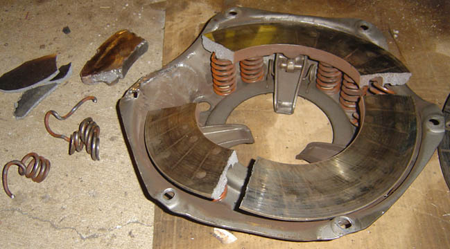

    Originally Posted by Kiwi Kev [​IMG]
    In this box are the remains of DE SOTO's pressure plate that let go in his 6x2 De Soto Hemi powered sport coupe. Happened in front of his house and shrapnel punctured the enclosed trailer sitting on his neighbors driveway! Check the second pic closely and you can see some of the damage done to the cowl. I'm hoping Rick will get on here and tell us the rest of the story.

    These pics and stories are freaking me out! I have a cast iron bellhousing. Thought is was safe, but starting to wonder.
    I did blow a clutch out of it last summer. The metal clutch housing actually tore apart into many pieces and blew all the springs and pieces out of it during a 7000 rpm 1-2 shift. One pie shaped piece of metal on one side was torn clear down to the very center splined hub. The torn pieces and fragments were kind of impressive, and I didn't mind getting the car up in the air and replacing parts, but now I am wondering what COULD happen...
    Any idea on the safety of an iron bellhousing versus a ****tershield versus a factory aluminum bellhousing as used on a 69 small block Muncie combo???
