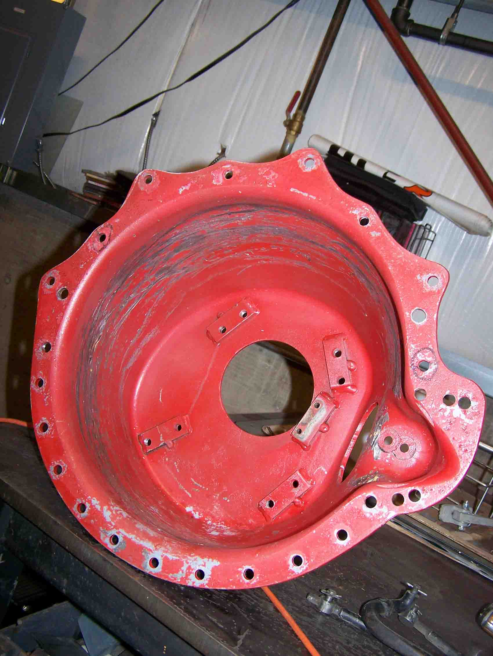

    My Box of parts:D
    What can I say it was working fine , then I thought a weekend at the drag strip was in order. Sixth pass , 6000 Side Step and Boom!
    Best money I ever spent was on that Can!!!!!!!
    No problems , but still saving pop cans to put her back together:D

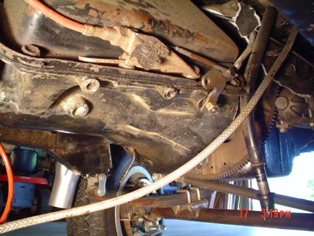

    Here's one in a parking lot. Sorry about the OT car.
