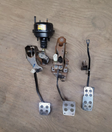

    It is a simple fix with hydraulic clutches.
    Add a clutch pedal vacuum servo/booster
    Here is a readily available example [that racers throw away]
    I'm sure some enterprising HAMBer could adapt a pushrod to one

  16. Kerrynzl
    Joined: Jun 20, 2010
    Posts: 3,601
    Kerrynzl
    Shhhhhhhhhhhhhhh! before I get sent to "Banned Camp"
    Nissan 300ZX [300Z] clutch pedal servo
