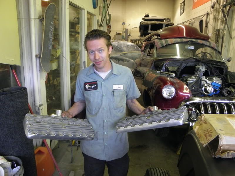

    As most of you know my offenhauser heads kicked the bucket in Calgary on the weekend, so tonight we decided to fix the problem.
    Over a year ago I acquired some NOS still in the box Edmunds heads, and it took me over a year and a half to finally decide if I should use them or not.
    In fact I even did a poll...
    http://www.jalopyjournal.com/forum/showthread.php?t=598788
    It was a damn hard decision, but I finally decided what to do with them.

    While they were taking the old heads off, I went to the back and gave them a buff with some polish to bring back that shine they had 60 years ago.

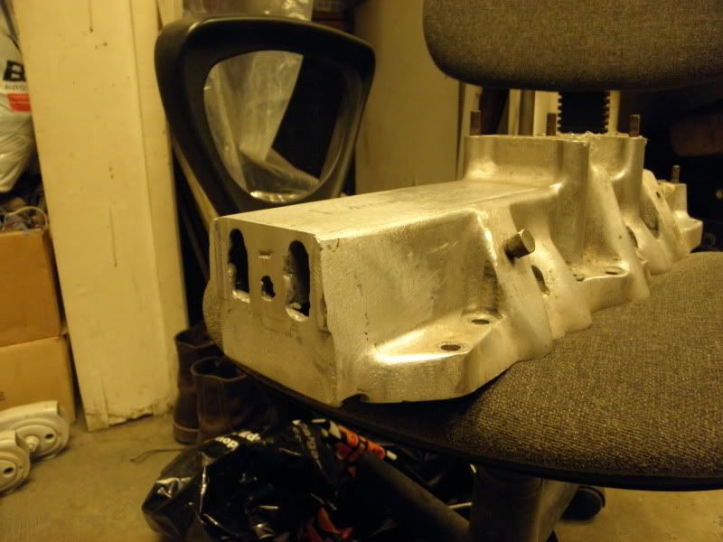

    And Dave grabbed the Edmunds intake I had hanging on the wall, and fixed up the broken generator mount.
    Checking the new heads for clearance.

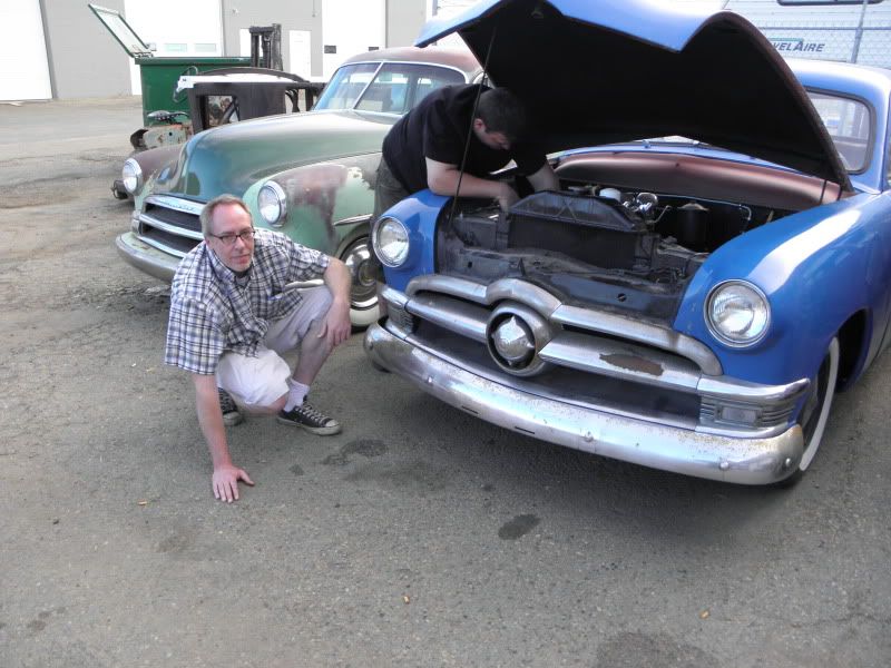

  3. Johnny taping on of the water holes for a plug.
    Greg standing around again....

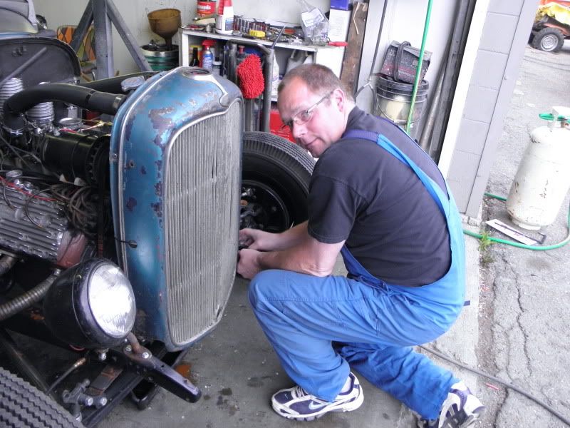

    Okay I guess Greg was just waiting for some paint to dry. Here is the headlights back together now.

    And the finished intake! Now I just have to polish it to match the heads!

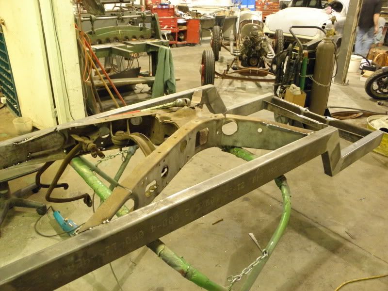

    Last time we worked on the T we were trimming the 39 ford X member to fit. Tonight's plan was to finish it off.

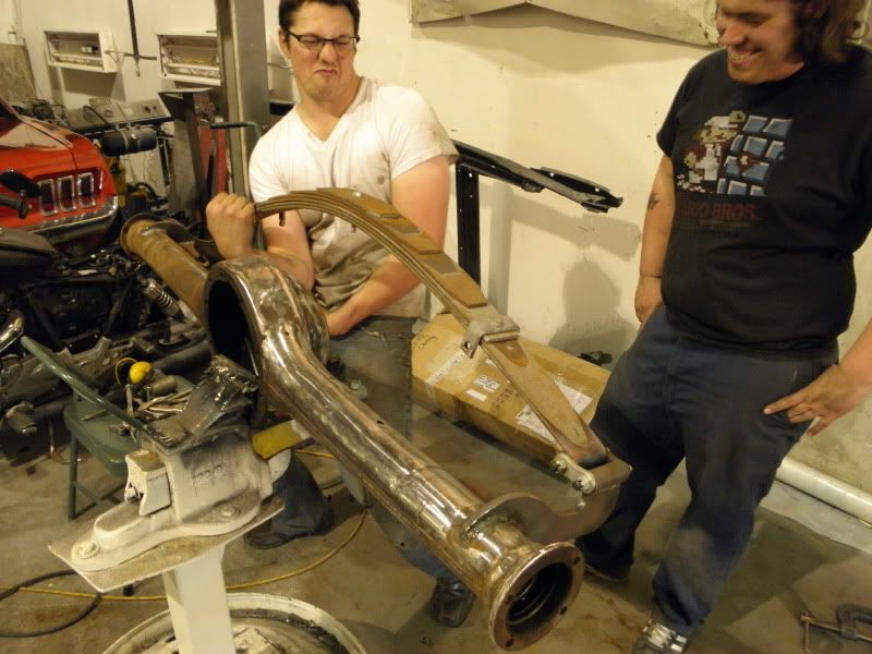

    Daves task was to finish up the rear spring mounts. So him and I went out to the shed and dig up a 39 ford spring.
    Dave taking the old bushings outs
    More X member fitting

    Once I had the X member fit and tacked in place, we flipped it over and Dave pie cut the 6" X member to fit the 4" frame rail.

    Underside of the X member. All fit and tacked, just needs final welding now

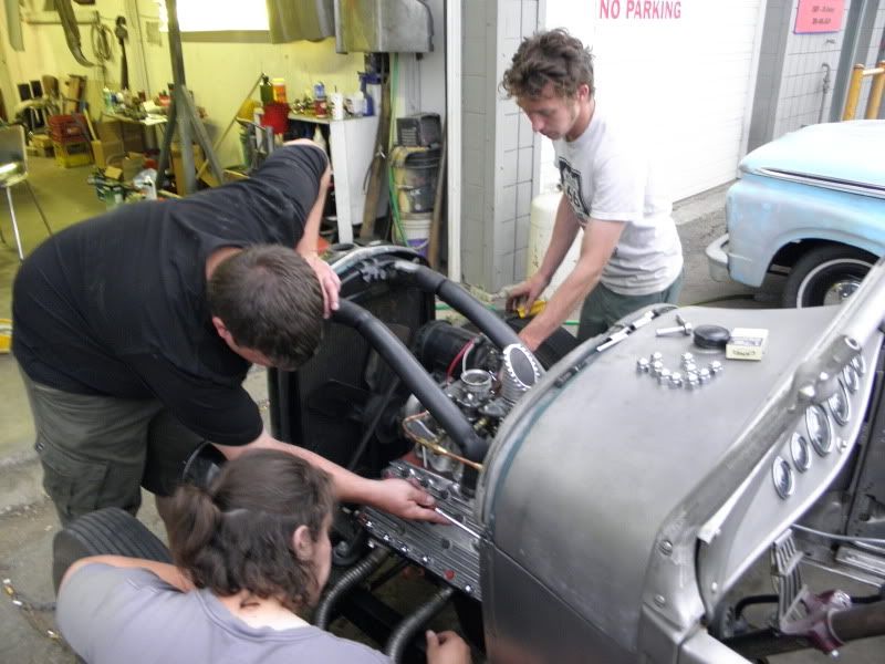

  27. Yea Wednesday night again! Tonight was my night so we worked on the roadster after a quick trip to Harveys for some burgers. Tonight was busy again as Colin, Charlie and Fat Dave joined us again.
    The roadster had started giving me ignition problems latley and burning out plugs. After some research I learned it was my stock distributor causing the problems. I guess you cannot run a stock 8ba dizzy off a vacumn port in the manifold. It needs it's vacuum from above the venturis in order to pull the correct amount of vacuum. Being my car has 97's on it, there is no vacuum port in the carbs.
    So the solution? a GMC Bubba ignition! Bubba takes chevy distributors and modifies them to fit in the ford engines, and then recurves them so they will run with the 97s. Luckily my shoebox that i don't drive had one in it, so tonight we swapped it out with the stock one in my roadster.
    Stock set up in the roadster.
    Bubba ignition in the shoebox
    While the three of them worked on getting the Bubba out of the shoebox, I pulled the stock on out of the roadster.
    Here I am ranting about how much parts guys piss me off. Fat Dave and I had to make a run to try and get some new plugs, and unfortunately we came back to the shop empty handed.
    While I was putting the new dizzy in, Fat Dave and Colin re torqued the heads
    And done!
    I have to say, this dizzy made a HUGE improvement!!! I'm very happy with it!

    He grabbed the Edmunds intake and went to the back of the shop to clean it up a little more.
    Still not finished yet, but it's coming along nice!! Thanks Dave!

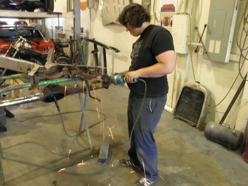

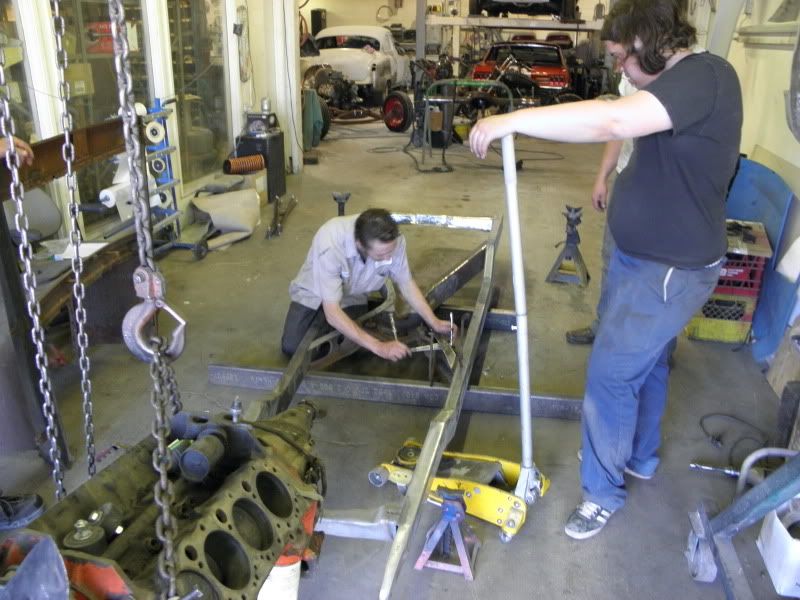

    While Charlie and Johnny were doing engine stuff, Dave Colin and I picked up on the X member and rear end fitting.
    Dave made a fish! How nice!
    Putting the ladder bars together
    For some reason there is a shortage of new 35-40 ford rear u bolts in town, so I found a set of used ones in the shed, but I didn't have the lower plate that actually holds the spring in. So Dave made a new set.
    Here is the mock up of the ladder bars. The X member had to be notched. It will be boxed for strength once everything is fitting nice.
    Here is the template for the ladder bar mounts of off the X member.
