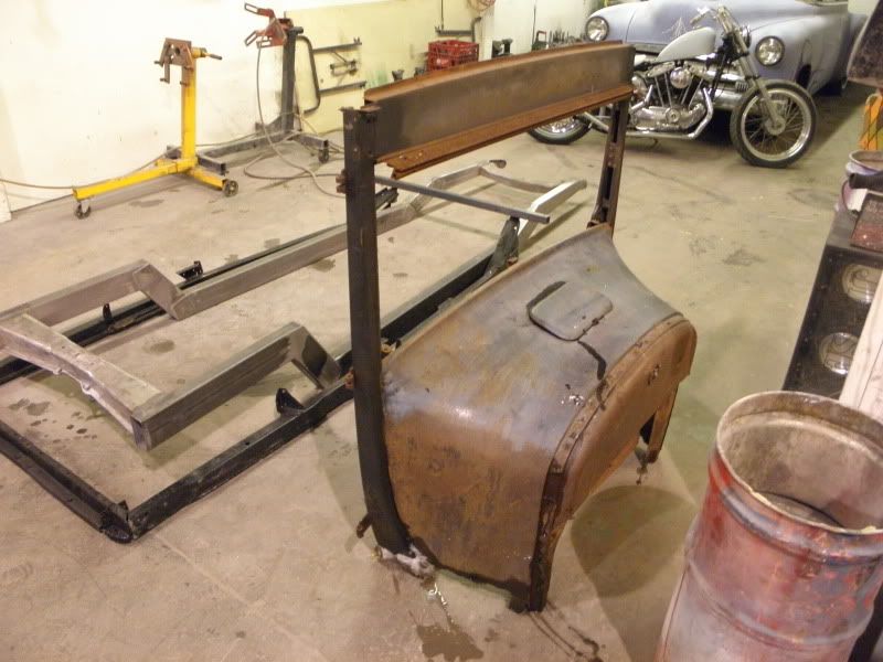

    Back at the shop Dave and Johnny got started on fitting the sub frame. On Sunday Johnny cut all the cross members out of the sub frame for the channel. 5" in the front and 4" in the back.
    Just a few hours ago this was under 4 feet of snow!
    They then built some pieces to mount the cross members 4" further up. And Matt Hotte showed up for a while to help out. Thanks Matt!
    And there it is, not quite finished yet still some welding to go and some gussets.
    While they were doing that, I got started on some motor mounts!

    Cool build on the T, you should look into removing that windshield header, in my opinion that tall header looks like poop on T's, especially when chopped. Check out "BAD NEWS" , it was removed and looks cool.
  11. 0rg0
    Joined: Feb 1, 2009
    Posts: 210
    0rg0
    Stay tuned. We have a plan.
