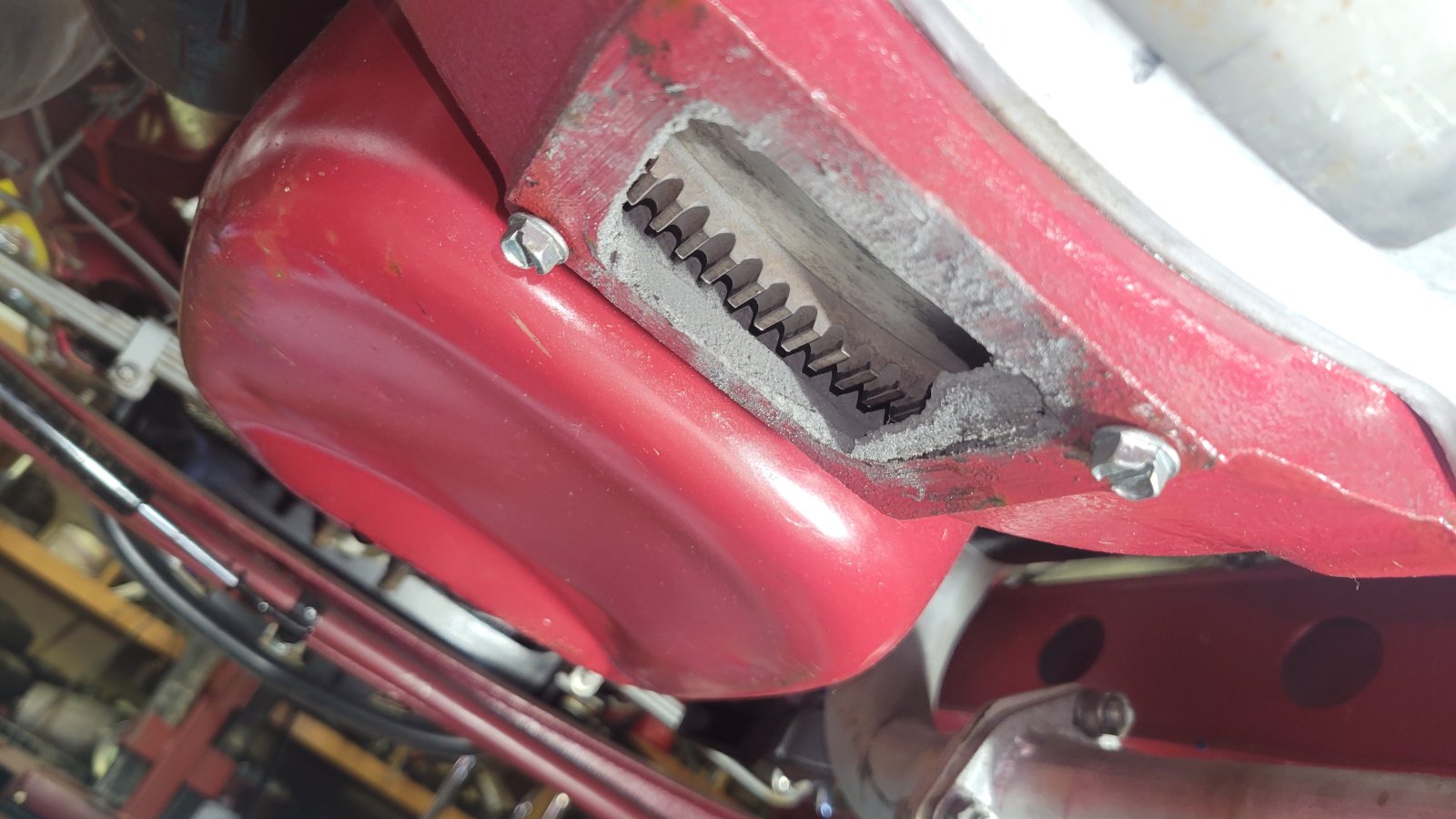

    With less than 300 miles on a fresh build, my clutch started slipping (early Olds w/T-85). It worked just fine the first 200-300 miles and then started slipping. No smell of burning. When pulled both inspection plates I found a build-up of what appears to be "graphite". Now I don't know what material clutches are made of today....graphite would not be my choice as it is a "lubricant".
    Does anyone have an idea what this is....it has to be from the clutch...HELP.

    Looks like metal to me. You’re going to have to pull it.

    Looks like metal to metal contact somewhere. Cast iron dust or sinter material. Seems to be too early for a clutch failure so maybe a clearance issue elsewhere in the release mechanism.
    Does it stick to a magnet?
    Looks like it has to come out in any case

  5. Look like metal dust .
    clutch fingers disintegrating, throw out bearing , or pilot bushing disintegrating would be my first guesses without pulling it apart .
    clutch material is usually “ hairy “ with clutch fibres .
    either way your pulling it apart to look closer .
    how much grease did you put on the input shaft ?
    Trans input seal leaking onto the clutch causing contamination?
    SS327 likes this.

    What type of clutch is it? If it's a Long style with counter-weights they could be rubbing on the aluminum adapter.

    Good question...I checked....it doesn't. Pretty sure it's graphite. I found out they DO use it in clutches. Either way, I'll find out when I tear it apart.

    My last discs were Kevlar and show very little wear.

    Uncured or a badly cured product? Just a WAG.
