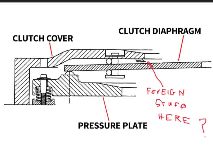

    Its a wild shot but this is what happened on mine when gravel got in it. Foreign material between the diaphragm and the cover not letting the diaphragam go all the way back. It was pretty obvious on mine because several of the fingers on the diaphragm were not at the same height when I shined a light up in.
    I'm still more inlined to believe that there is something that just flat *** does not jive in that pressure plate. Possibly the wrong diaphragm inside it. Normally it is a case of Won't release like Billy had rather than won't hook up.
