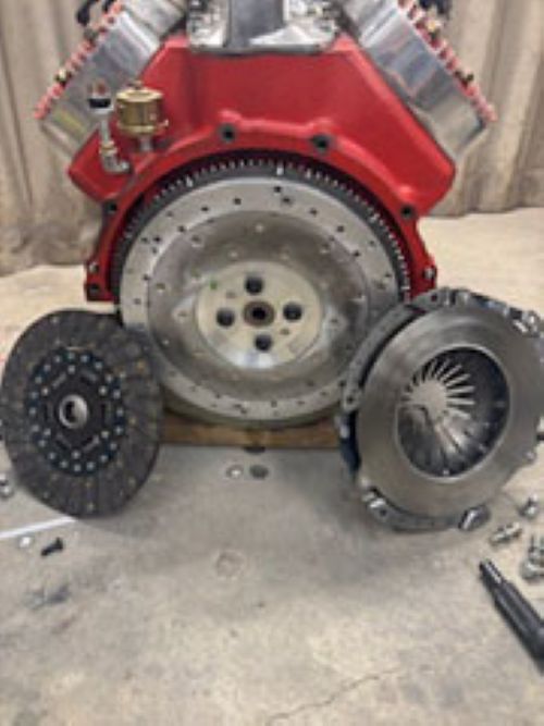

    It look like there is an undercut area to where the flywheel bolts are. Does the clutch disc metal part fit in that undercut? It's hard to tell from this picture if the flywheel side of the clutch disc is completely flat. Could the metal part be touching the flywheel?

    I could have posted a bigger size but I was concerned about using up bandwidth. Is that still an issue?

    No not an issue, by all means post some good pics of the parts , maybe someone will notice something

    It's hard to see in the pic but yes it is recessed for the bolts. The disc fits flat against the friction surface of the flywheel only. IMG_0111.jpg

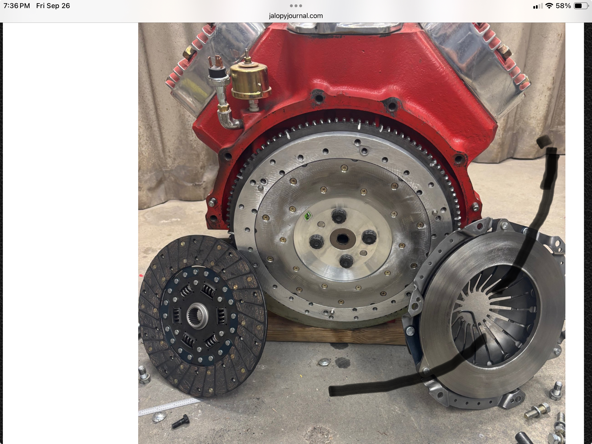

    IMG_7065.jpeg Please check between the fingers of the diaphragm pressure plate for interference.
    If its bolted down and compressed, is it possible that the fingers are touching each other .
    I’ve had this only one time in my life , a bb chevy 427 fuel injected direct drive altered . Drove us bat crazy .

    Appears to be OK. The mark on the disc was to check if the center hub was spinning. It is not.

    It may be optical illusions but why does the steel surface on the flywheel look lower than the aluminum around it and why does the surfact of the clutch disk look worn to the rivet heads? Screenshot (1112).png

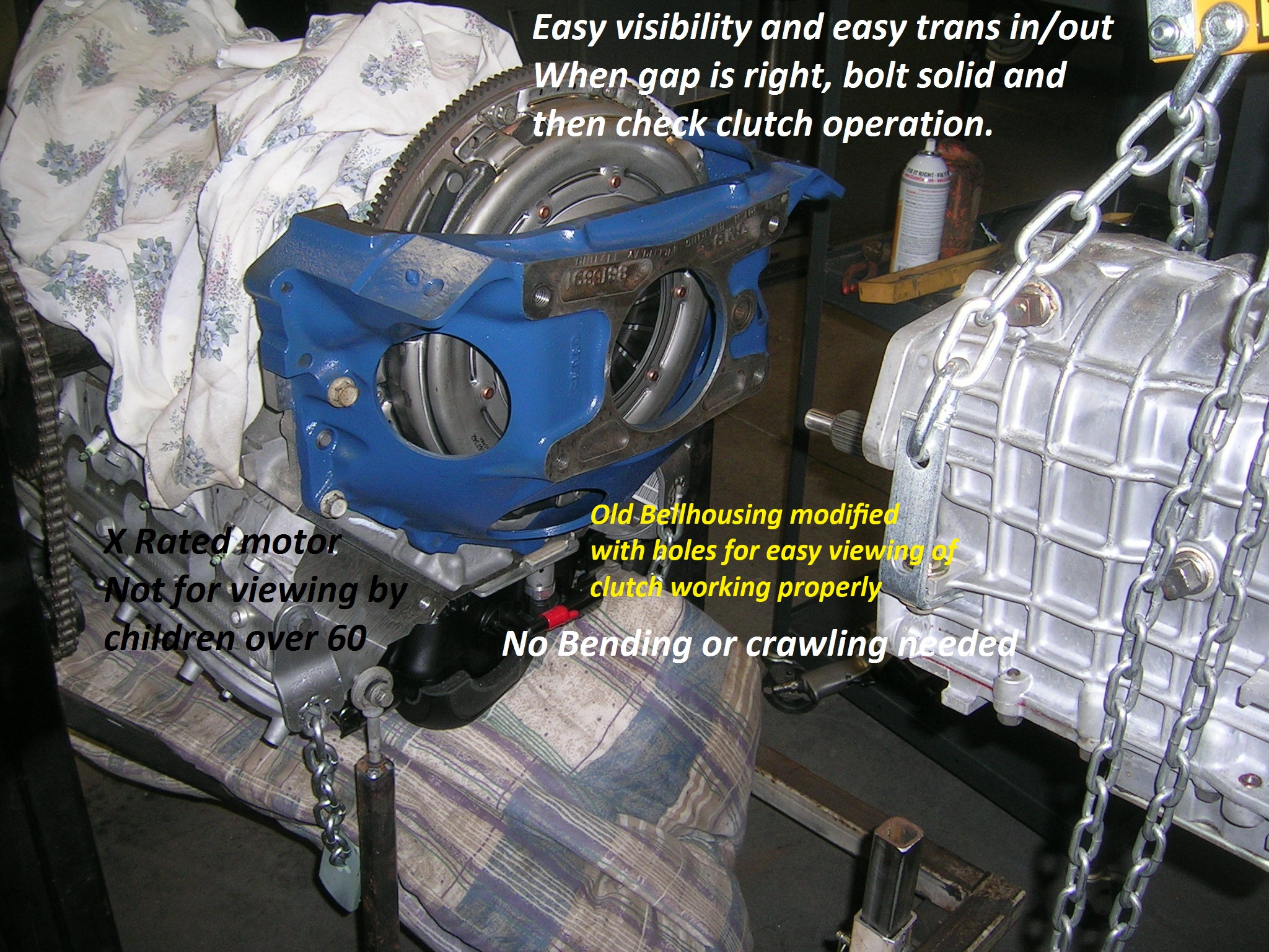

    Since it looks like everything is out, how about you bolt that flywheel to the floor or to a big piece of plywood or something to hold it stationary. Install the clutch as you would in the car and see if you can turn the disc.
