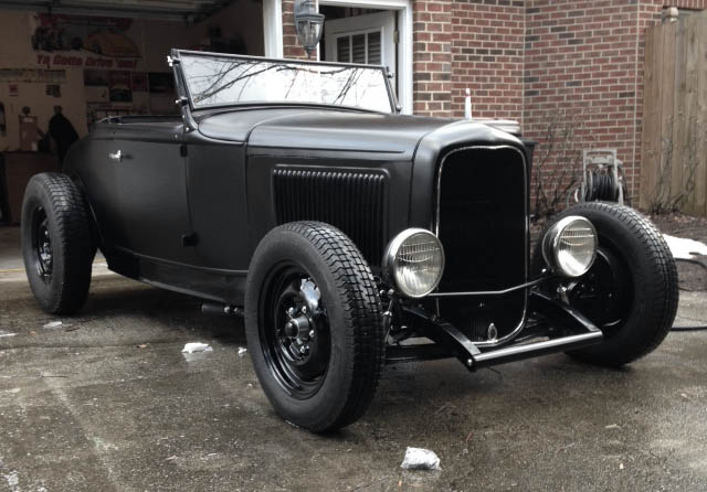

    I've been wanting to change the headlight location ever since I got this car on the road. I have the pete and jakes headlight/shock mount welded to the frame. I just thought they were too far apart, too high and not forward enough. I think I found the solution... I used a model A headlight bar (ends cut off and V'ed in the center to follow the grill shape) and basically welded it to the top shock bolts. I still need to clean up the welds etc but this gives you an idea of what I did. I will also need to cut the old headlight mount off.
    kidcampbell71 and 1-SHOT like this.

    That looks incredibly better!

    Thanks! I have a few more things that I am going to change. I was in a rush to get this thing on the road last year.... Now that it's too cold to drive it, it's easier to take things apart. Next is the exhaust.
