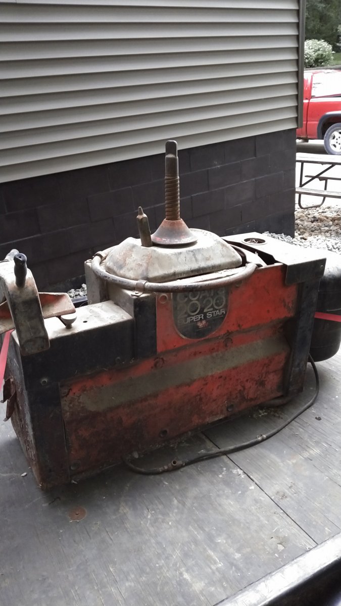

    I just bought a coats 20/20 tire machine and while it works fine I have a couple of questions that the previous owner could not answer.
    There is a separate air tank linked to a "ring" that is underneath the tire as it is laying on the changer. The ring has a bunch of small holes and is linked through a pedal. Perhaps a inflator to set the bottom bead? This has never worked for the previous owner and I am unable to find any references to it.
    I'm wondering if it was an option?
    In addition the parts list references a quart of "special hyd oil". Any ideas where this goes?
    The photos aren't the best as I only have a backside view before I started tearing it down for freshening but hopefully someone has some experience. KIMG0229.JPG KIMG0230.JPG
    Thanks

    I think that helps seat the bead on tubeless tires....

    I had one years ago and I thought the air tank in the top picture was the one that ran the inflator. I cant remember witch of the two pedals worked it.

    ^^^^^^^That is exactly what it is for. It should have been hooked up from the factory as they all have it and it is not a separate option. There could have been something disconnected by the PO but it is considered necessary especially when mounting skinny tires on wide rims ot the tires have been stacked for a period of time taking a "smashed" set to them.

    The ring gives a blast of air as you're trying to get air into the tire. It will spread the tire sides out. The pedal actually has a secondary step, you must step briskly and fully to the floor onto the air filling the tire pedal. If you're not aware there is the secondary step of the pedal, it won't actuate the bead expanding ring. Once the bead is up and the tire is airing up, let your foot back up to just the filling the tire operation. The ring will continue blasting air as long as you hold it to the floor. It blasts a LOT of air, and drains the tank quickly. Make sure you have the valve stem core out of the stem so air can go into the tire quickly. Once you have the beads seated, put your finger over the stem and reinstall the core.

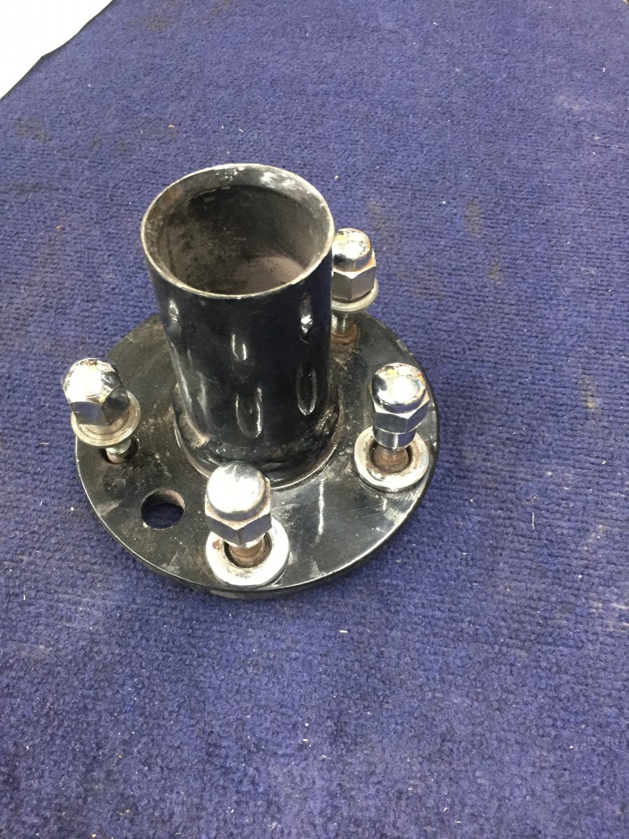

    I have a Coates 40 40 which is a little newer version of yours. I had changed hundreds of Cragars over the years with no problems. I even used to joke with my buddies asking if they wanted to buy the mag wheel insurance before I worked on their wheels. Then it happened on a wheel of my own. A new old stock 15 x 10.... I broke the center cap area out of it... I was sick. Then I made this adapter, it is a front hub from a 65 cutl***, I machined the center out of it and welded a pipe in its place that fits thru and above the wheel. I machined a bevel in the top for the large cone nut on the tire machine to go against. Now with the adapter bolted to the wheel there is no chance of breaking a wheel

    I like the looks of that adapter. I just bought a Coats Model 3 and am in the process of reworking it. It's pretty much the same design as the 20/20 but without the tin work surrounding it. On mine the cylinder was stuck, the guy I got it from had dis***embled it already, it had some rust and pitting in it. I wirebrushed it then ran my cylinder hone through it, turned out pretty good. Might make up an adapter like that for Ford wheels which will be mostly what I'll be dealing with.

    My 2 cents on it, it is the pedal that inflates the tires that actuates the lower ring.
    The pedal has two stages, step on it lightly and it airs up the tire .... stomp on it all the way down and it activates the lower ring along with the air hose connected to the valve stem.
    My first guess to fix it would be the pedal is gummed up and not functioning properly.
    I would buy a gallon of WD40 and while it is a pita .... add it in through the air line.
    Last time I cleaned out a coats 40/40 I used more then a quart, less then a 1/2 gallon.
    I had to remove the air fitting from the end of the hose, used a small funnel to fit the hose and added small amounts a few times then put it back together and ran it.
    I repeated the steps several times until I had used more then a quart of WD40 .... By this time the machine was working like brand new again.
    Remember that WD40 is a great cleaner, it is not a lubricant. It will clean out the insides of that pedal without taking it apart. ...... If this fixes the problem, then I would add the oil in through the air hose using same method.
    If it does not fix it, then I would look into removing the pedal and open it up to see whats going on.

  26. cat_bruce
    Joined: Oct 24, 2023
    Posts: 3
    cat_bruce
    Hi ERguitar, any chance of taking some pictures of where the hoses connect underneath?

    I think you should be able to figure it out with supplying air to the valve. Then use an air chuck to the rams. Then if as mentioned you have the “ring “ it should have a valve to release air via the valve.
    Ofcourse a diagram would be easier, but some figuring and taking notes as you go will work as well.

    @cat_bruce here ya go!

    Hey cat I posted some pics , if you need anything else let me know. I'd be interested to know if anyone has any success using the inflator ring. It doesn't seem to make much difference and actually may make it more difficult to seat a bead as it bleeds off some of the available air. Is there a trick? I seem to have my best luck working around the tire and hammering the bottom bead down with the spatula before inflating to seat the top bead.
