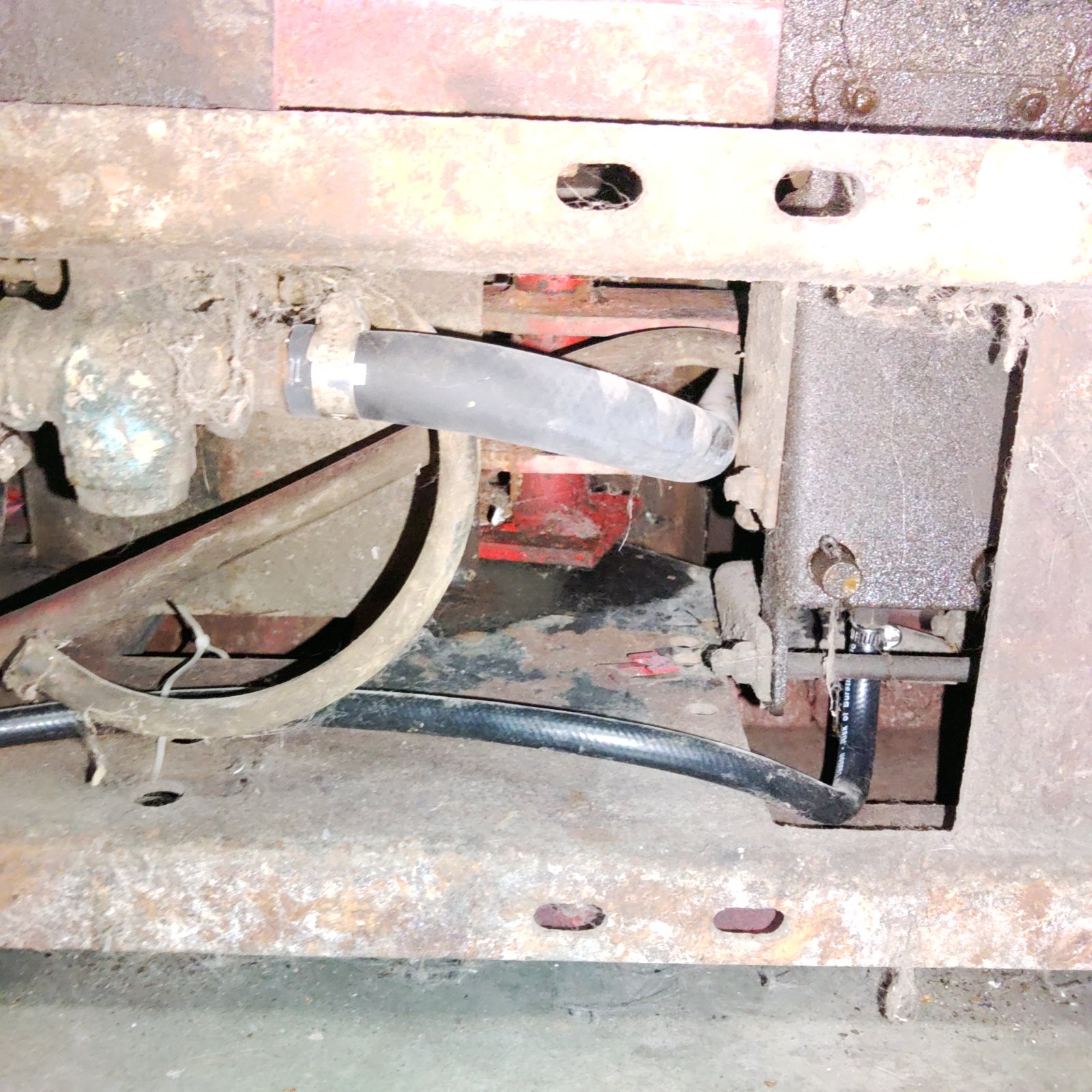

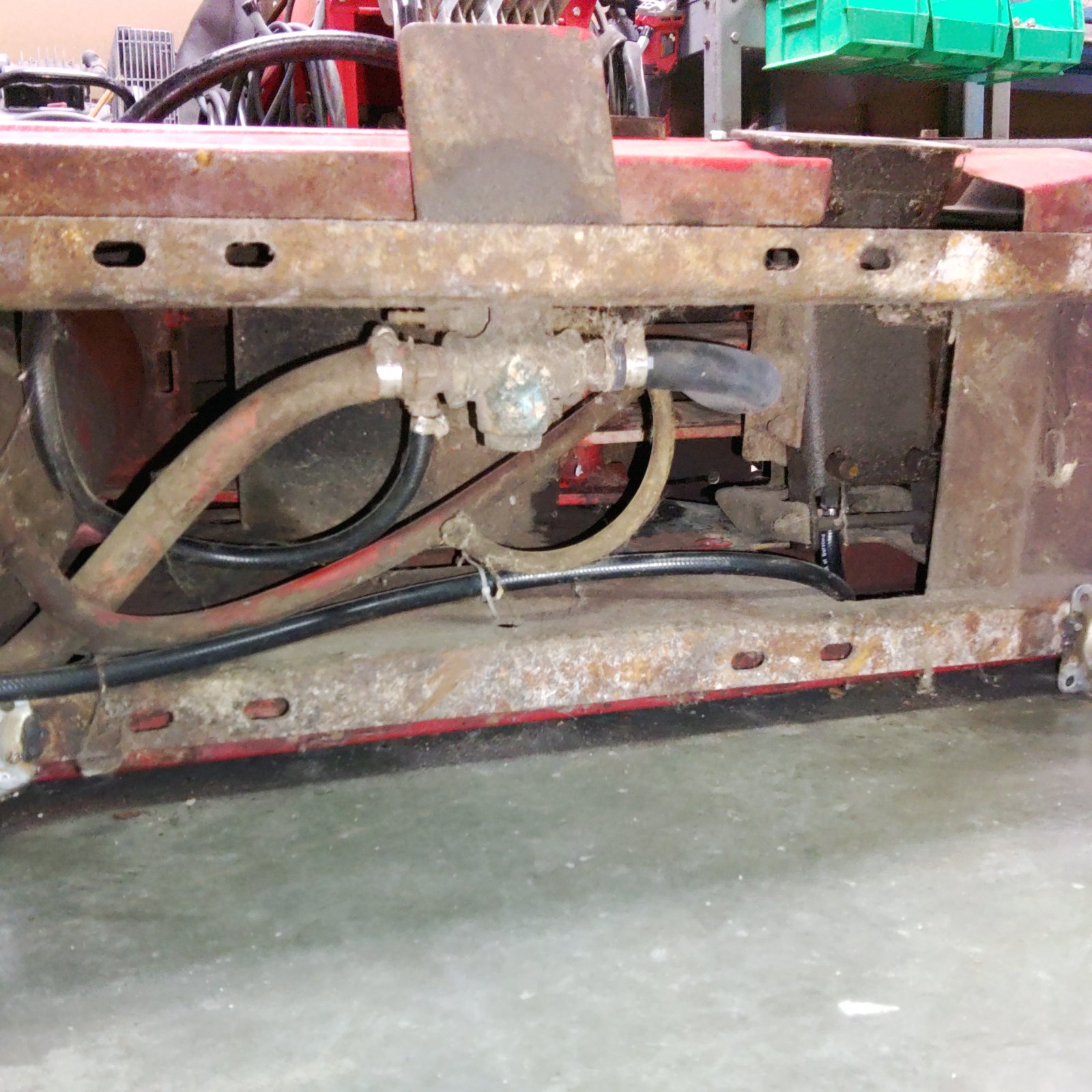

    The black end tank fills with air .The lower bottom peddle operates tire inflator hose at 1/2 press .full press empties tank into inflator ring for filling tire to make a bead seal. Right hand peddle operates the tire bead braker rams and center pole spinner motor for mounting and dismounting bar tool . There is parts schematics on line and manuels .you can also contact COATS number is on line also .
