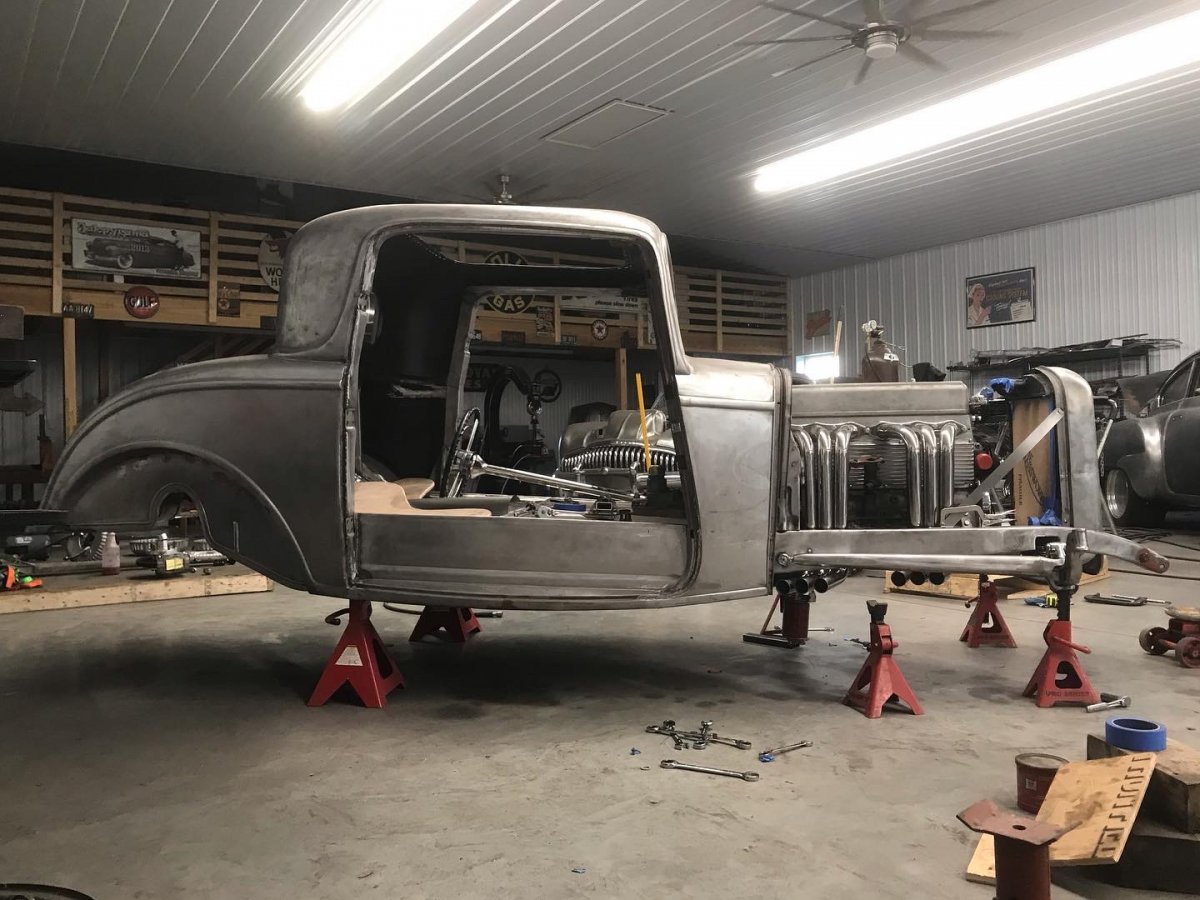

    Cody, how do you prevent surface rust on your bare metal during the build?:confused:
    Gibbs? Something else?
    BEAUTIFUL build- and photography- btw.:cool:
  27. Cody Walls
    Joined: Nov 14, 2008
    Posts: 1,574
    Cody Walls
    Climate controlled shop , and I try not to touch the metal with bare fingers ,
    the oils and acids from ones hands can make things rust .
    I don’t put anything on it because it’s such a pain to get off when it comes to paint
