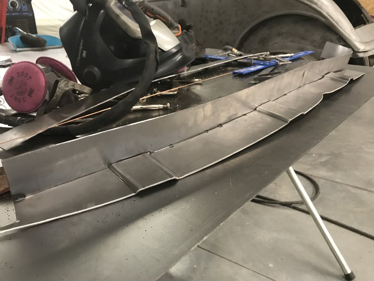

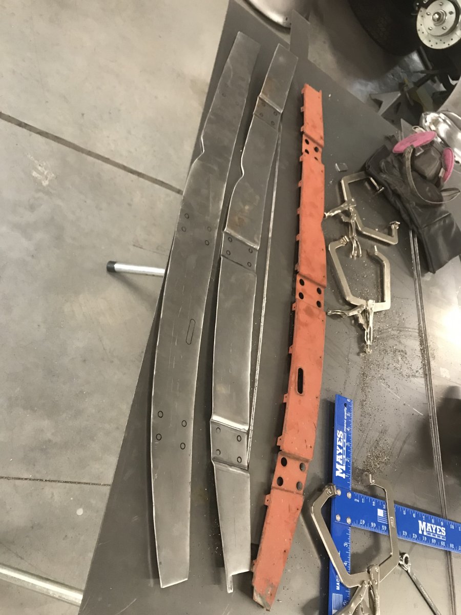

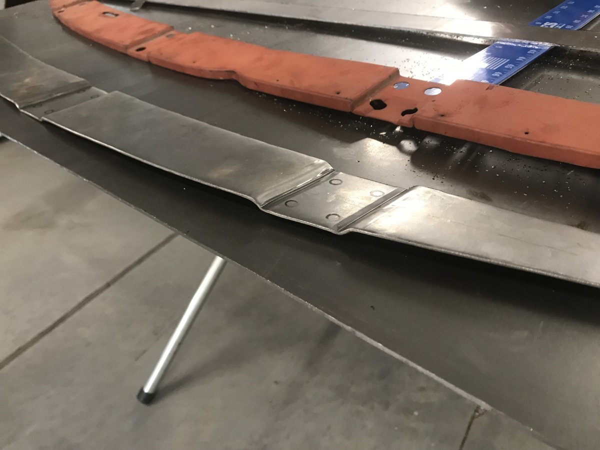

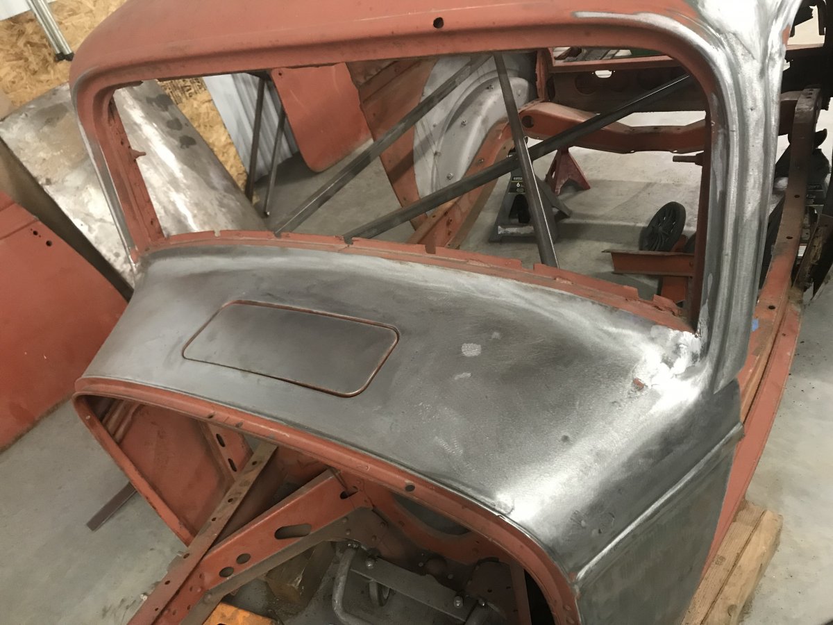

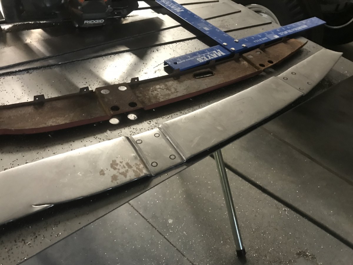

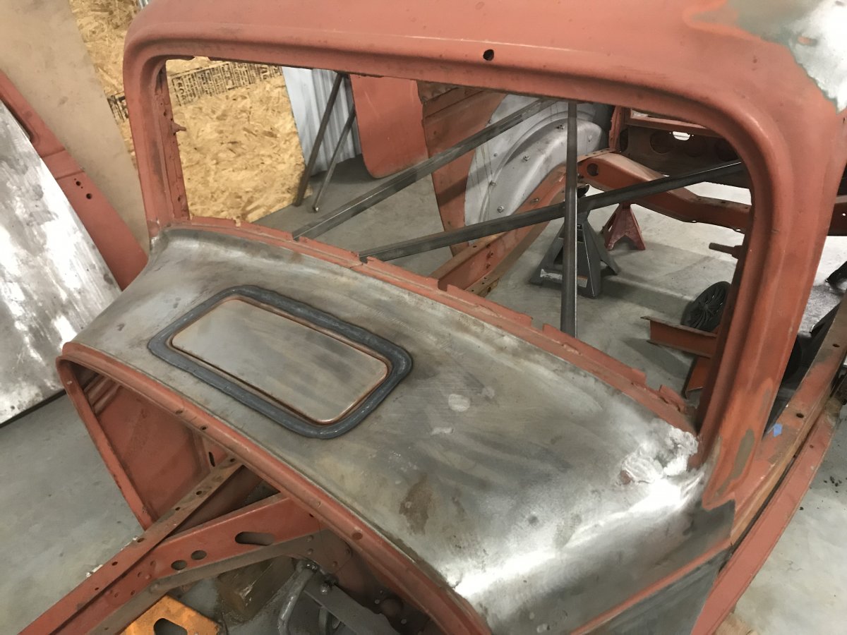

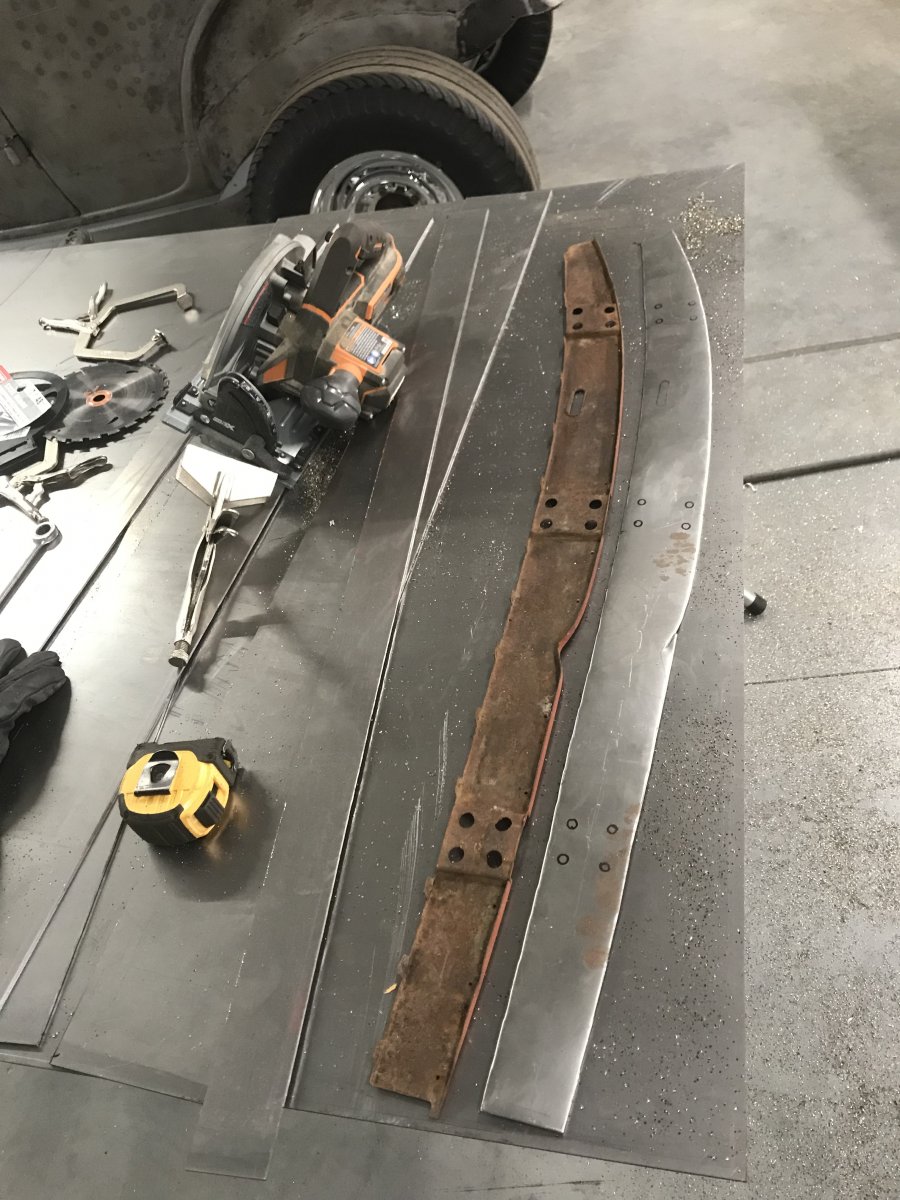

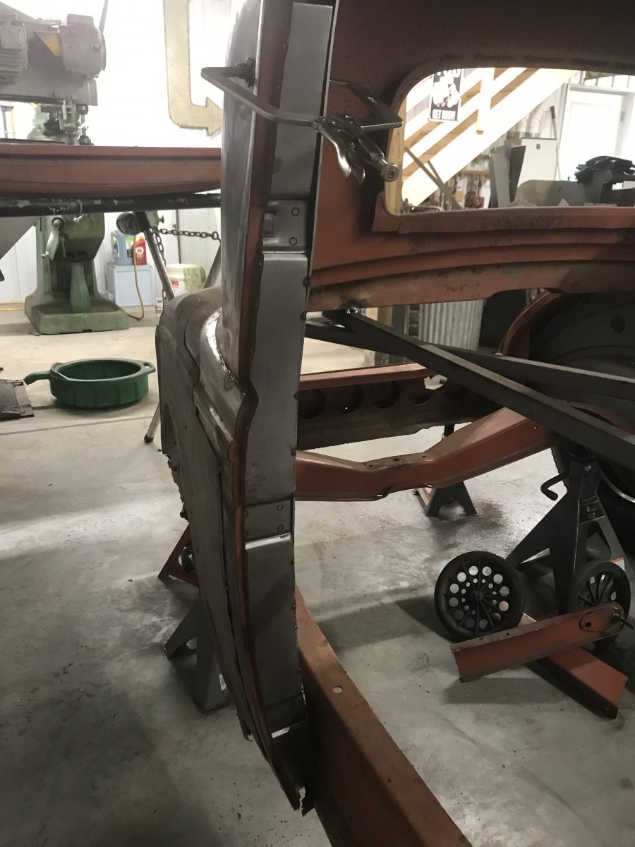

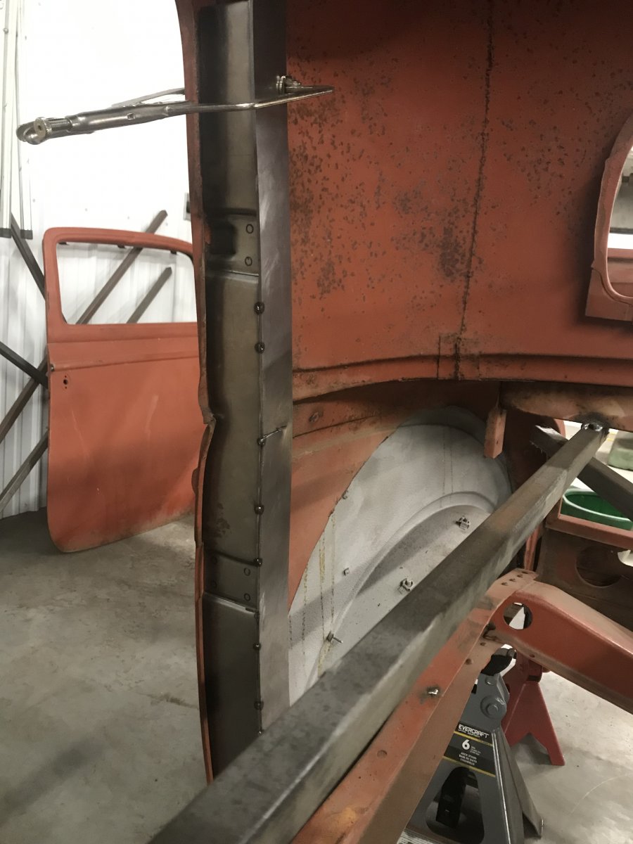

    A little bit of progress on the coupe this evening after work . Welded in and metal finished the cowl vent, and started making the new B piller structure out of 1/8 Steel when I’m done it will be a complete box channel structure . I never see the point of putting a wood inner structure back in a car that originally had it . especially going threw all this work why take the chance of your doors and body not lining up later on down the road after driving the car .

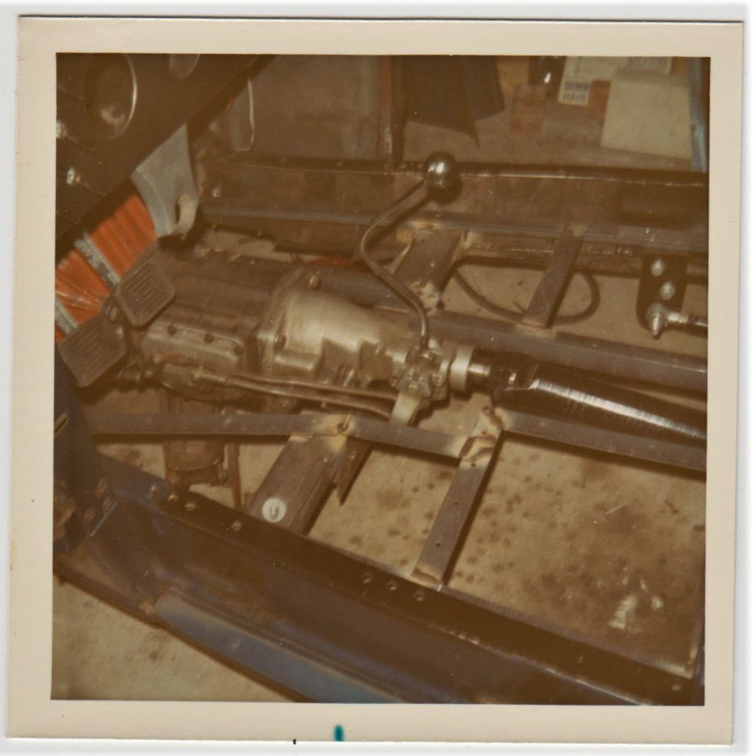

    Looking good. Back in the 60's I did a chopped & channeled five window and dropped the floor halfway down in the frame. It gave me so much room for a comfortable seat. With out a chopped top it may not be necessary. Will be watching this sure to be a nice Hot Rod.:cool:

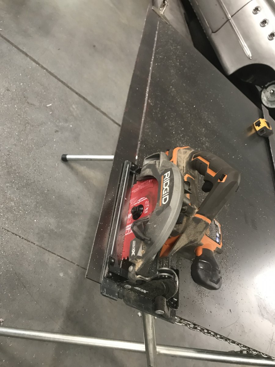

    Aha! Somebody else uses a cordless skilsaw to cut metal! Fresh blades are a must!

    When we cut tin for barn roofing an old timer told us to put the blade in the saw backwards. It worked like a charm.

    I’ve heard that too for tin work .
    I’m cutting 1/8 with this . I used a
    Demon Cermet II Carbide Blade for Ferrous Metals & Stainless Steel for this .
